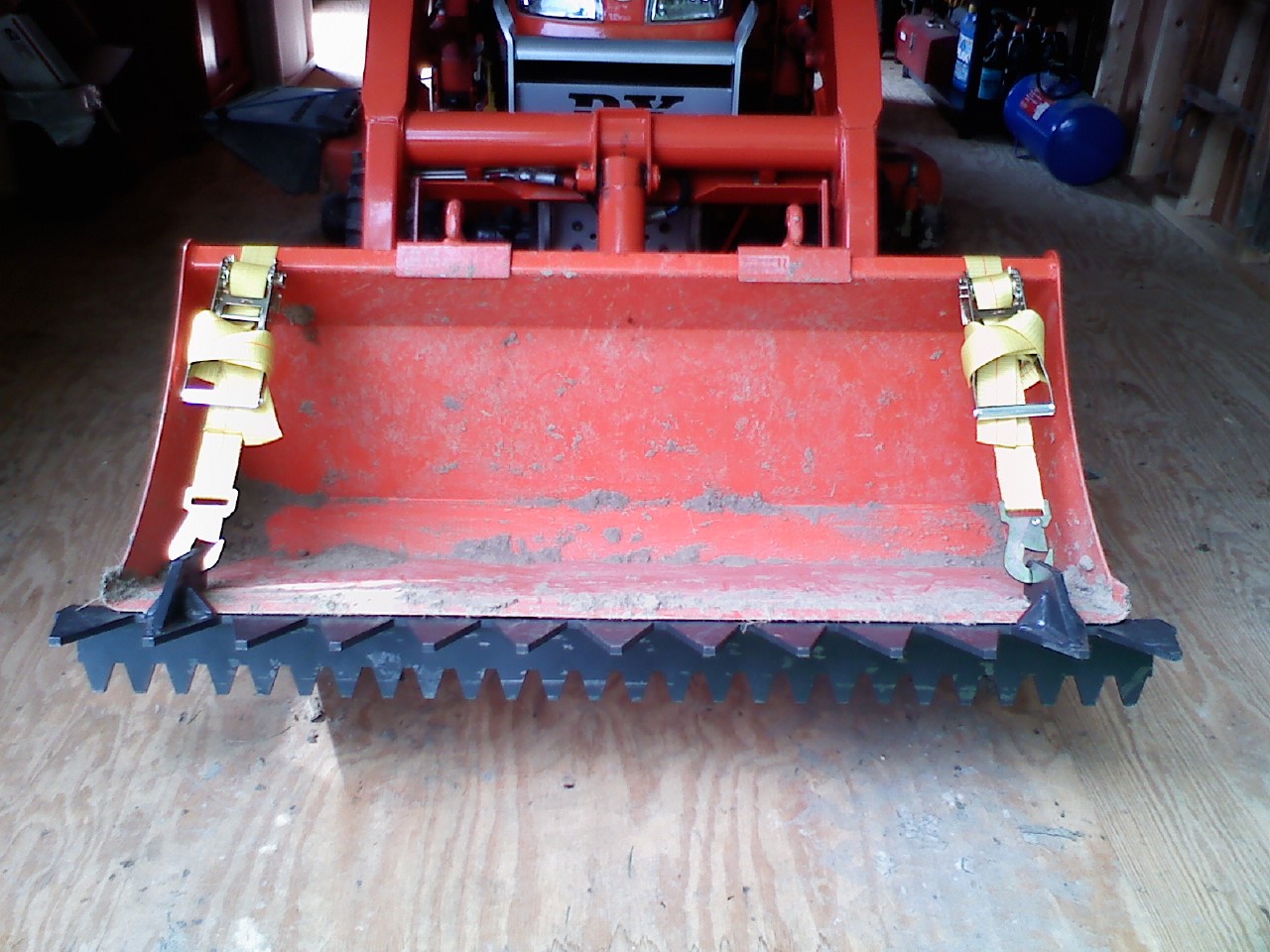

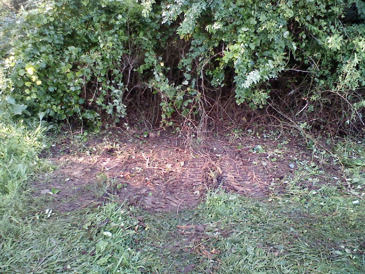

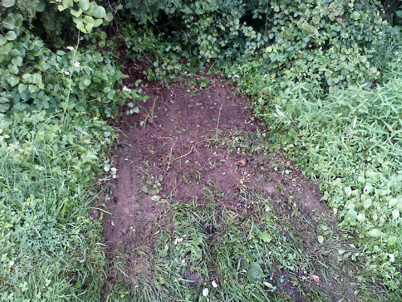

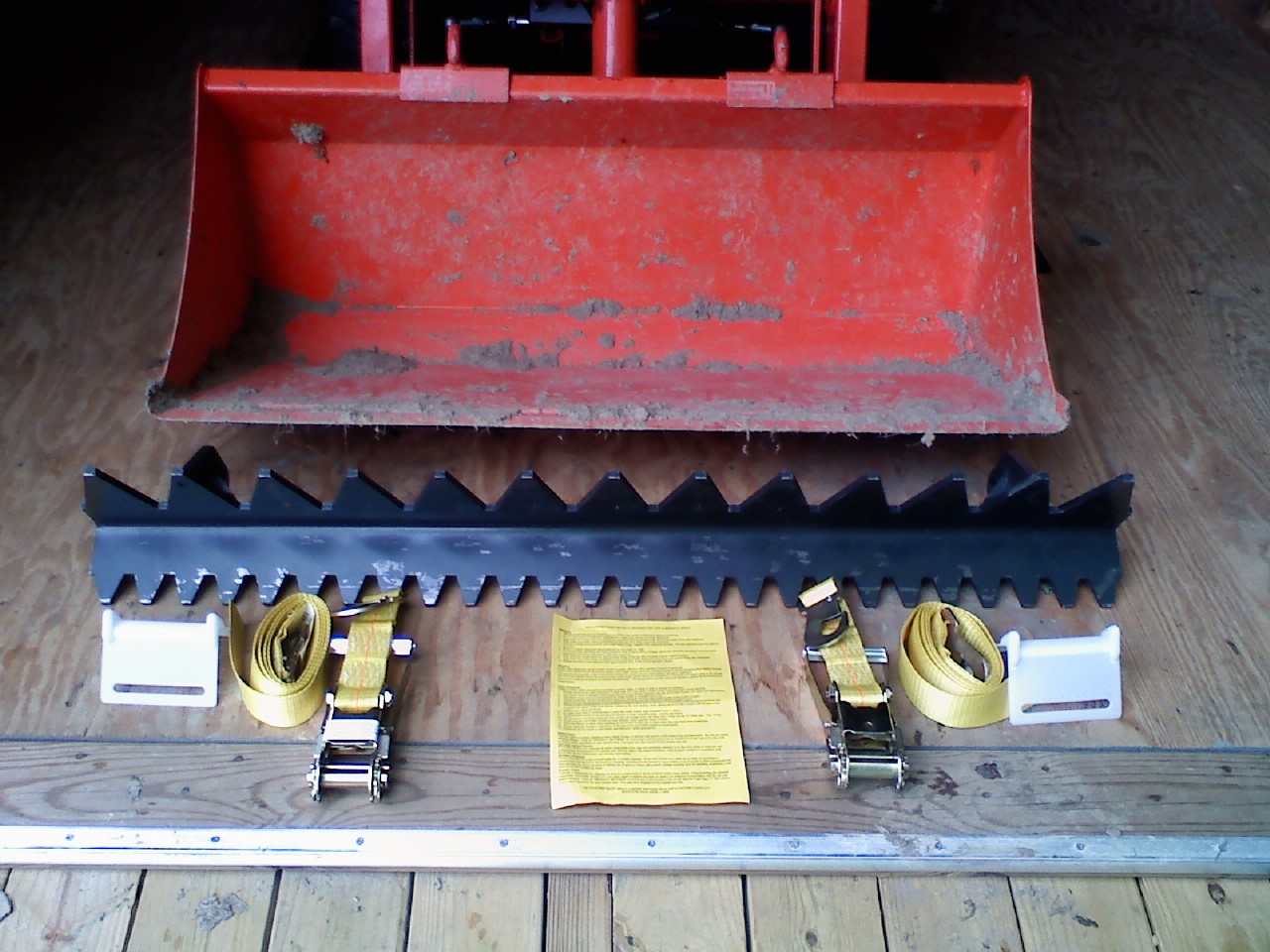

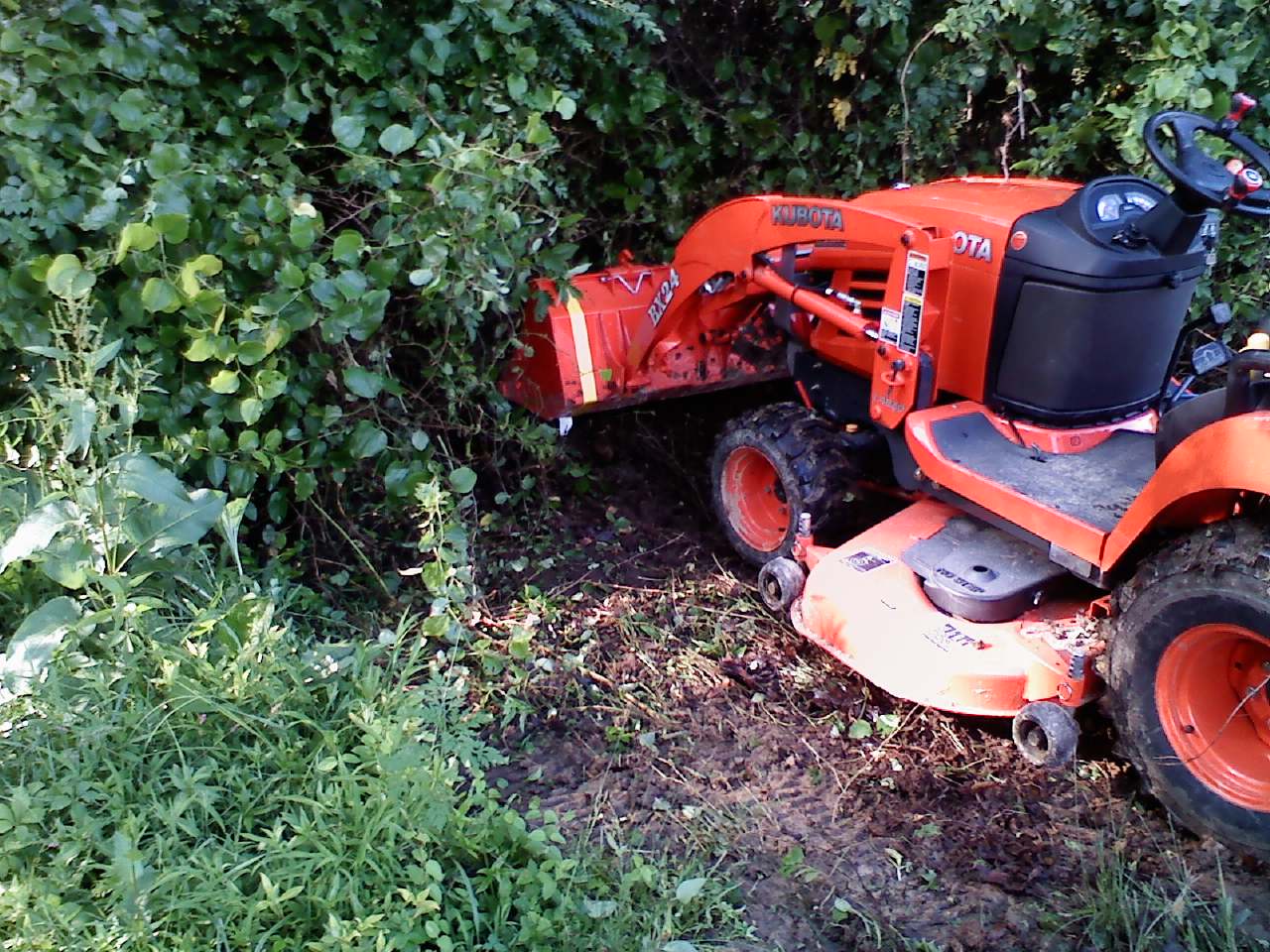

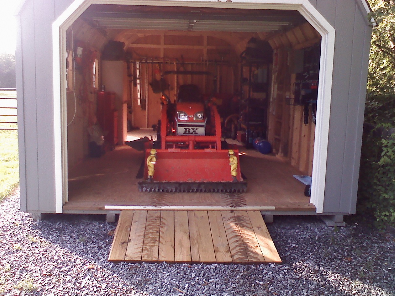

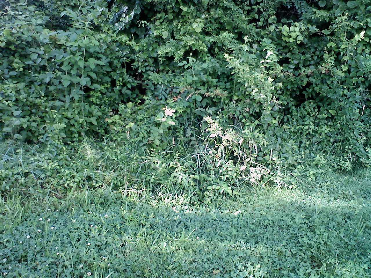

I was finally able to test out the new rachet rake for a few minutes this afternoon. For the last two days, we have been getting some rain, so it was really too muddy to be out there but I couldn't resist. I have attached some pictures of the rake for anyone interested.
As I mentioned in my previous post, I ordered on Sunday and received the rake on Wednesday. The rake is 52 lbs for the 52" one that I ordered for my 48" bucket. No issue at all with the rake sticking out the 2" on either side. The rake was really easy to install and only took about 2 minutes. Will be much quicker the next time. The install instructions said to lay the rake down on a flat surface with a block holding it upright. Then drive up to the rake and side the lip of the bucket into the slot. I didn't do this, I just picked it up by hand and placed it on the lip of the bucket, easier in my opinion.
As I mentioned, it's muddy outside, so I only spent a few minutes with it. So far, I'd say it's a good purchase. I was able to rip out some nasty vines, small saplings, thorn bushes and even a small stump that I didn't see. The ratchet straps or rake didn't loosen at all while using it. This weekend, I'll use it more when it dries out.
Picture 1 - Complete kit before install
Picture 2 - Completed install
Picture 3 - One pass in some easy stuff
Picture 4 - Before shot of some nasty stuff
Picture 5 - Ripping into the vines and thorny stuff
Picture 6 - After shot with only spending a few minutes working the rake
Picture 7 - Picture of the rake, the stuff I ripped out and my barnyard dog
Picture 8 - Happy tractor going to bed for the night
If I have to say anything negative about the rake (but I knew this before I bought it) is that the FEL is sorta useless to scoop anything up with the rake installed. Once you make a pile of stuff that you pull out, you pretty much have to take the rake off or load the FEL by hand if the piles are in an area that you don't want to tear up.

Not a problem Bassicfun. As I use it and develop a good technique, I will post my results. I did attempt to cut some sod with it before I headed to the woods but didn't get good results. I know I can do better on drier ground and with more use. When I dug into the briars and wild bushes for the few minutes I used it, I didn't do what the video showed. Instead of backdragging out, I curled the FEL and then raised it to rip out what was stuck above. This also kept most of the junk stuck to the rake and I was able to dump it away from my working area. If I would have dragged it out, it's not easy to pick up again to move to a different location.
