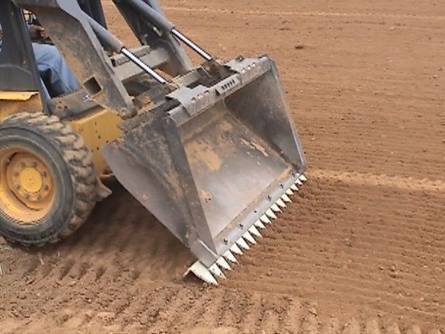

The rake in the earlier days, was bolted to the lip of the bucket like this.
The second pictureis shows how the straps and chain are attached.
   / Ratchet Rake - ever seen/used one? #48
