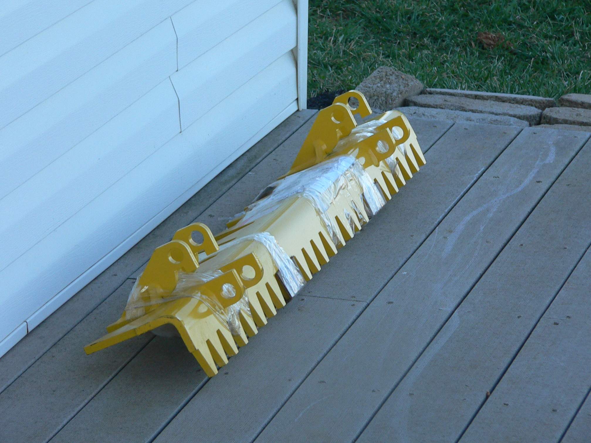

If one were to hit a big rock or stump while back dragging would it pull the bar off of the bucket?
I don't think so. Never has moved for me and I've hit alot of stuff. It usually rolls bigger rocks or the back of the bucket would hit anything to big before the RR even hit it but no, it's not going to come off, in my opinion. The slots in the RR that fit over the bucket lip are deep enough that the pressure is transmitted to the bucket edge except for that rare instance where the angle would be such that it would be pulling straight back but again, the wire/strap cable is wrapping around the bucket on two sides to distribute the pull force against the bucket.
