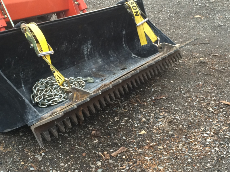

That looks good, just paint it yellow and you are good to go.

It will be put through the ringer as soon as the ground thaws, I've got lots of land to clear!
I decided to take it to the local machine shop and have them cut out the tooth pattern I stenciled onto it and the brackets. I couldn't justify the plasma cutter purchase yet and I'm not even sure what id need to cut through 1/2". Should have it back next week then ill weld the hooks on and slap some paint on it, pictures to follow
Can anyone recommend a good primer and paint for this application?

Use a TWO PART epoxy primer, and a TWO PART epoxy paint.
Any good marine store should have it in quarts.

Thanks, fried1765 I will pick some up at the local marina

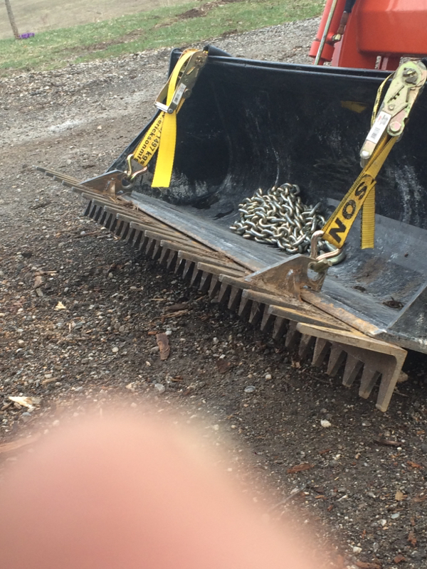

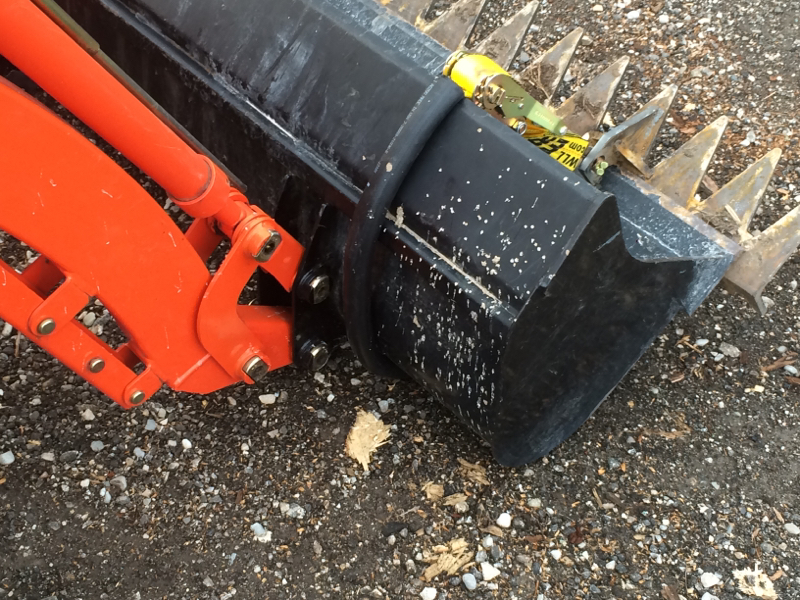

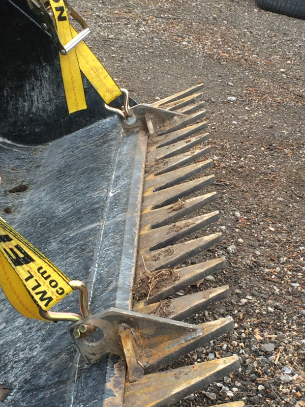

Well after getting the steel back from the shop, I finally had some time to put it all together.
As it turns out, I could have bought the actually ratchet rake for the money I've got into this now!
I'm not sure if I'm going to paint it or not, the epoxy paint and primer were over 100 bucks each, which would put me way over the purchase price! I don't think a little rust is going to hurt this thing anyway.
As soon as I got it welded up I tried to test it out but the ground was still far too wet so I'm chomping at the bit to get out there as soon as things dry up!
/ ratchet rake #30
It looks better than good :thumbsup:
It doesn't need paint to work, besides, rust is a color. :)
