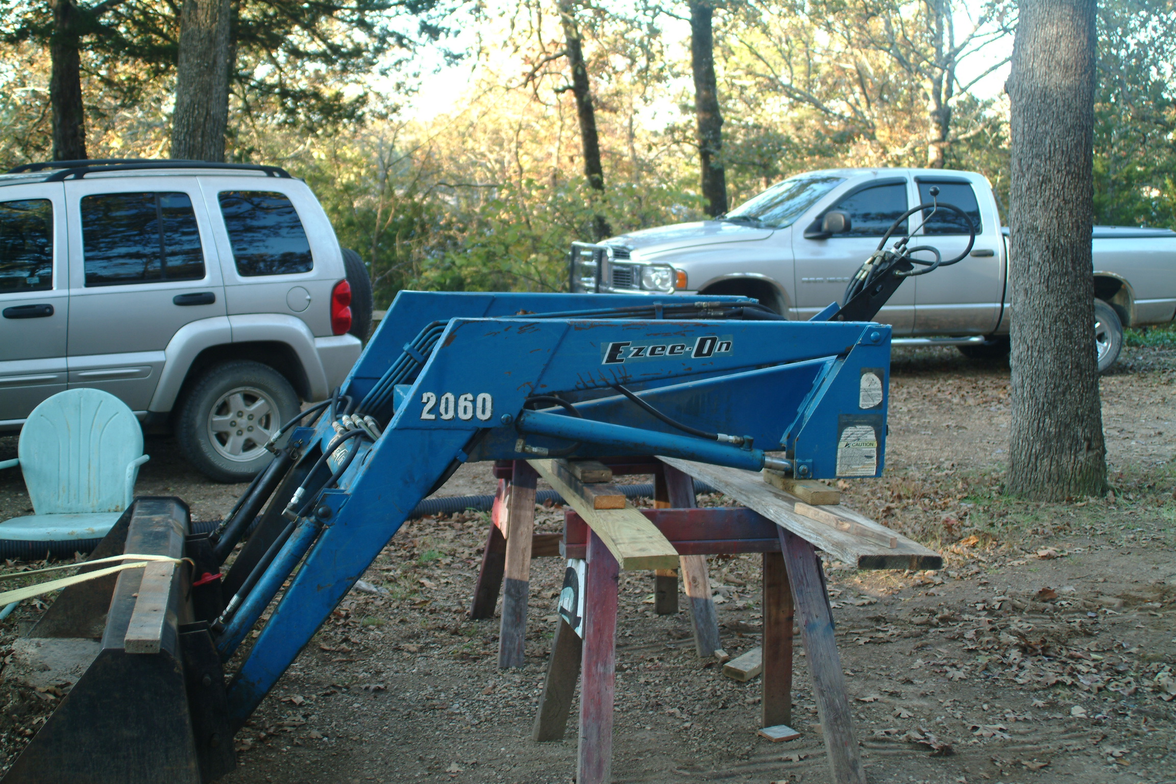

Re: Ezee On loader on MF 135 tractor
It's embarrassing to still be trying to figure out this FEL. I thought I had a good chance last time and was holding back the joystick waiting for the loader arms to raise when the nest to new supply hose blew; a local hydraulics guy asked if my FEL valve was open or closed center. I do not know and was told by another mechanic that he would not be able to tell if it was taken to him so I have sent it to Nimco controls for inspection and advice. While I wait, does anyone know the hydraulic requirements of an Ezee-On Model 2060 loader? I wonder if it is simply too much for the MF 135. DSCF0227.JPG
   / Re: Ezee On loader on MF 135 tractor #43
Sounds to me like it's simply hooked up incorrectly. Without good, detailed pics of the valves and hoses, it's difficult to say.
