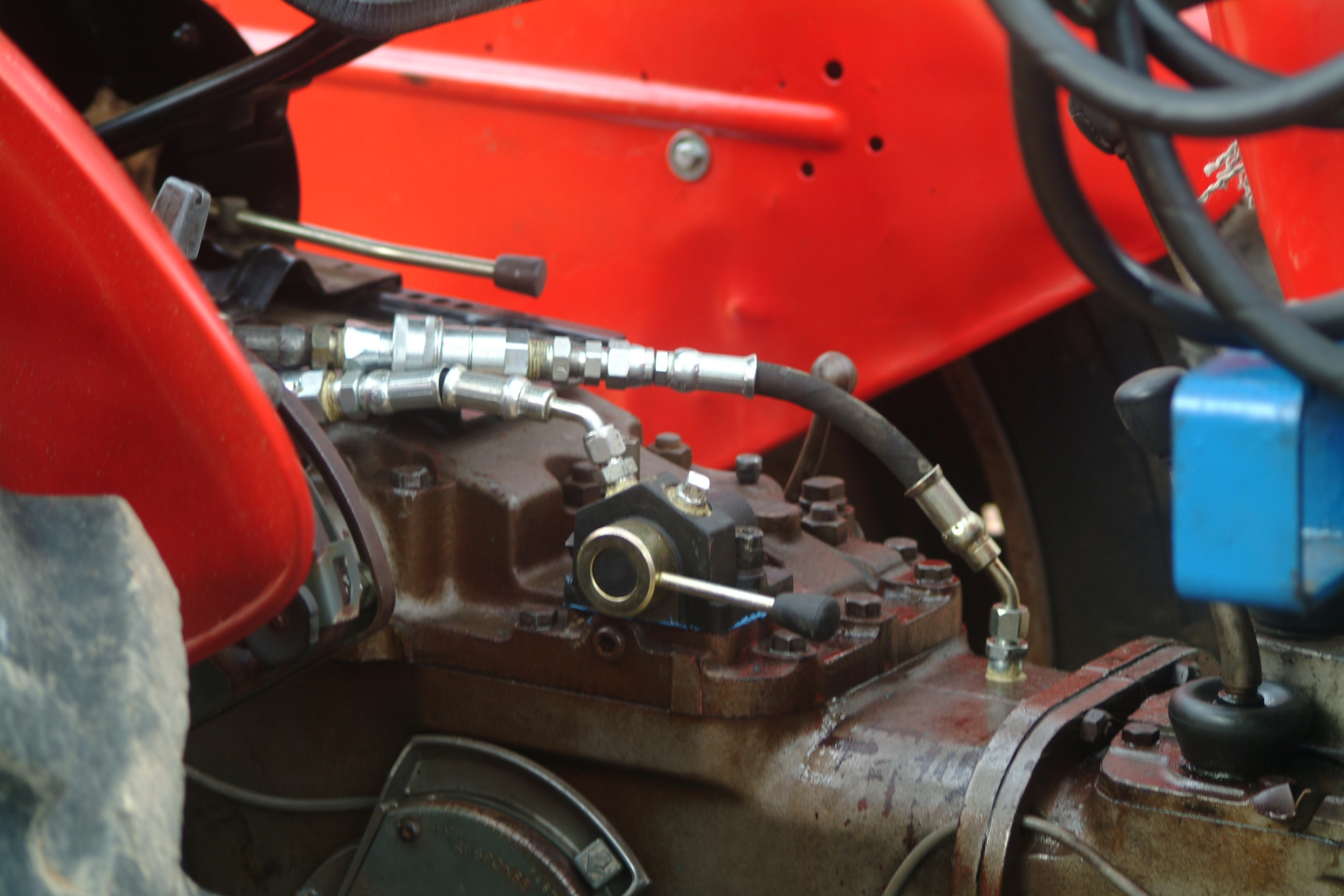

I have managed one photo to load to the attachments page, we'll see if it loads. DSCF0209[1].JPGDSCF0204.JPG
   / Re: Ezee On loader on MF 135 tractor #17
I have managed one photo to load to the attachments page, we'll see if it loads.View attachment 525483View attachment 525482
Now some photos which is a big help. Please try and answer my questions added to your photos.
I want to make certain I understand where the Diverter Valve gets its oil supply. Is it a valve made specifically for MF tractors and is supplied oil by being bolted to the transmission housing.
In your photo, one of the valve out ports has a plug in it. The lever selector is at that port's position. Does that not block the flow from the pump or is there more going on I don't see?
You talked of drilling and tapping a port into the transmission case. I assume the one I have marked is that one and if the hose was unscrewed, there wouldn jusst be a big void under that port?
Looking more closely at the FEL valve photo, is the actual valve behind what I am seeing on its side with the nut type thing I circled?
Dave M7040

The diverter valve in the first photo is a May Hill three port out valve controlled by the placement of the handle. It can apparently serve three different auxillary valves. The line coming out of it goes to the P2 side of my nimco FEL valve, not the T2 side which Nimco customer service told me is the out side of the valve (I took to mean return).. They do not have manuals on the valves that they no longer produce. The line I tapped in front of the diverter is indeed to return fluid into the upper void of the transmission. The plug below the FEL line is not something I would know about.
I have pulled the FEL again because it would only raise intermittently with much hesitation and I am afraid of damage. When it was set to the supply port and I was giving it it's test the lever was extremely hard to move to a different position. It makes me wonder if the supply and return lines are backward and the pressure too great for smooth movement of the handle.

It looks like you have a PB fitting in the tank side and you have it plugged. If so take it out then plug it.

I have a new after market May Hill diverter valve with three ports and a handle that conveniently indicate which port you have open because the handle seems to match the hydraulic oil diverter hole on the interior shaft. That to me means each of these three locations are supplies to auxillary implements. That also tells me that the return from a loader for example should be piped to one of the plugs that are in the upper part of the transmission housing on my MF 135.
Now I have it in my head that you ordered and installed the May Hill valve so you installed the pipe plug with teflon tape on it too. Is this correct?
The valve lever in your photo seems to be past the port with the plug you screwed in. Is this another position for the May Hill valve lever?
Could you easily remove the valve and then photo where is was sitting on the tractor immediately after you removed it. Also photograph the sides of the May Hill valve we have not seen in you photos.
Did the valve come with any instructions which you could post.
Did you have to remove anything in order to bolt on the May Hill valve?
In this next photo I have drawn a circle around an Allen wrench style plug in the transmission and just below the May Hill valve.
Because of its style and location it leads me to think somehow it is part of the hydraulic system.
