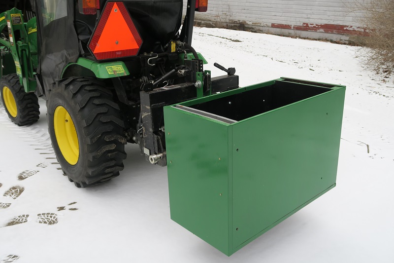

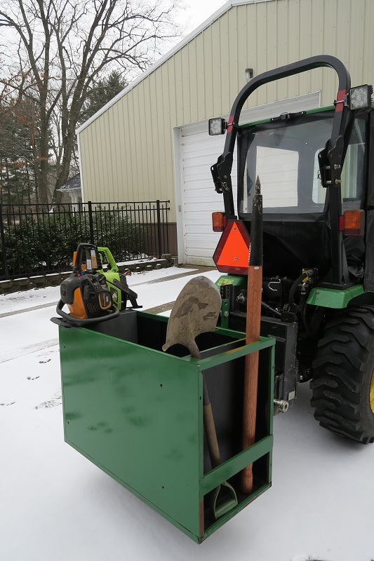

I hate to throw things away if there is any use for them, but I have some old file cabinets that will never be used again. I came up with a way to make one of them into a rear carry box that should come in handy. When I work firewood, I'm always carrying things in the bucket but I've not been happy with that approach.

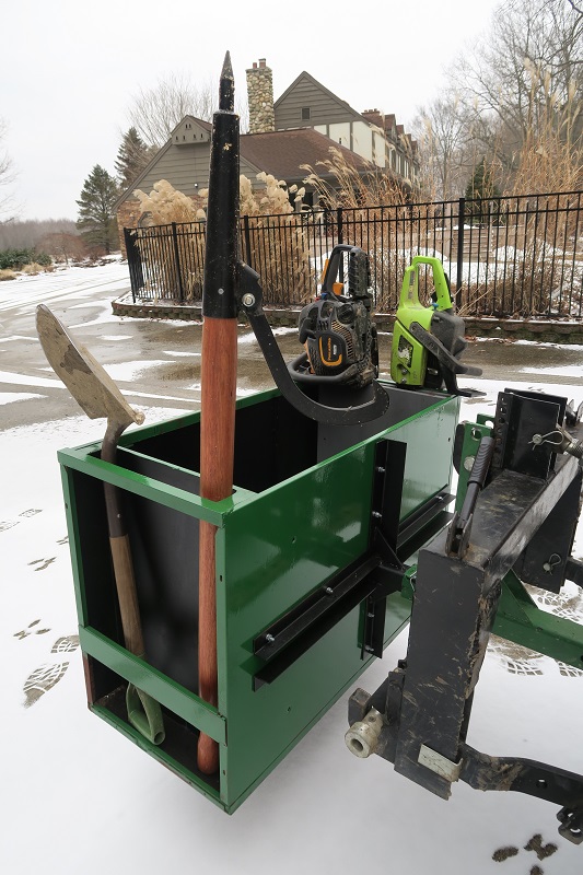

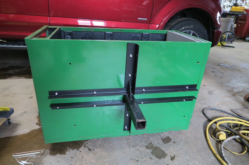

Basically, I cut out the drawers and cut a slot in the base for carrying tools like shovels and rakes. I made a sleeve out of plywood and mounted on the other side to carry the chainsaws. For simplicity, I made a 2 inch tube bracket so I can attach it to my receiver attachment for the quick hitch. I could have put a three point attachment on it, but this was much simpler.
I had the steel, the plywood and paint left over from other projects. The only cost was a dollar or so for fasteners from Tractor Supply (bulk by the pound).

Now mount the drawers to the back side of it to carry smaller things like bar oil, fuel, tools, etc.
