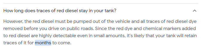

yeah I have heard mix information in regards of that, I heard that it can be trace many fill up after red dye was used but also heard personally from someone that he had red red dye in his tank and he filled up with clear diesel and then pass a inspection... which is it? I don't know.. maybe they simply checked the color and didn't test the diesel itself. Google say it can be detected months after using the kit and the whole system should be drain... fear mongering ?? perhaps... different testing kit different accuracy ?? perhaps...
10. How Long Does Red Diesel Stay In Your Tank?​
That can vary. If you’re wondering, sometimes the fastest way to check is to dip a tube in your tank and pull out a sample and see what color it is; there are also manual dipstick kits and black lights. But the gas doesn’t just stay in your tank – it goes through your fuel system. So if you’re concerned, take it to your mechanic so they can flush the system.
