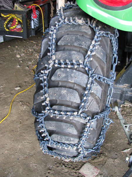

BlackRaptor,
You never want to have your rear wheels wider than your snowblower; the rear tires will ride up on the snow making your snowblower ineffective. You have two options; 1. get a 60" snowblower and have wings built for it to cover the width of your tires or 2. buy the bigger snowblower. Just my opinion, but you might be better purchasing the larger snowblower. The guys are right that Buhler makes a very good snowblower, but the M.K. Martin Meteor snowblowers are also very good and they do build a 68" snowblower which might a better option for your tractor. I had used the 68" Meteor snowblower for 10 years when I had a NH TC33D and when I had a NH TC34DA (both tractors at 29HP PTO) and it worked flawlessly. Take a look at the URL link below.

new meteor.jpg I have a 75 inch Meteor on my 3320...have used Meteor snowblowers for about 10 years with no problems...this picture was taken about three years ago before I installed spacers and chains3320 chain rear.jpg The second picture shows the tractor with chains and spacers installed.
