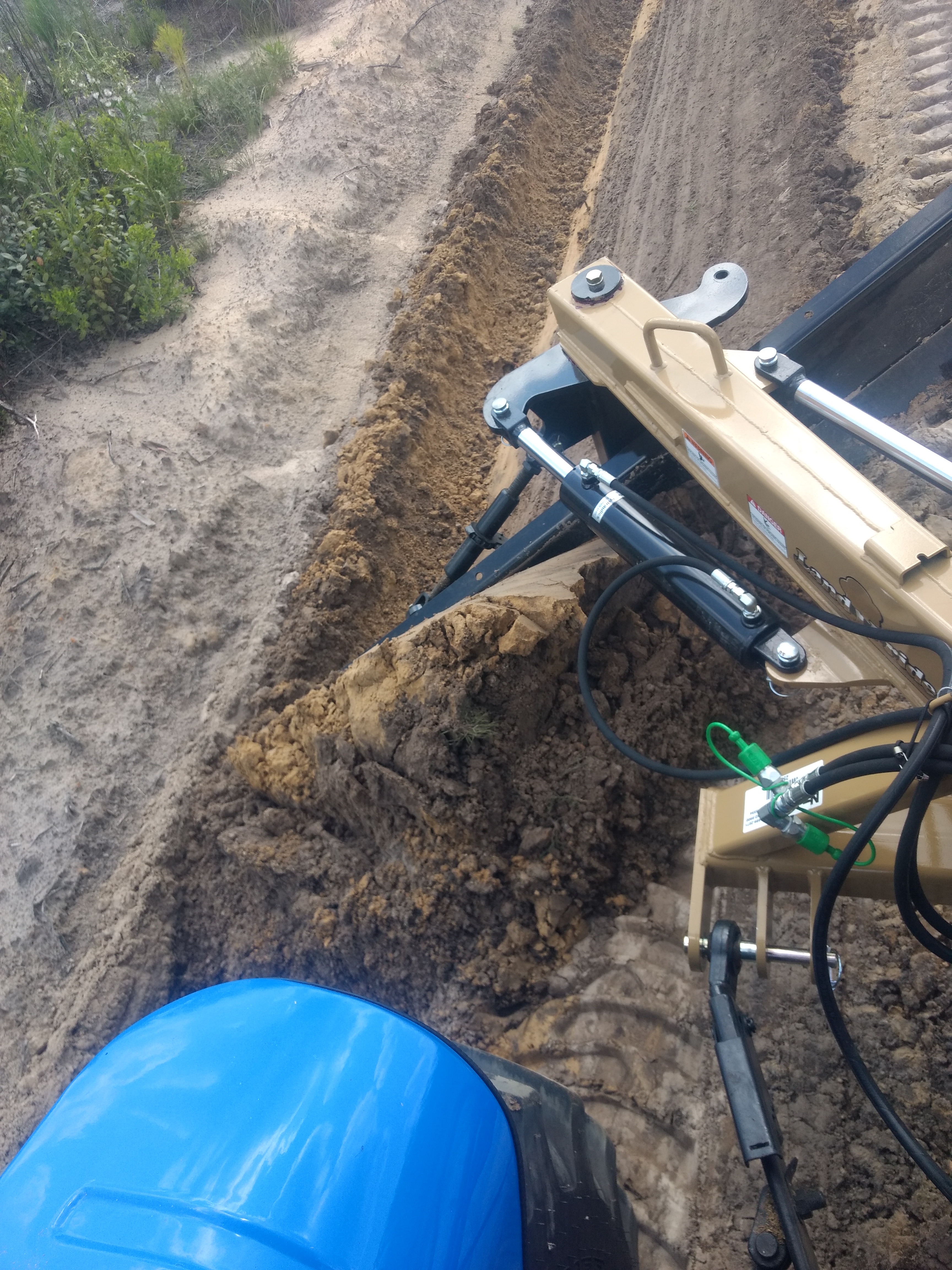

Following along here and learning. I have a rear blade that isn't doing enough for me and my trail making/grading. Just bought a used box blade and decided to invest in a top and tilt system from Fitrite Hydraulics (a member on TBN). Waiting for its arrival. Fit Rite Hydraulics - fitritehydraulics.com
My problem is I am cutting trails into a side slope an cannot change the slope relative to my wheels. Hoping the tilt will be the holy grail.

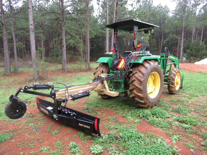

Looking for some ideas on a rear blade. I have a few miles of trails that I need to maintain, the box blade does a great job for the most part, but it leaves the trails dead level side to side which makes rainwater pool and cut channels. So I need some way to crown the trails and I was thinking a rear blade would work, set it at an angle, let it dig with a corner and throw the scarf up onto the trail. Then use the BB to smooth everything out leaving a ditch on both sides. First question, is a rear blade a good/right tool for this? Seems like it should work, but my soil is heavy clay, so.. Next question; how much to spend on this thing? Seems like this is going to be a tough life for a blade (moving virgin soil around), so I was thinking going heavy duty, but, if this is child's play, tell me, and save me some money! ;)
Finally, specific brand recommendations/features? I've got rear remotes, so was interested in getting hydro tilt/angle/offset.. But do I really need all 3?? I'm not sure I need any of them if I'm just cutting a ditch always on the right hand side of the tractor? But I love hydro adjust, so.. Might be worth it.. Adding hydro adjust to my BB (via a top link from Fitrite) has greatly increased it's utility and ease of use, so I don't want to cheap out on the blade just to find that I really should have gotten hydro because I wind up adjusting it all the time.
I've been looking at the EA models, they have 2 that interest me, the extreme duty and the Landshark models. The ED model doesn't have hydro options, is lighter, and quite a bit cheaper. Anyone have that and happy/not happy with it? Bonus if you're trying to move GA clay around with it!

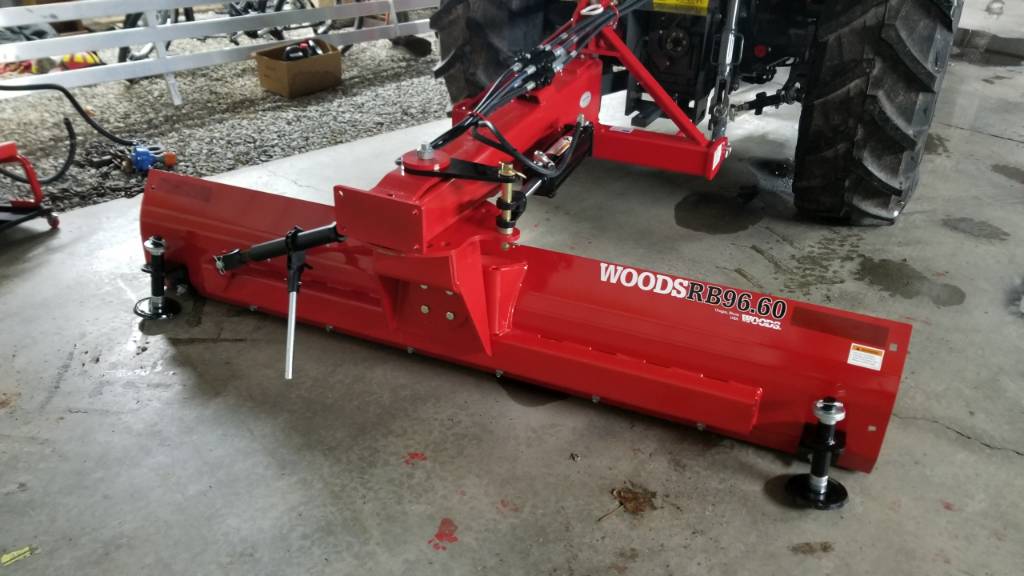

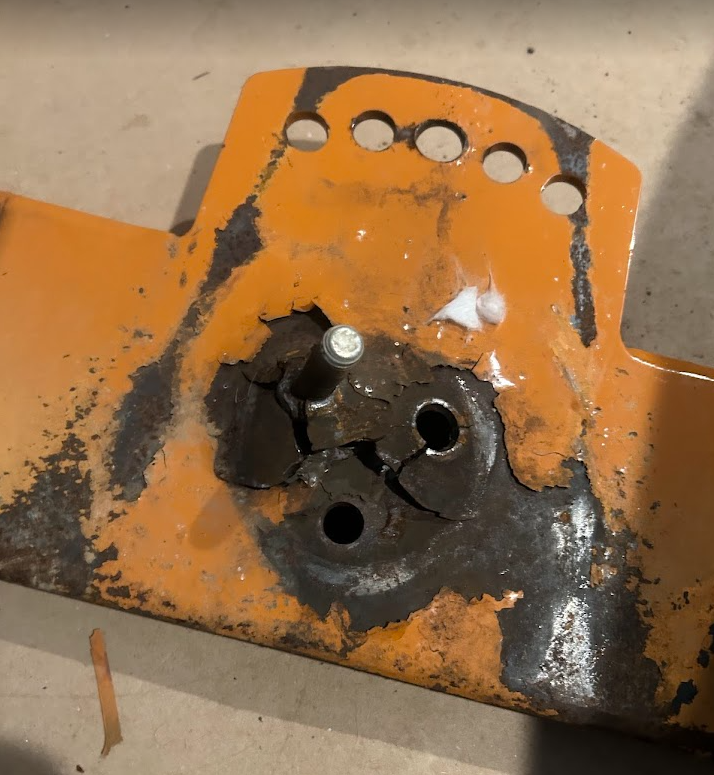

Stay away from the Woods rear blades. I purchased an RB96.50 for use on a yanmar 424 for clearing snow 3 years ago. The plate that holds the blade completely fractured. I am out $400 buying a replacement part.
Woods generally makes good implements. That appears to be their light duty model.

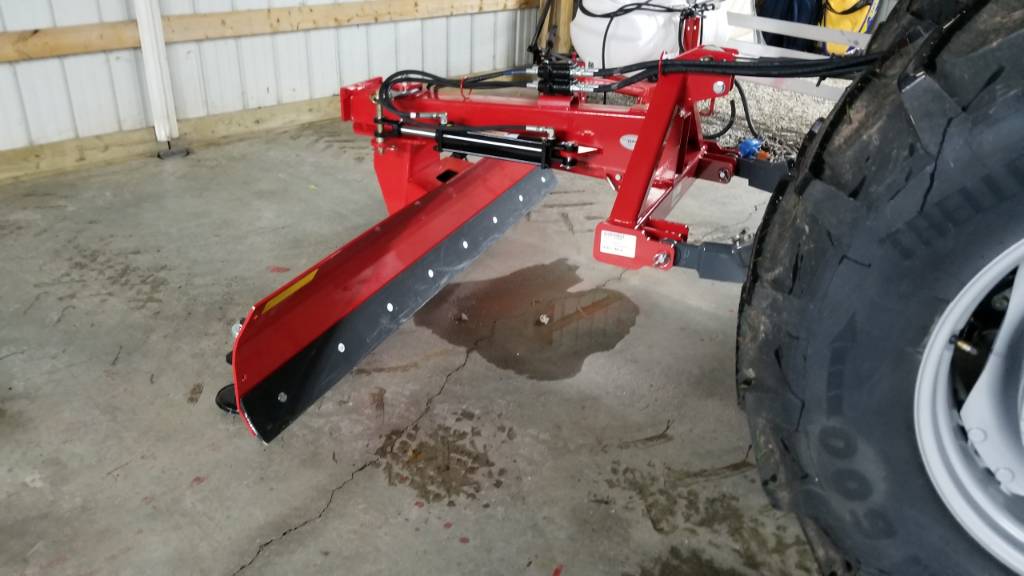

Question for those with grader blade hydraulics: What size cylinder do you have or should you use for the angle function? I have the EA ED 8' grader blade and that's the function I would like to change "on the move".
Thanks,
I have an 8’ Bison blade with a 3”x12” hydraulic cylinder for the angle function. But the length is dependent on how your blade is designed.
