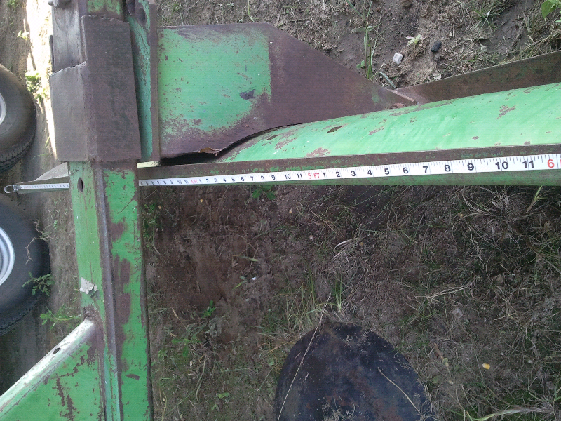

Looks pretty good, I am concerned about the blade being tweaked in the second picture though. Guess we will find out tomorrow.
   / Rear Blade for JD 5303 #44
Yea, I dont know if its an illusion, but in the second pic, the side that is still up in the truck looks tweaked pretty good. But other pics it looks straight???
If it is straight, and in otherwise good condition, you could slap a new cutting edge on it (~$100), and a fresh coat of paint (~$30) and have a total of $330 in it, And I think you could easily double that if you wanted to sell it.
#45
Here are a few more pictures.
   / Rear Blade for JD 5303 #46
Still kinda hard to tell. So I'll ask...Is it bent or straight?
In the second pic, it looks straight
In the third, it looks a little bowed.
I also see that part of the horizontal peice is bowed wehre the pins are. Easy fix. Straighten it, box the underside in, (also helps prevent wasps from making a home), and add triangle gussets from it up to the toplink "tower"

Looks like from side to side, the ends are swept toward the hitch about 1/2" or so. Would have figured it would be the other direction if bent.
   / Rear Blade for JD 5303 #51
What about down near the cutting edge?
Cause if the EDGE is what caught, it could have pulled backwards while causing the top there to "roll" forward a bit??
All in all, it dont look too bad though.
I'd do a little bracing and a quick re-paint and you'll be good to go. For the price you got it at, unless you totally mangle it, you did good.
   / Rear Blade for JD 5303 #52
Sounds like the middle section is loosing the curvature or being straightened out. I know mine isn't tweaked at all and I really haven't used it much at any rate so I might be better off to reinforce it now before something happens. If I can do this I could mail you some cardboard templates for the braces if you wan't. Don't think it would be difficult or expensive to fix and should be very worthwhile to do.
EDIT: The picture didn't show up for me until after I posted. I agree with LD1 that the bottom ends have likely twisted and rolled the blade slightly. Still think adding some ribs and braces is the best thing to do. You can probably unbolt the blade and lay it flat on concrete then use your tractor to drive over it and push it down flat. Then weld the longitudinal stiffeners in place to hold it straight. A few ribs to hold the curvature and you should be in good shape for a cheap price.

IF you are interested in hearing how I would do the re-enforcement, here goes...
this supports the blade itself. This is the strongback. Dont have to be super heavy duty. Its the added depth that gives strength. 1/8" plate would be sufficient. Or could use a piece of 5" channel iron or something and then cut the triangles for top and bottom.
This is how I would strengthen the A-frame:
Box in the underside of the horizontal. This will increase the strength in the horizontal (pulling direction) significantly. And also prevent bees.
The gussets will help prevent bending in the vertical direction like it has already been bent.
This is what I would do if the blade were mine. Materials to be used and design of it would all be dependent on what I have in the scrap pile. But even if you had to buy new steel, AND have it cut/sheared to your dimensions (triangles and such) I dont see it being more than $100 worth. And this would significantly strengthen the blade. The only last weak link would be the pivot pin diameter, and the category 1 hitch set-up. But I dont think any of that would be a big issue.
Also, if it has not been done, one other thing I would do...that triangular box u-shape piece where the TL hooks up....that entire vertical section, if it isnt welded solid to the main beam...I would do so.
Again, this is just what I would do if it were mine. It would take maybe half a day at most with just a set of torches and a welder and digging through the scrap pile. But YMMV as always.

It looks like to me it is all twisted up. The hitch pins are even bent downward.

I woul also run a piece or two angle across the whole 7ft of the moldboard.
   / Rear Blade for JD 5303 #57
I know my drawing is crappy, but if what I showed in the first picture is done, the angle wouldnt be necessary, or nearly as strong.
What I am describing is how the backs of heavier blades are made. Look at the landpride 35 series RBT35 Series Rear Blades | Land Pride
Also...I think a 2.5" kingpin is pleanty. I have one of the KK HD blades King Kutter Heavy Duty Rear Blades And even though I pull it behind a smaller tractor, I am fairly certain that it is rated much higher than either one you guys' tractors.
