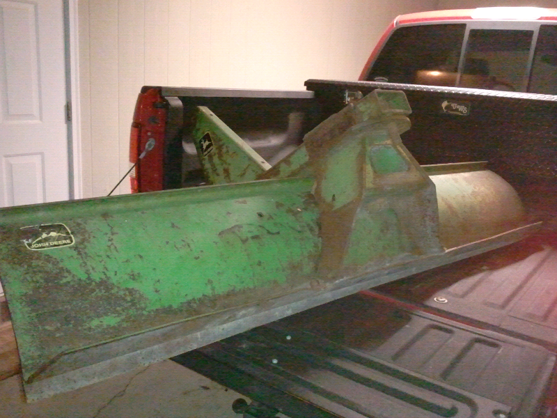

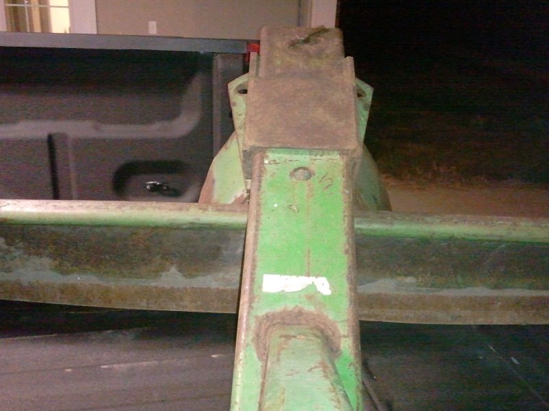

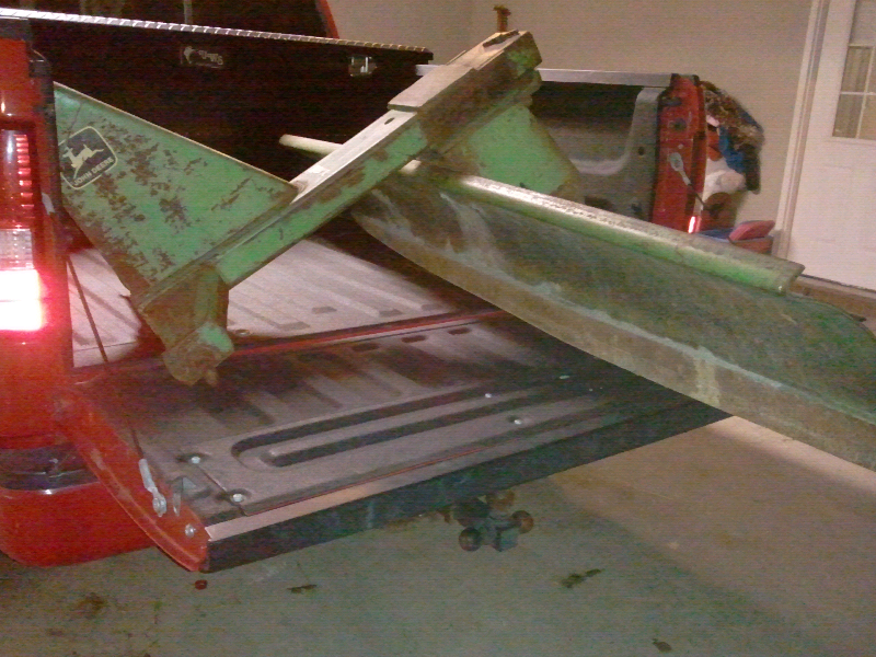

Don't see the need for the large gusset plates since the top link is free to move from side to side,:confused: am I missing your intent?
The intent was to prevent it from bending like it has obviously done before. I too have been trying to figure that one out:confused2:
While the gussets may not be necessary, they are easy and cheap to add, and you see all of the big blades have some sort or triangulation there. And I too have been known to use the blade with a pull and lift method to rip out some smaller stumps. Allthough I would think it would bend up instead of down, either way, gussets will help with that.
/ Rear Blade for JD 5303 #83
Having a blade like this I think the added steel on the bottom to box it in is more than adequate and think that suggestion was well founded. If you are trying to lift and pull a stump out with this blade I would use the center of the blade. Just as using a fel to lift a load from one edge can tweak the loader I think this was the result of abuse. Better to bend these front cross pieces than twist the main beam because they are easier to fix.
Using the blade as it is intended I doubt the OP will have a problem with it. I would recommend he straighten them and box in the bottom as you recommended.

You guys definitely have an eye for catching things out of place and the knowledge on how to correct and improve it. If I can make time today, I plan to put together an all inclusive list of things that need correcting and post it. So far I agree with the vertical and horizontal bracing of the mold board and straightening the 3pt hitch and boxing it in for added strength. I also would like to see what the repair work around the hitch was for and if it can be improved on, primarily for cosmetics. I do not intend to ever try to pull anything up with this tool. If there ever was contact with a stump or root, it would be accidental. I have seen the results of using tools outside of their intent. Doesn't take long to ruin things.
/ Rear Blade for JD 5303 #85

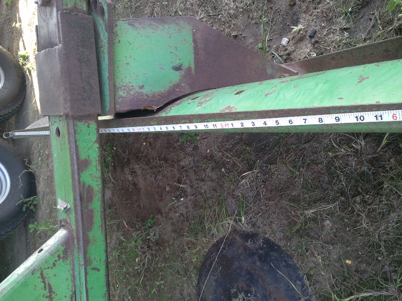

Here's what I came up with so far, split a piece of 4x6 x 1/4" rectangular tubing and fitted to the blade. Tell me what you think before I clean them up and weld in place.
Guy's the more I look at this the more I think the back braces need to be more substancial, deeper and taller. Steel for this is pretty cheap, a 6x8 or 8x8 drop of tubing about 4' long is enough to make this repair. I am thinking I will wait until I go by the steel yard and see if I can find a more appropriate piece of steel to use for this. I would make it the same way but bigger, deeper, and better.

I dont really think it is necessary for your tractor or even the op's, but there is no harm in going bigger just to be sure. Keep in mind that the curvature of the blade, and the lip at the top and lip at the bottom also offer significant strength vs just a straight piece for a moldboard. Also, adding a piece vertically out at the edge like you see on some blades (like the new EA blade) also offers strength by forcing the moldboard to remain curved.
/ Rear Blade for JD 5303 #88
Why not a piece of 6" or 8" channel?

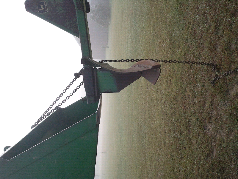

With all of the suggestions and input, I think I have a plan:
1) straighten 3PT hitch, replace pins and close in bottom and front, but leaving room to access nut on pin
2) add vertical bracing on each end of moldboard
3) add 6" or 8" channel across back of moldboard
4) replace cutting edge with bolt on type
This seems to be similar to what is on the Frontier RB2184 which is rated for 60 HP 4WD unit. I think I would be ok since the JD 5303 is rated at 64 HP at engine.
May try to get by to see the welder this evening.
Anyone see any other needs I am missing?

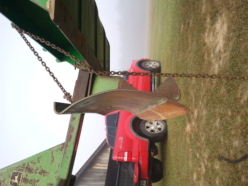

Made it by the welder this evening with instructions and pictures. He had some grader blades already drilled and 7' long. Indicated he was just about finished with a new metal break and thought would not have an issue straightening the moldboard. Going to try the channel across the back and gussets on each end. Thinking of going with 8" channel. Going to remove the repair work to see what is under it to determine if the best repair option was used.
Still got time to make change in the morning if any better suggestions.

May call welder tomorrow and suggest he look before purchasing new channel. May be that the location he buys from has a "scrap" pile that could be picked from for a lesser price. I would like to pick up welding and fabricating as a hobby, but this guy works for $15/hr plus materials. For the amount of work I need done, I would never come out.
