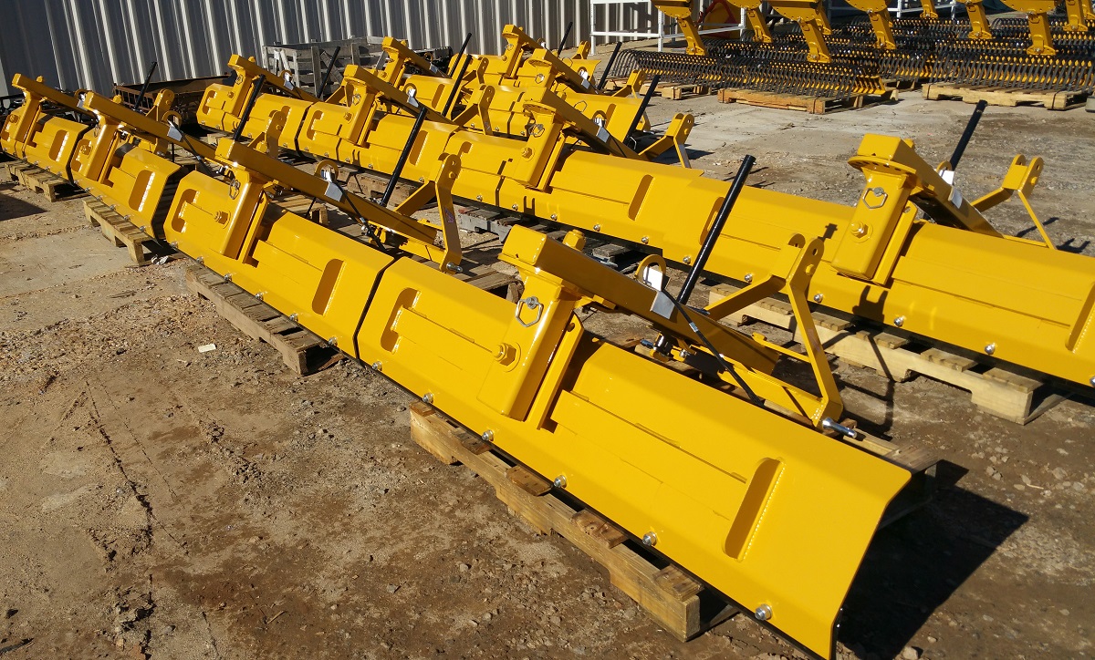

How long would it take to get to Vermont using the shipping to home for the extra $
We have 60" and 72" ready to roll. Several 84" are in production, tacked and waiting for solid welds. If ordered this week, one could probably ship next week and be there the following week. That's my best "crystal ball" estimate!

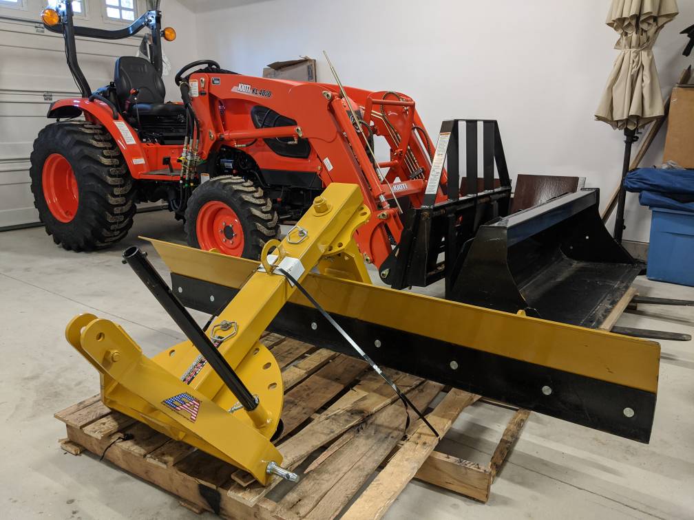

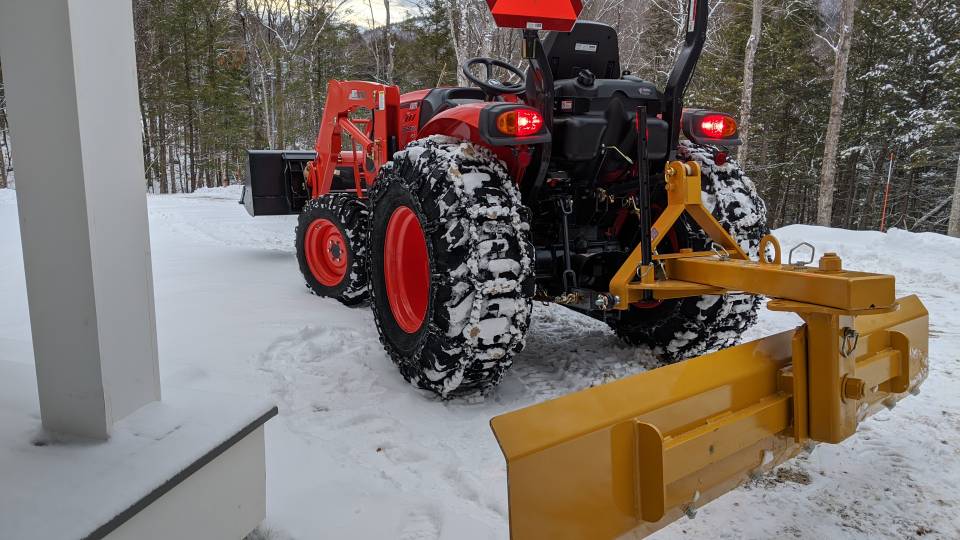

Thanks everyone for the insight! My driveway is twisty and hilly and not very level and has some ditches on the sides as well as being gravel/ dirt. It is quite narrow maybe 10-12 ft. I wanted to get some more opinions as my dealer was saying the 7ft was too big and the 3901 would struggle with it. Seems most here would go 84”...
I think width-wise, it depends on the weight of your tractor, weight of the snow (wet & heavy "mashed potato" vs powder) and how many "passes" you are "adding" together and trying to move, and what is under the snow (ice?).
Will you have chains? Ballasted filled tires?
I only plow a dirt driveway and a feed area around my barn. I find that some years, once plowed, it just make a bare surface that can become a skating rink if it then rains and freezes. This is when chains are a must.
My tractor is a lot heavier than yours (~9000lbs (?) w/ loader, ballast & blade), and under various combinations of conditions (heavy deep snow, multiple plow passes adding together, ice base, and angled blade, etc..) there are times I'll get pushed sideways with a 8' blade. Majority of the time it's no problem.
Some would rather have the width and compensate during those times (i.e. don't start in the middle of driveway & add multiple passes together, take more passes, etc..)
I think it's a coin flip
...if you have chains and loaded tires (& FEL & blade puts you around ~5000 lbs?)
Some days you'll wish it was 7', other days 6'.

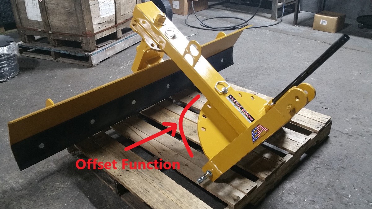

X 2 on a 6' OFFSET Year Blade.
