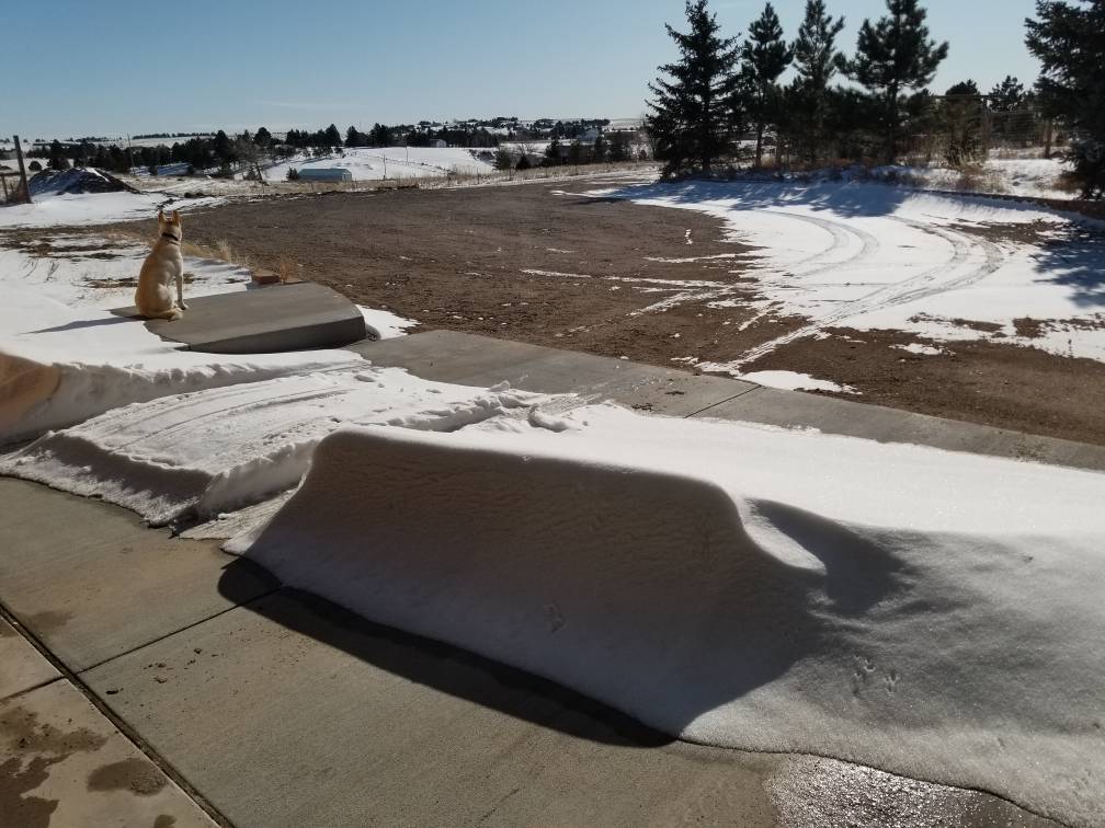

This is what 1" of snow ends up looking like here in Colorado... 75% bare ground & a foot & a half drift of pretty dense snow. Multiply that by a foot or more of snow & you end up high centered. Places that get snow without wind have it much easier. Back blades & rear pull blowers are a lot more feasible there. 20191229_120524.jpg
