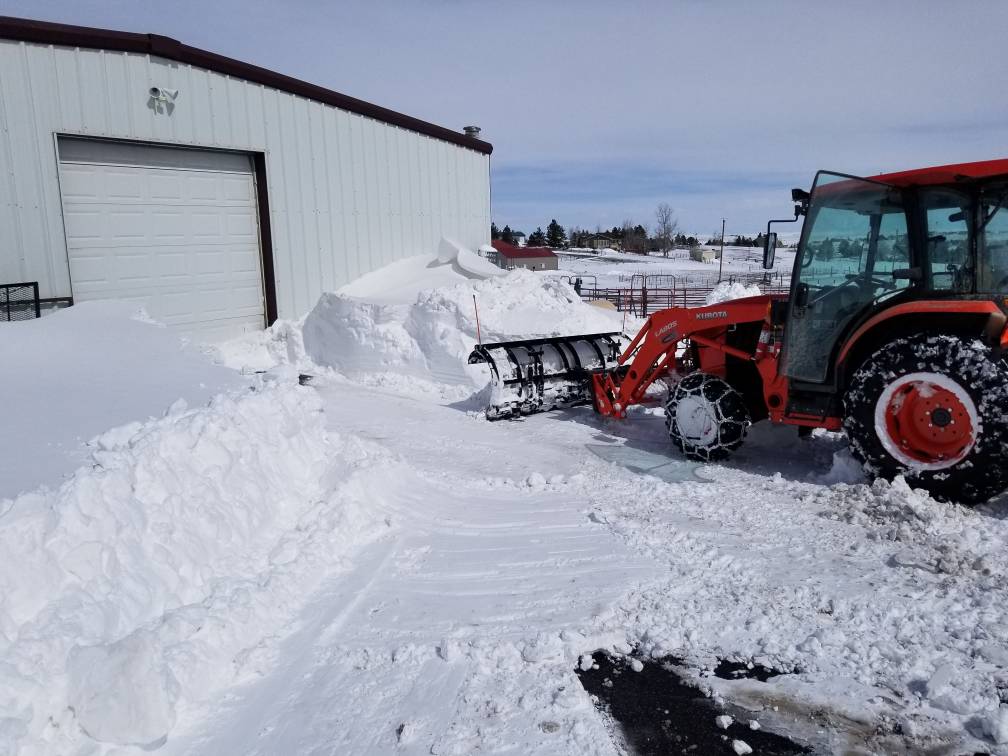

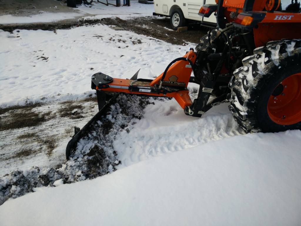

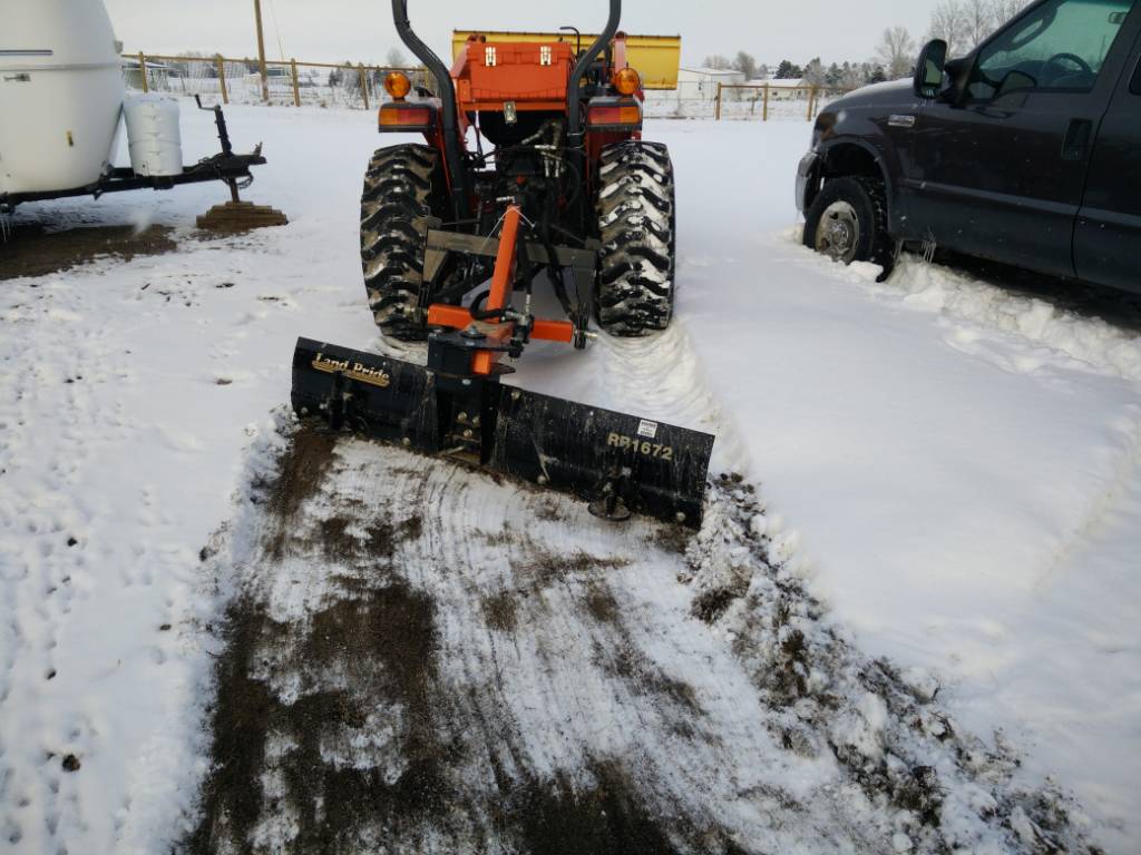

Found an old photo with the old back blade on It. 72" apparently. You can also see the manual SSQA blade on the front that I prefered to the hydraulic back blade. IMG_20151127_154012.jpgIMG_20151127_154021.jpg

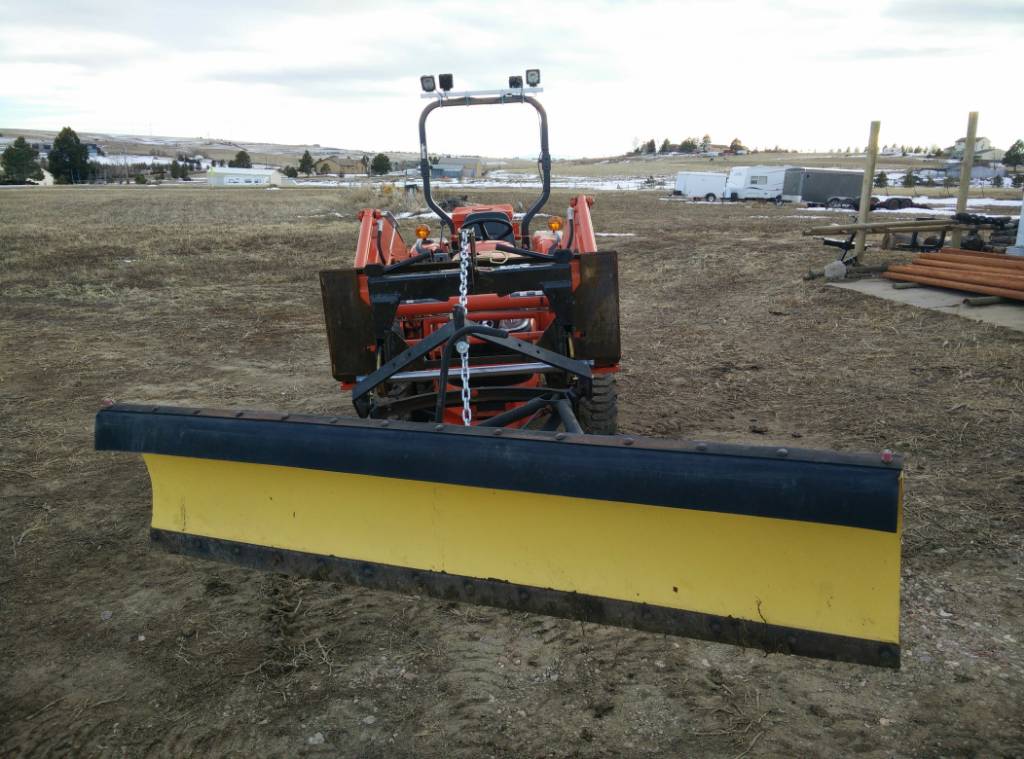

At garage sales for $100 a part or so, probably $300 total and a weekend into making it. Welded a QH to a SSQA plate. Mounted the plow to a pipe I welded fittings to that fit the QH. It was a cheap light blade designed for a small jeep or what not, fit the L3200 pretty well.
It stuck out a bit to far & was a bit light but worked well. Lots of float on the blade, almost to much as I could flip it backwards with the loader all the way up. My new (stainless) SSQA blade is a solid mount & gouges. If you float the loader it unloads your front end. No traction, front end lifts off the ground, things dig into the gravel. I plan on rebuilding the mount at some point. A 3pt blade has float from the 3pt intrinsically so doesnt have the same type of issues.

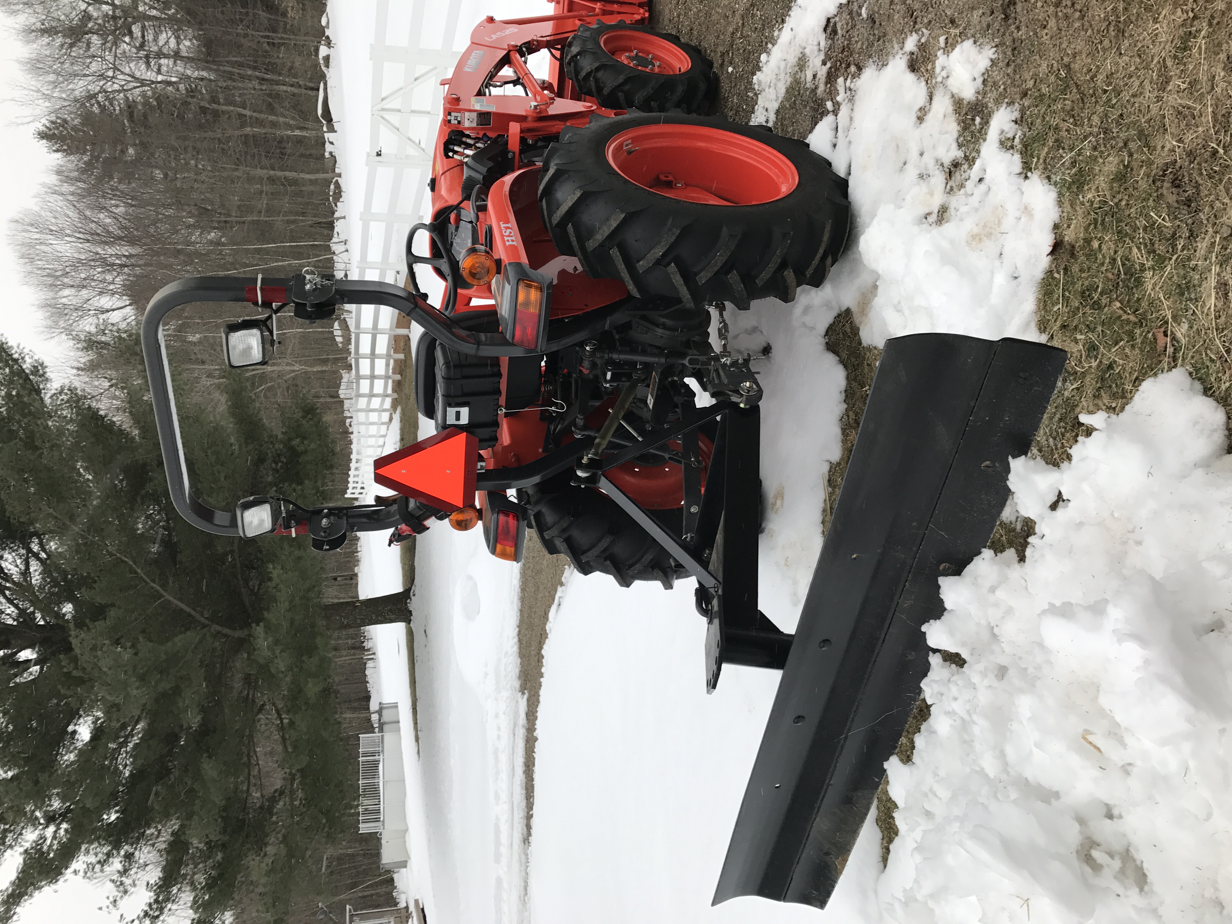

I have the same tractor model as you and I use a 7 footer on mine. Contemplated the same decision you are making and I have been very pleased with my choice. The tractor handles it with zero problems and the width on angle covers the tire tracks(and I have mine set at the widest distance).
I also have a long gravel driveway. I reverse the cutting edge so it will not dig in before the ground freezes. Good luck with your purchase.
