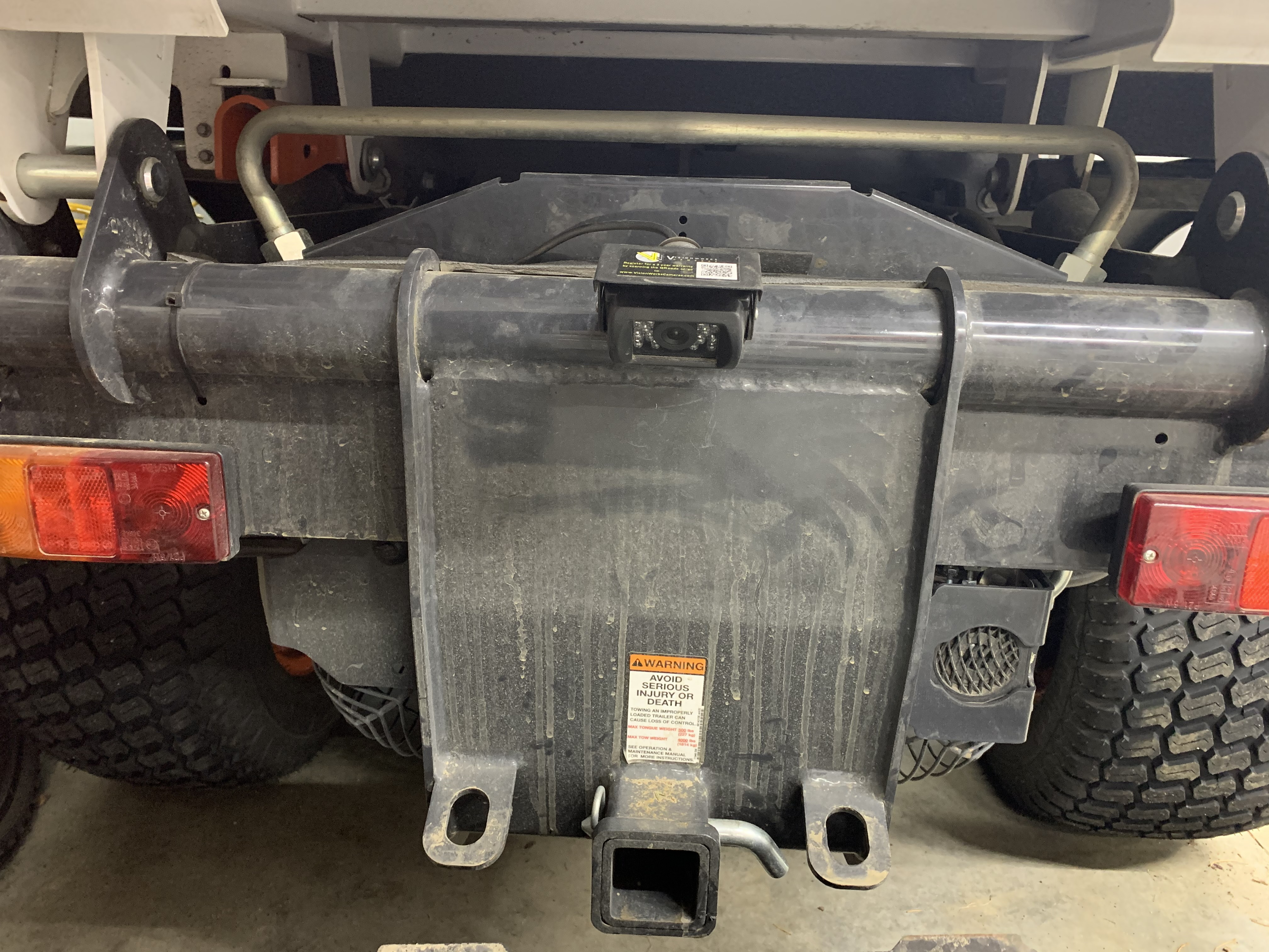

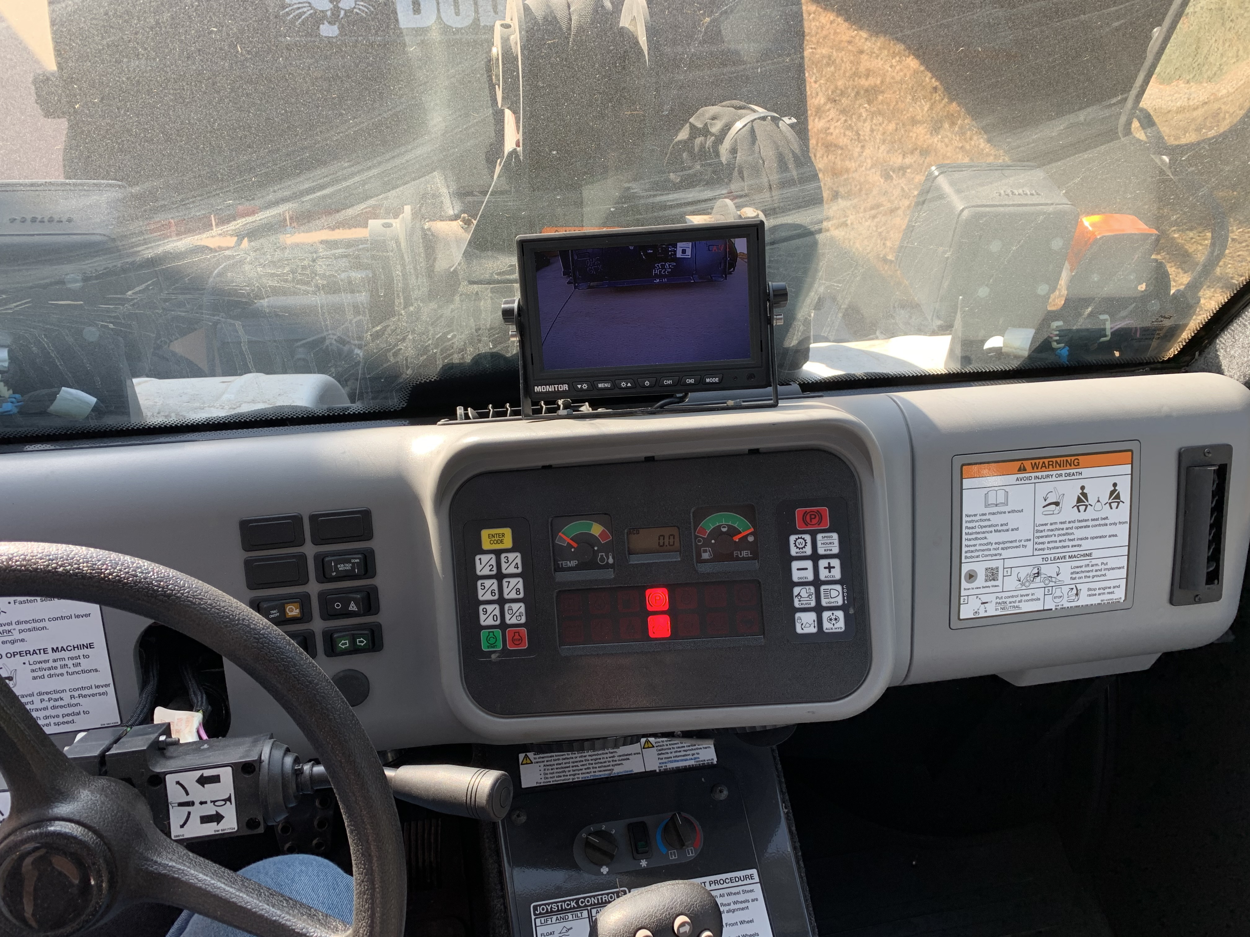

Here is what my dealer installed on mine. I have been happy with the placement of both the camera and monitor.
/ Rear Camera recommendations #15
Thanks for the pix. Just from looking at them it would seem that a monitor screen that large would obstruct view of attachments. Regarding the camera, it looks exposed. Is it magnetically mounted so that it can be easily relocated? In winter I have a spreader in cargo bed which has a spinner that hangs low enough to block camera view. Does raising cargo bed block camera view? What brand? Is it made in China? Thanks for your reply.

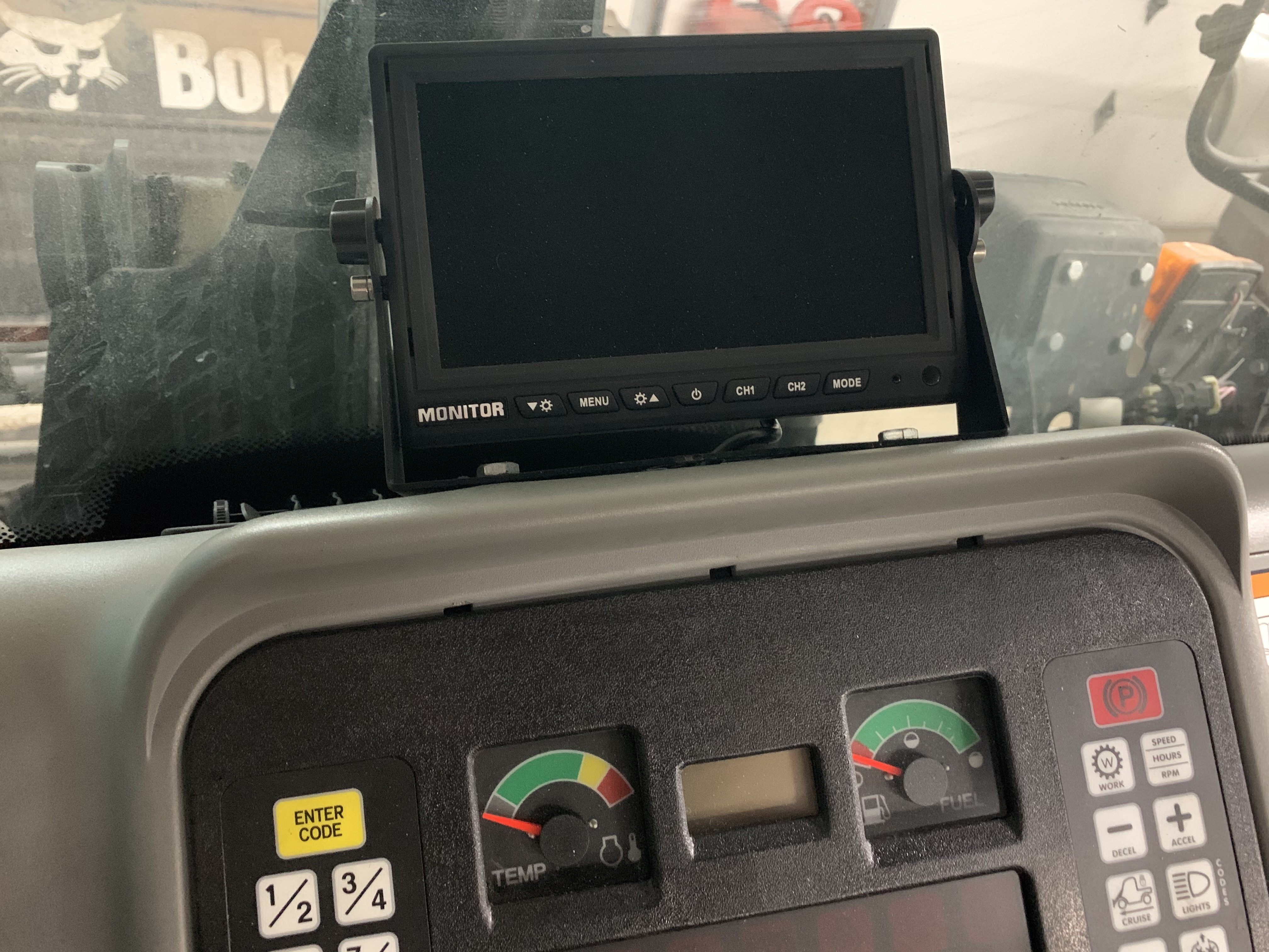

I have no concerns about the screen placement. It doesn’t obstruct the view out the front window very much. My dealer suggested putting it in that spot. After using it for the past 6 months, I wouldn’t want the screen placed anywhere else. I will post another picture that might show it better. It is a Visonworks Camera that I believe are made in Oregon. Mine is hard mounted but I don’t see any reason why it couldn’t be magnetically mounted. Raising the cargo bed doesn’t obstruct the camera at all. The camera is adjustable so I can angle it up or down as much as I want. Makes it nice for hooking up trailers. It is a little exposed but so far it hasn’t been a big problem. I could see situations where it could get covered in mud/snow. I have only had to wipe off the screen once after driving a few miles in slushy snow. Sorry about the dirty windshield on the pic, looks like I should clean it.
