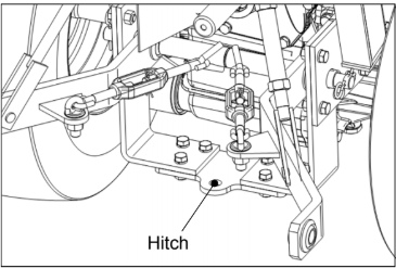

My SCUT does not have a drawbar (manual says it is optional), it does have a hitch down low. The manual gives some maximum loads for the hitch:
Vertical load : 400kg (882lbs)
Horizontal load : 1600kg (3527lbs)
I bought a chain with a working load above that for dragging logs (and the relevant clevis hook).
I am pretty sure that the tractor will spin the tires before it could pull a horizontal load of that amount on dirt. It has a 7-pole connector and information on towing a independently braked trailer, so those values are useful for working on pavement with a trailer.

I put a steel cross bar that fits in the two lower units of the 3 point hitch. The arms on those are about 5/8 thick steel. Logs are chained to the cross bar to lift and then I pull the logs. Concerned that may cause too much strain on the 3 point hitch system as TPH was designed more for bush hog mowers etc, not heavy lifting and pulling.
The steel cross bar is known as a CROSS DRAWBAR. They are made of mild steel, so they will bend, rather than snap, if overstressed. In timber work, you rarely encounter a straight CROSS DRAWBAR. The CROSS DRAWBAR has two advantages: 1) It lifts one end of a timber, reducing friction over most of its length when pulled. 2) It lifts one end of a timber so that the timber is LESS likely hang up on a rock, root or a burrow, instantly pulling tractor up onto its rear wheels, especially pulling tractor loads uphill. (I have personally experienced this, skidding logs over flat ground with a REAR/CENTER DRAWBAR attached to a Deere 750.)
MORE: 3-Point Hitch - Tractor Three Point Hitch CROSS-DRAWBARS
Tractors are designed to PULL over level ground.
a low receiver type opening that appears would be more substantial to pull on and with except that has no lifting capability so the entire log for the most part would have to dragged in the mud as opposed to just the end if it could be lifted in part above the mud.
The rectangular attachment which fits into this receiver hitch is known as a REAR/CENTER DRAWBAR. Receiver is attached directly to the tractor frame. Attached load is pulled at or below level of the rear axle. This is the correct point at which to attach heavy towed loads.
Tow slow so that the timber will not hang up on a rock, root or a burrow, instantly pulling tractor up onto its rear wheels, especially pulling tractor loads uphill.
