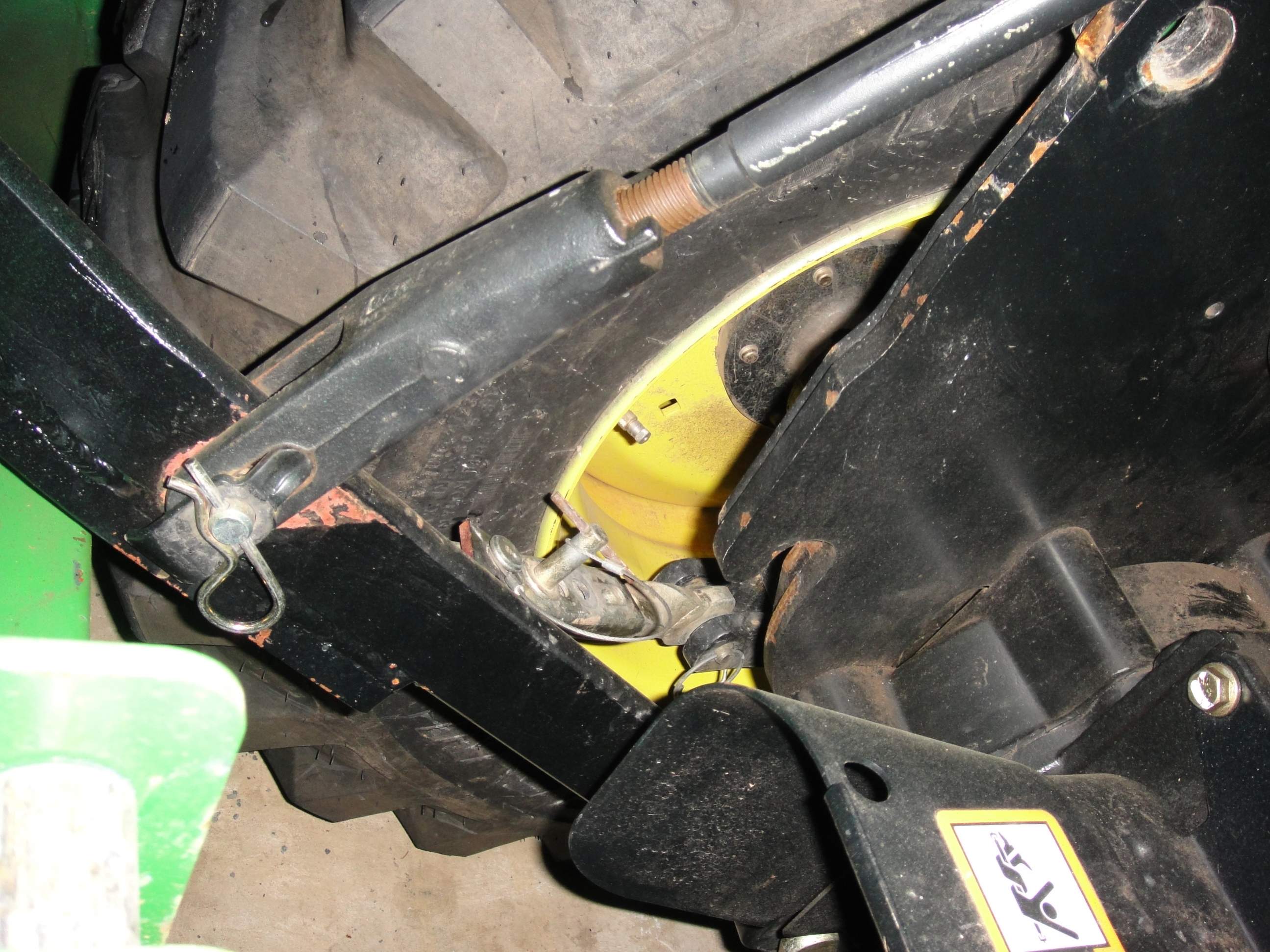

I just spent $300 on chains for my tractor. They were at the widest setting with the valve stems on the outside. These chains are pretty beffy and they will not fit without hitting the fender . There is also linkage underneath that it will interfere with. I did reasearch before I bought these and don't understand why they don't fit. Are my rims not the same as the other owners on this site. I did install the front chains but they do "touch" the steering knuckle a bit. I am at the end of my patience with trying to get my tractor some traction. This is really disappointing. What is different with my situation that will not allow me to install these chains. Can someone out there with a 4410 and chains installed explain to me what is wrong here. Thanks so much for any reply.

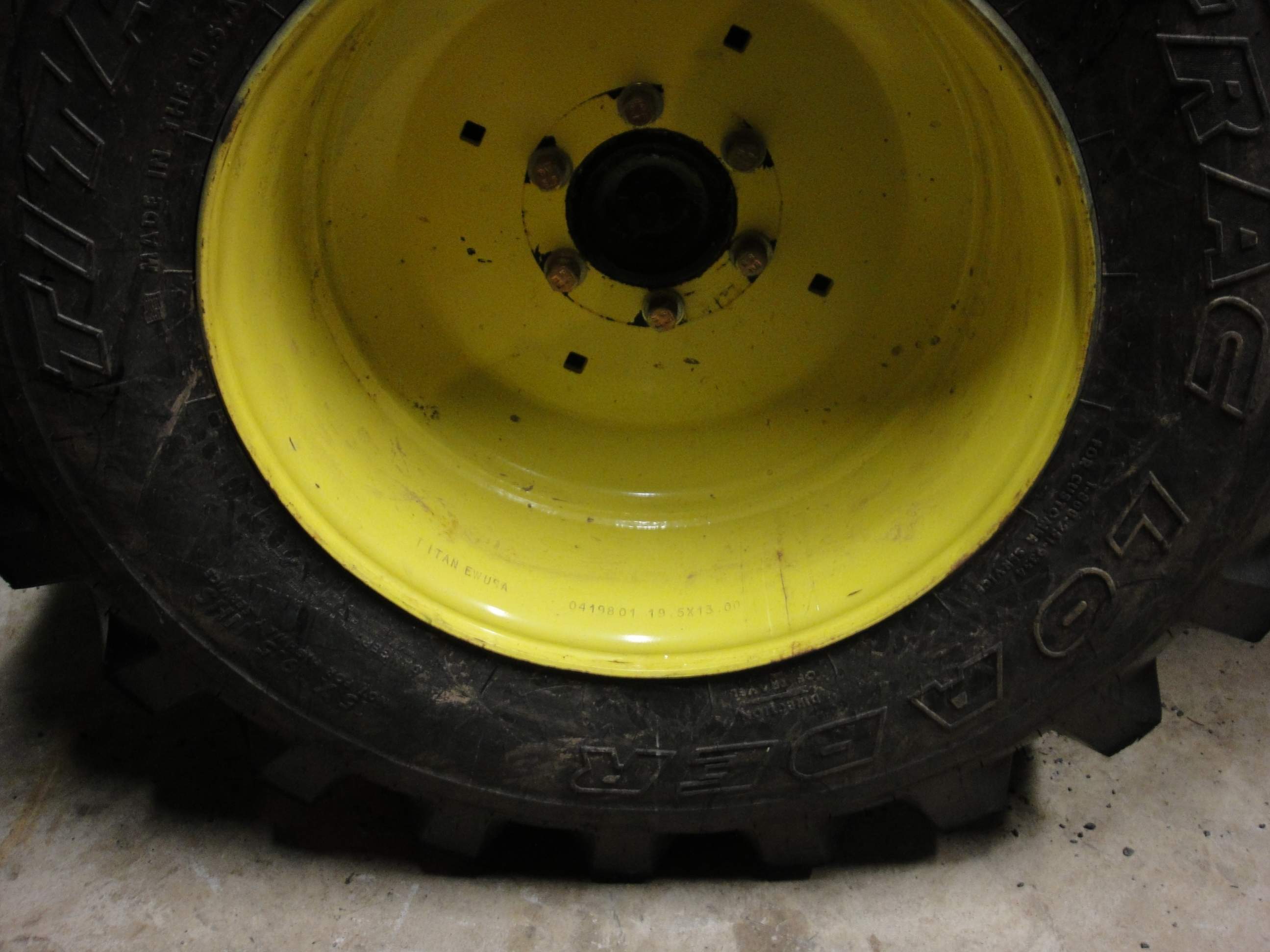

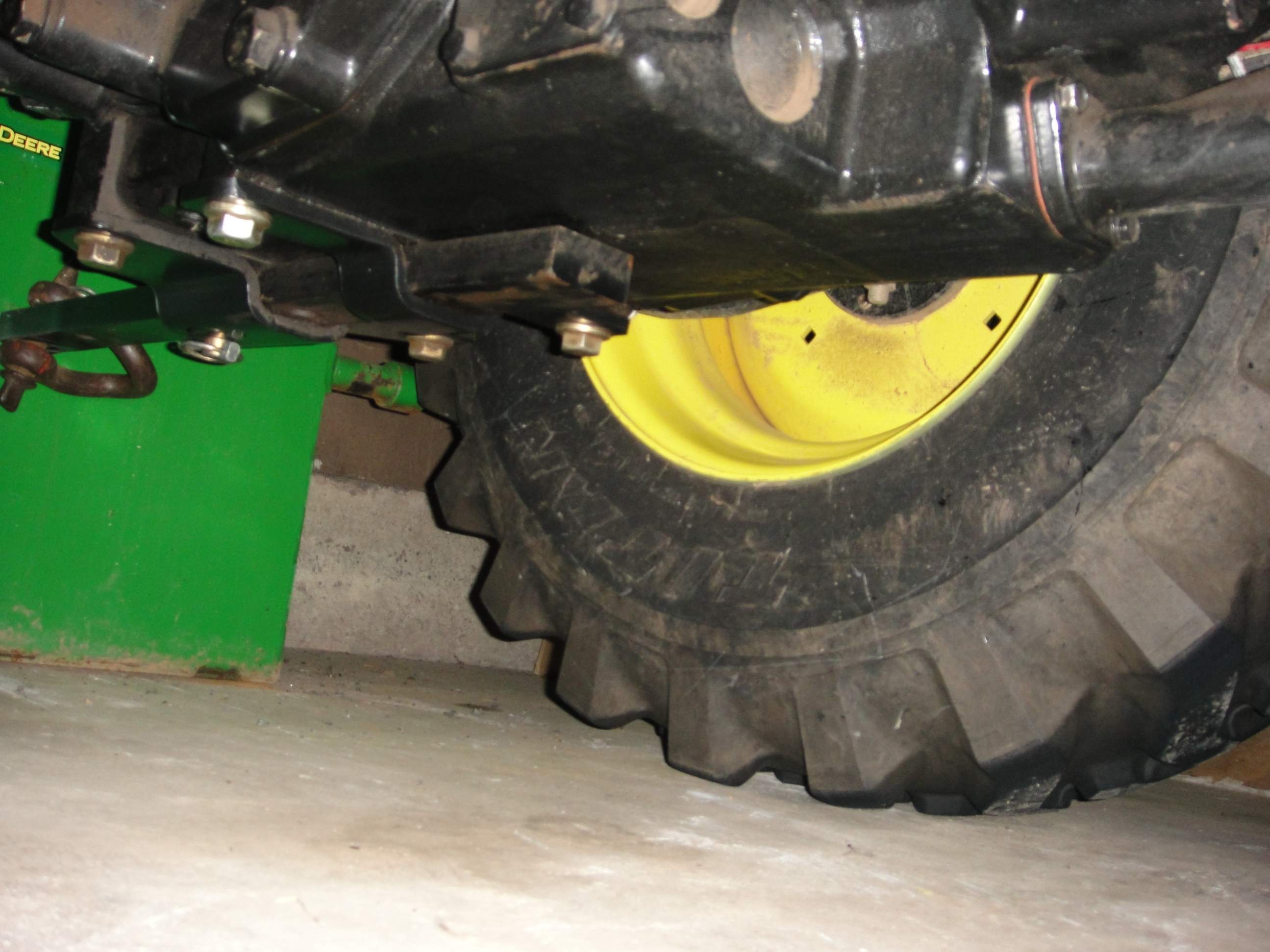

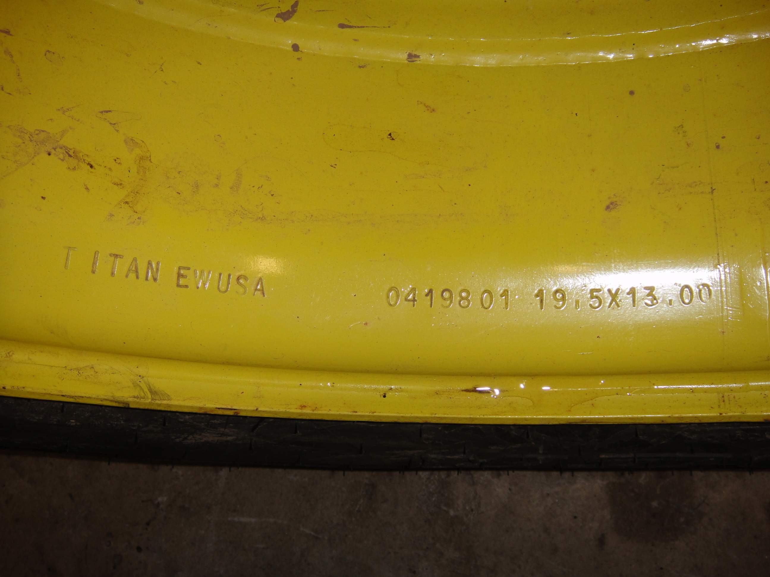

Well I looked at my wheels tonight and when the wheels are flipped to the wide position the valve stems are to the INSIDE.
Also when in the wide position the inside of rim is flat, looking from outboard, and the inside has a raised hump that goes around the inner rim.
Also when in the wide stance, wheel size and manufacturer name is stamped on inner rim, visible from outboard.
Hope all's that wrong is wheel position.
Here's some pictures
JB.

You were absolutley right even though the manual said differently. I spun them around and got the 1" clearance I needed. I also flipped the front around as I didn't want to do damage to the steering knuckle. Thanks so much for all the trouble you went through investigating the problem JB4310 . Really appreciate the help. I can always count on this site to help with my questions and issues.
