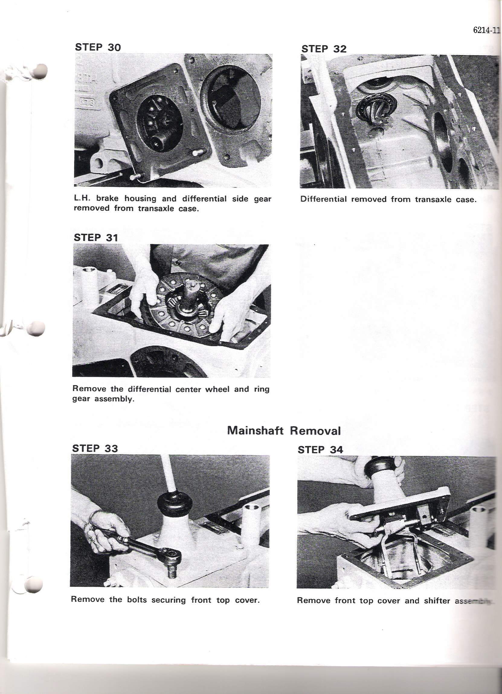

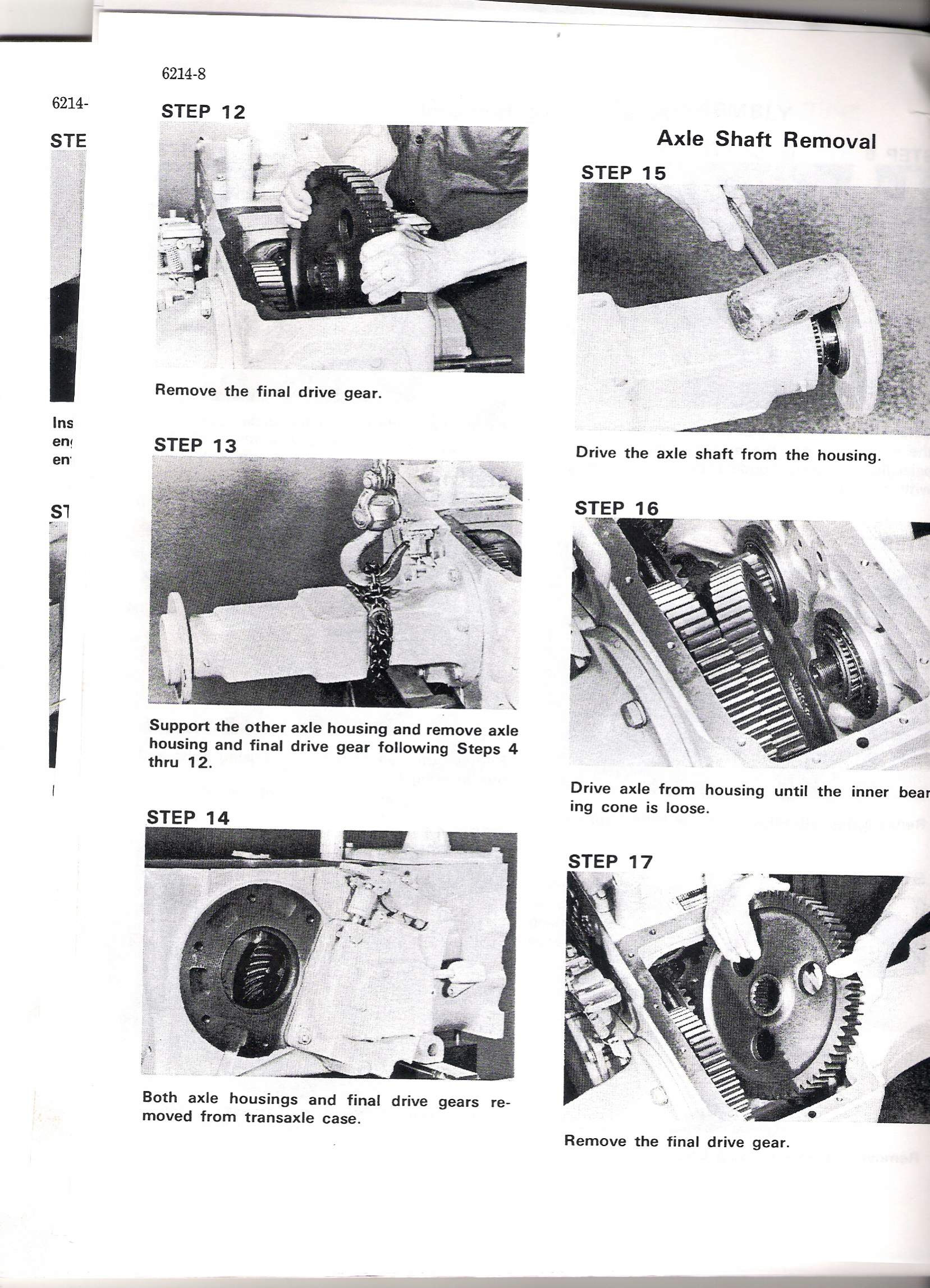

ok...I ordered a manual online... should have it in a few days...Last night I was able to get the machine up on the cement pad back by my garage, so it's in a good spot right next to the tools. I was able to move it by pressing down on the differential lock and using the right tire to get traction. The brakes for the right tire also work. However I have no braking ability for the main drive tire and she does not spin. I should clarify that. it spins kinda goes a little in the same direction as the other wheel when I have the outriggers down and the tires in the air, but nothing that would move the tractor.I think I'm starting to understand how the rear axle and differential work... I got a buddy at work that is a master mechanic that said he'll help...I'm thinking I want to tackle myself though...Thanks for the help DJ54...I'll let you know how it goes.
   / rear end brake problems #10
Does it just have a ROPS, or complete cab..?? Mine has a ROPS... I removed the right fender, tire & wheel from the side I needed to get into, and removed the floor panel(s). Held that side of the ROPS up with a chain hoist, plus an extra chain up to the I-beam across the shop as a double safety. Makes it so much easier to get to what you need to work on.
I didn't need to pull the top off the diffy though. Just reworking the brake assy's, and replaced the lines. Just made it a whole lot easier for a guy my age & size...
Do take some pics along the way, we LOVE pics..!! And sometimes help when going back together, LOL...
