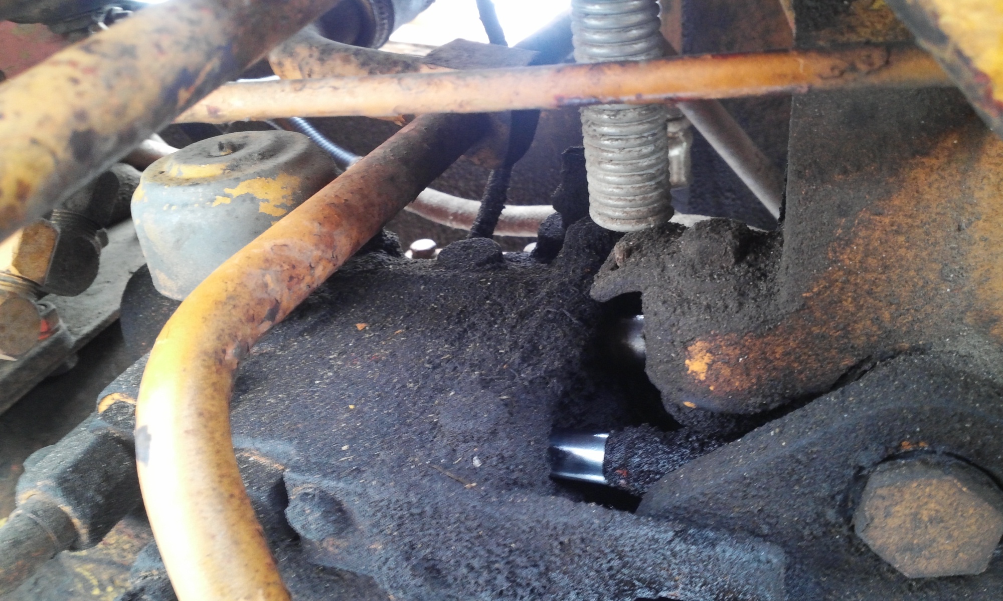

Ok if you compare the photo to the illustration you can see that my return spring is basically shot..I'm going to order a new one

That appears to be the clutch return spring, unless you mean it's not making the clutch pedal mechanism return fully right away..?? ( Does that even make sense..?? LOL) But yeah, looks like it's seen it's better days at the lower hook.
I was thinking more like the brake's not fully releasing, unless you pull up on the pedals causing your problem. If that is the case, and problem, then the springs you're looking for should be back on the second pivot/rock shaft. #'s 50, in this exploded view. Official Case Construction Equipment Online Parts Store and Parts Look Up. Parts for Case Equipment and Construction Equipment. Parts Store for Case Wheel Loaders, Case Excavators, Case Skid Steers, Case Original Parts. (Hope it loads..) So each pedal has a return spring of it's own.
I'm still thinking lack of lube on the pivot points, although the springs may be weak, or even missing. And I only say this, because of the crud & dirt I found under the floor boards of mine. That, and lack of easy access to lube those points.
If I misunderstood what you meant posting this, please excuse...

I was referring to the clutch return spring. First of all I don't think that's the original one...Second I believe the mounting bracket is upside down because the spring is too long. It also has no spring left in the spring...lol
