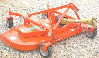

We have New First Choice (Sicma is the Mfgr. and they actually makes equipment for First Choice and Deere + more) 4 ft for $895 and the 6 ft for $1395 and shipping on either to a business in Pa would be approx $149. Ken Sweet
