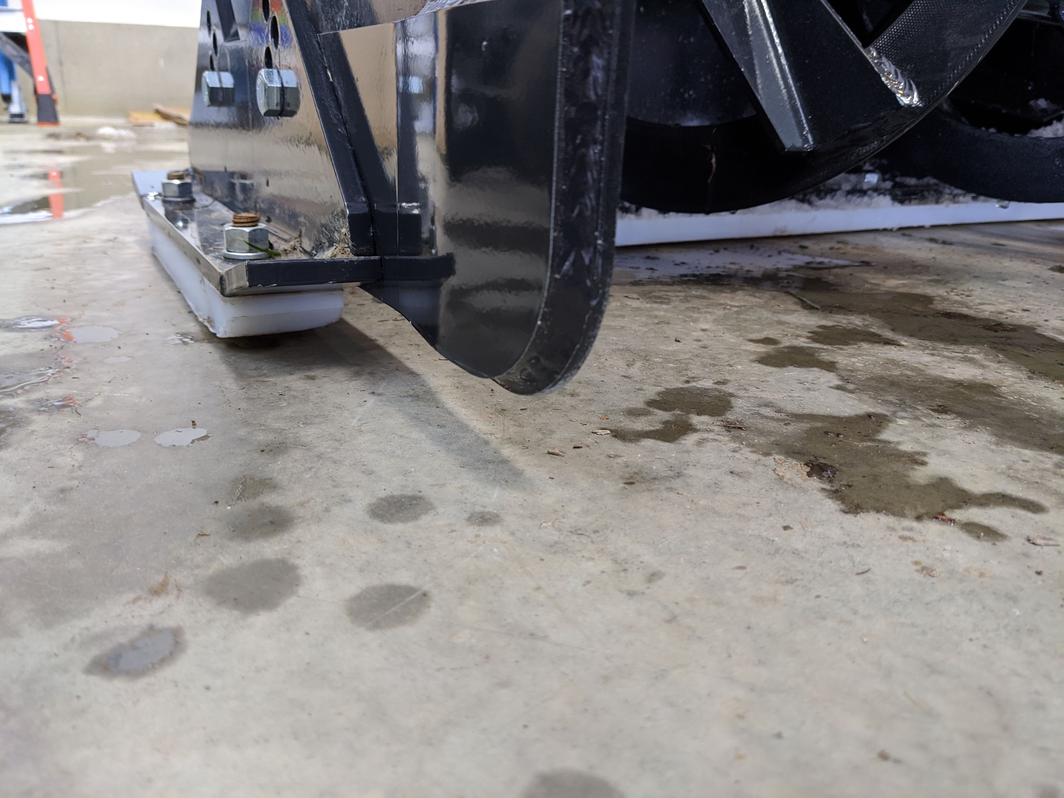

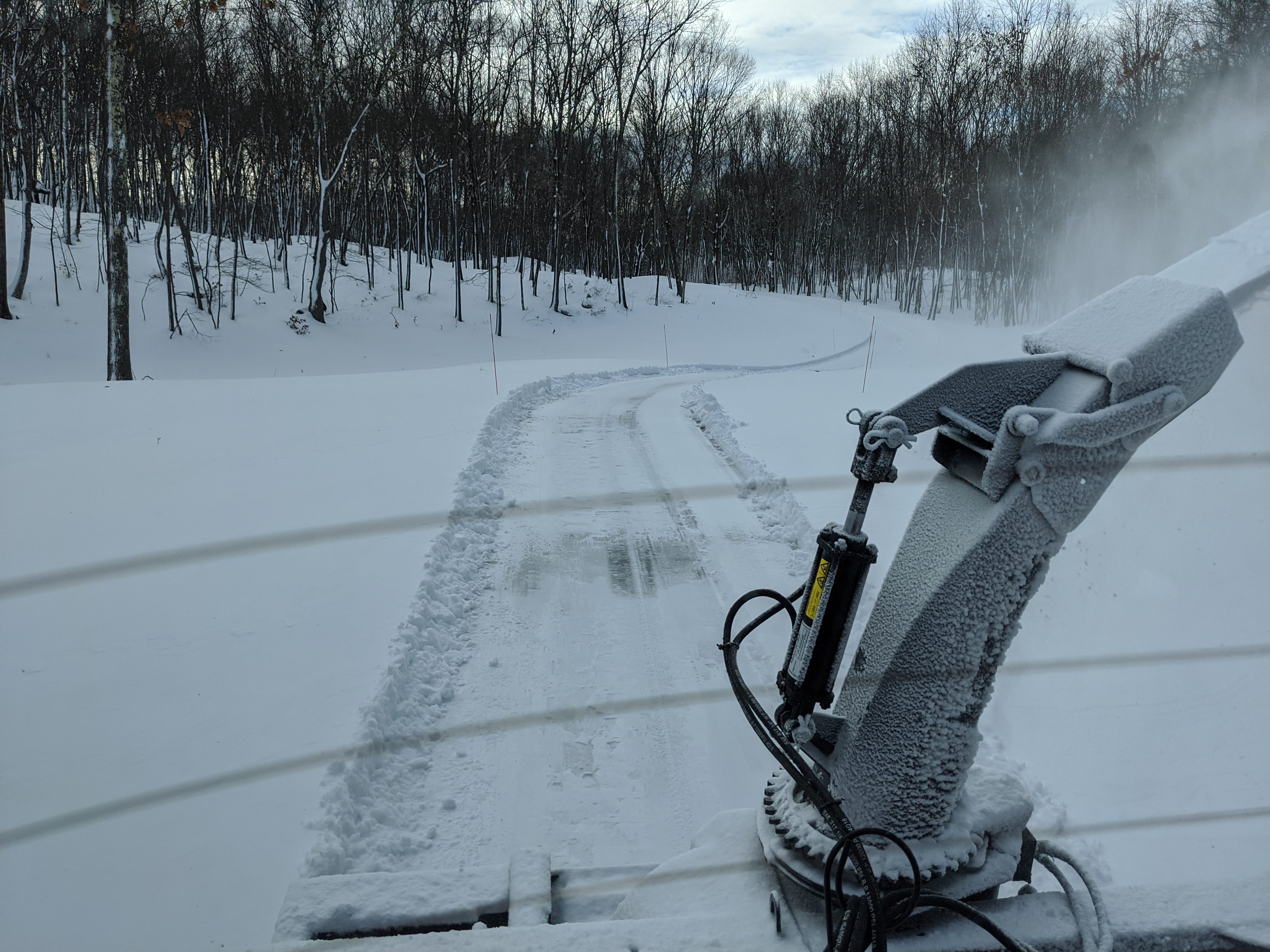

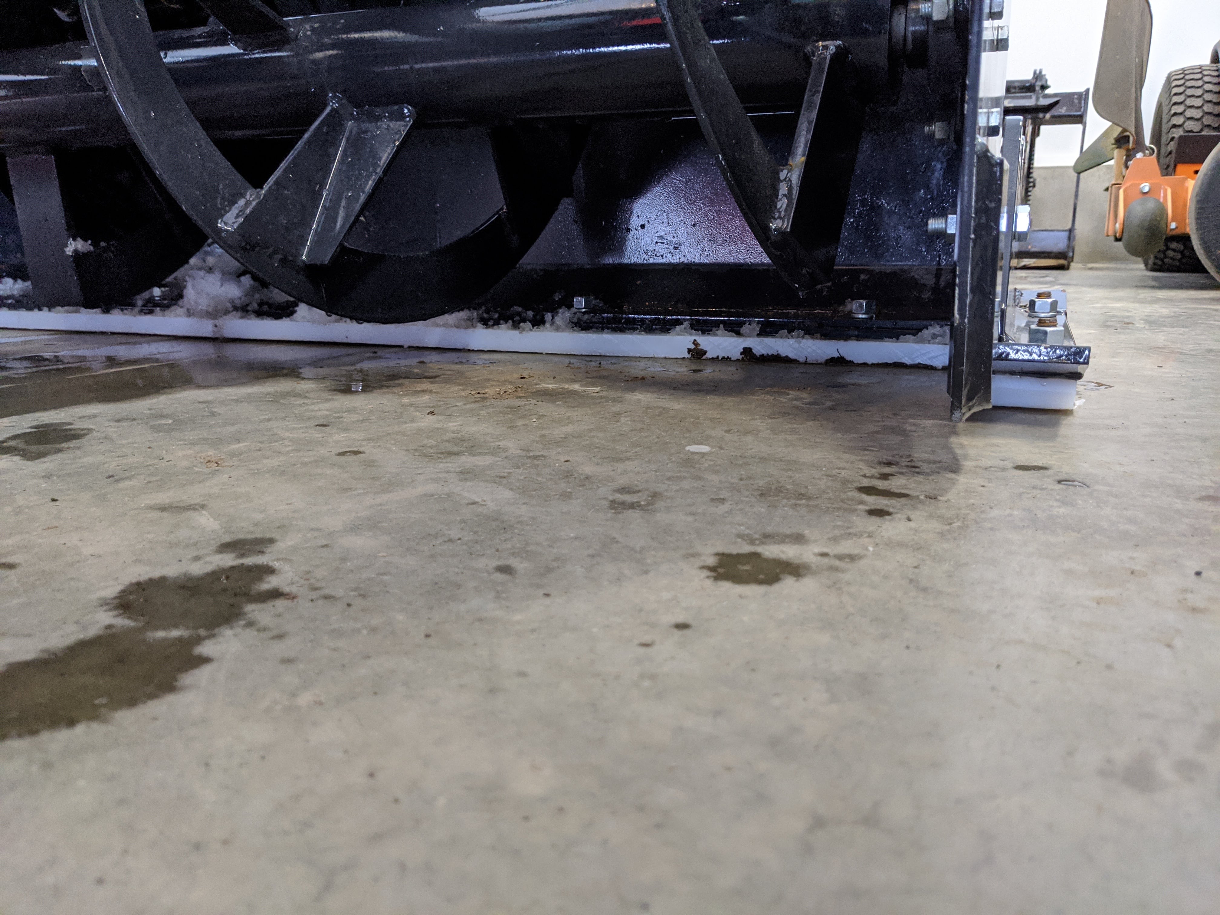

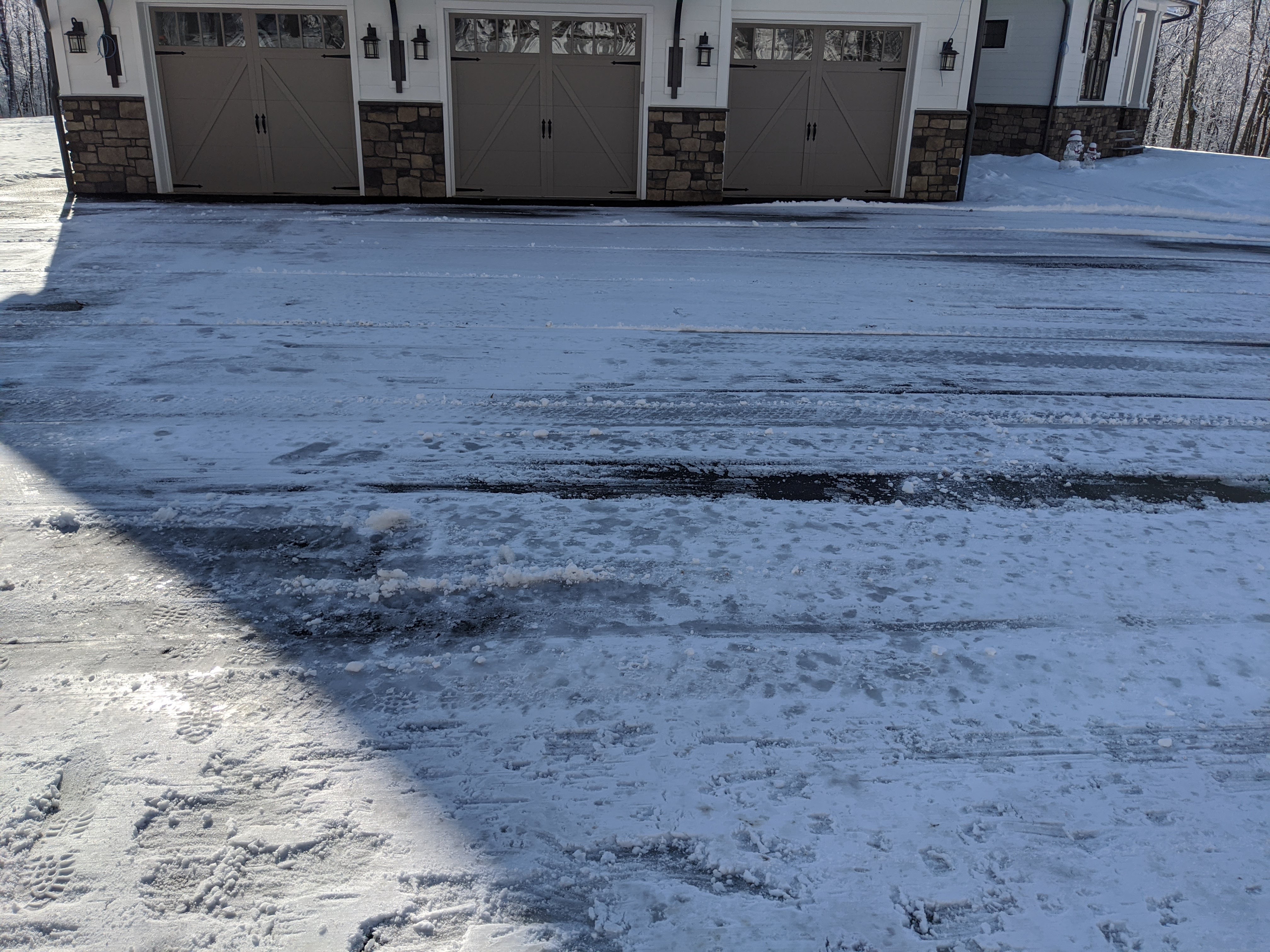

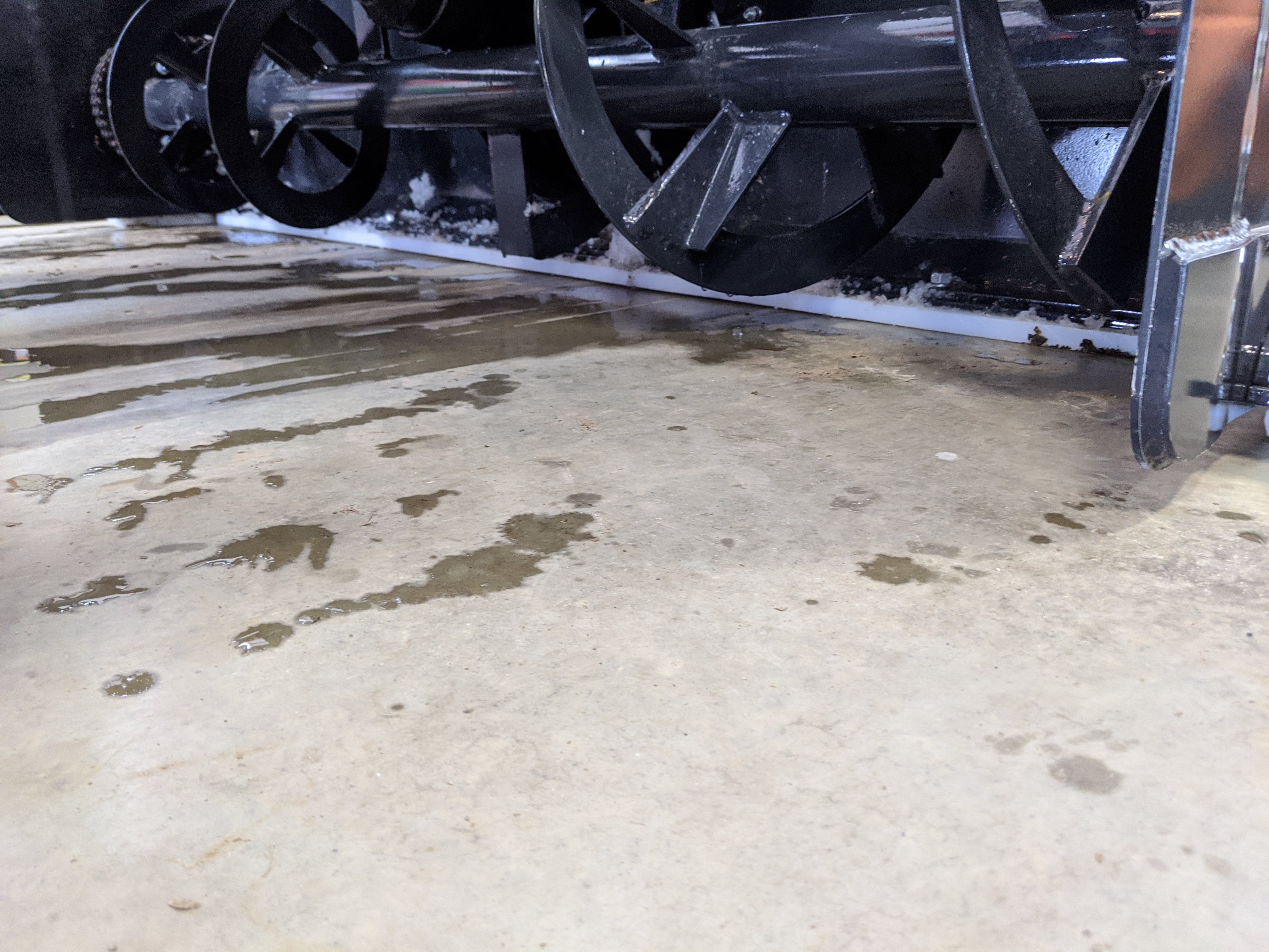

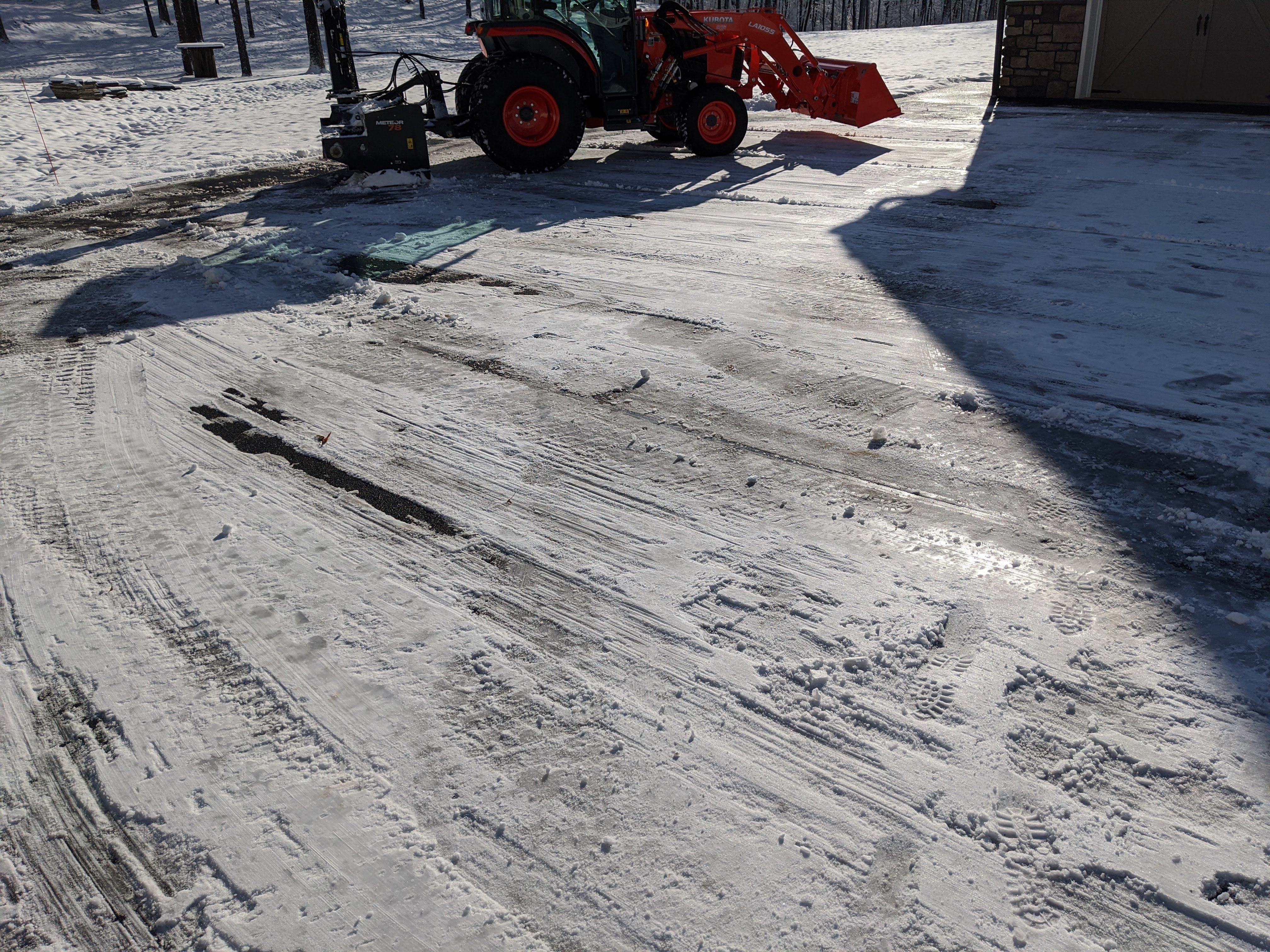

We are getting our 3rd snow event of the season tomorrow, should be 3"-6". I have been very disappointed with the amount of snow that is left behind by the Meteor 78" blower. Can't understand why the brand new tyvar cutting edge doesn't scrape good at all. The unit was installed by dealer on the tractor and appears to be done correctly. It sits perfectly level with the ground.
The only thing I can think of us that since the tires obviously pack down the snow creating tire tracks, the cutting edge has no choice but to be up however much the section packed down by the tires is. If the tire pack is a quarter inch, then that becomes the lowest point the cutting edge can go. Even though there is several feet of unpacked snow in between the tire marks, the edge cant get it because its now riding on two raised sections created by the tires. So the whole unit glides along hovering above the clean asphalt that it should be scraping against. This sucks. IMG_20191203_093300.jpgIMG_20191203_101645.jpgIMG_20191211_102235.jpgIMG_20191211_102237.jpg

Can't you adjust the shoes up a bit?
With that said though, what your pictures are showing looks fine to me.
   / Rear Inverted Snowblowers 2019
#140
I don't know if these shoes can be adjusted. I was wondering if maybe I took the shoes off and just left the long cutting edge on the bottom, maybe that would work better. Perhaps the side shoes are causing the unit to ride up on the packed snow?
