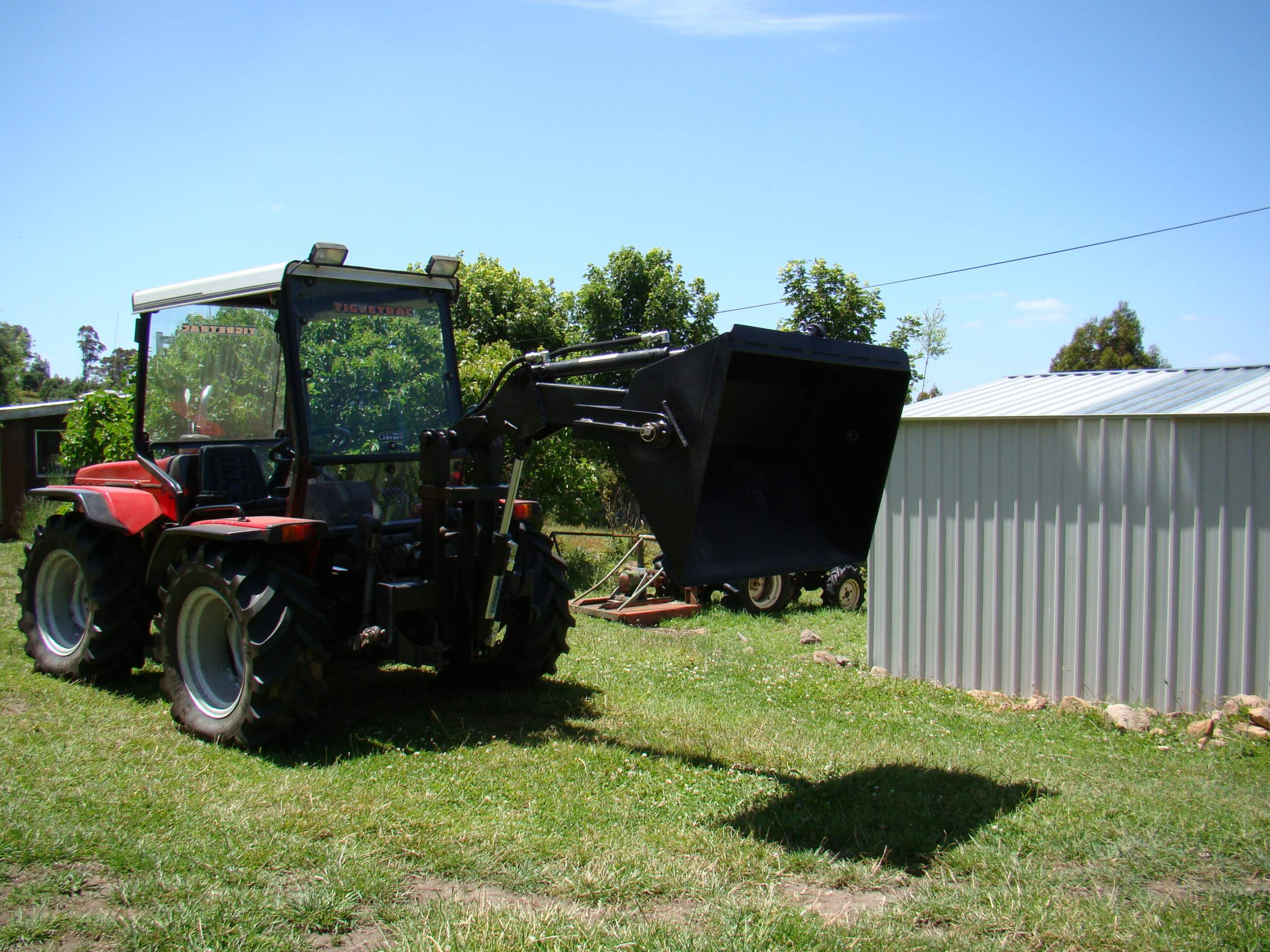

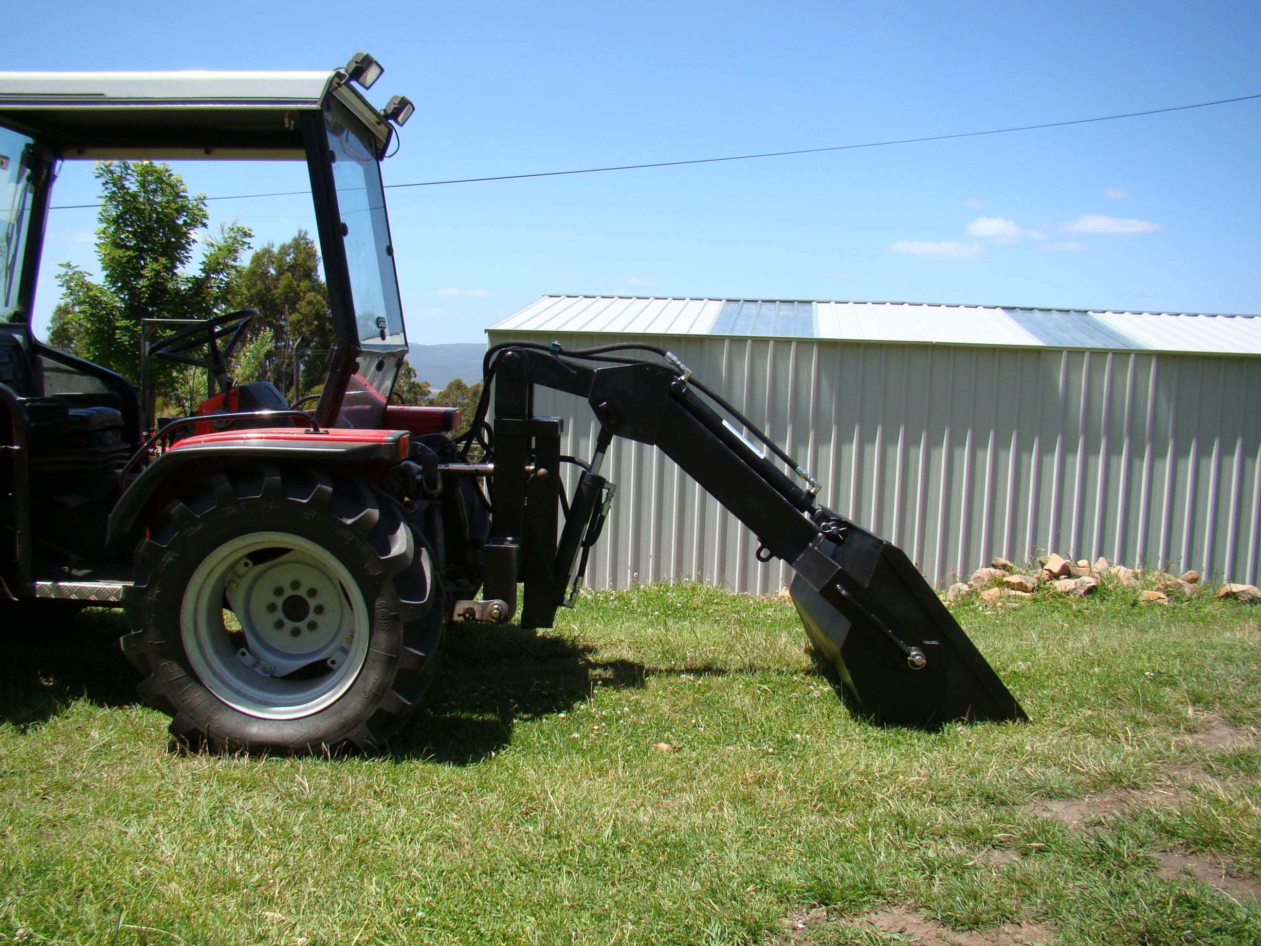

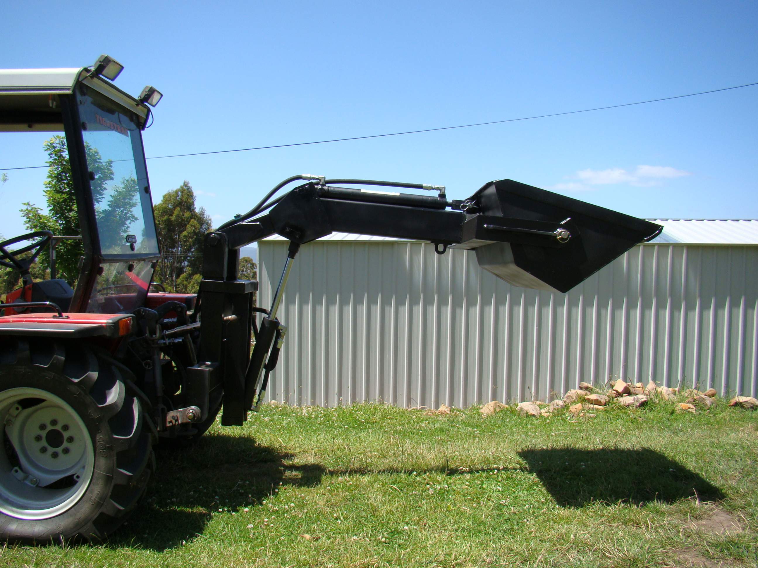

I made one myself and it worked suprisingly well, better in fact than some front loaders I have used on 2wd tractors. The best part about it was that you gained traction as you filled it. I simply attached a 3-pt lift boom to the tractor, and hooked that onto the top link position of a pond scoop. I ran a couple pieces of angle iron as extensions on the lower links to make those hookups. It really worked good for loading a manure spreader, but I also used it occasionally for loading a small dump truck with topsoil, and a trailer with stone. I had to put some weight on the tractor's front bumper for counterweight, and when I tried it on my Ford 8n, it could only lift the empty scoop. My front-weighted Ford 2000 would lift about 1/3 yard of topsoil however. It sure worked a lot better than a shovel or pitchfork. I only used this contraption when I had to lift to a significant hieght such as onto a truck, trailer, or spreader. The plain pondscoop without the boom was faster for just moving stuff around. Since getting a 4wd tractor with a front loader, I got rid of both the scoop and the boom (gave them to my dad). You are right that a tractor without a front loader is much more manuverable in tight quarters than one with a loader. A good feature of my rear loader was that it went on and off as fast as any 3-pt implement and it didnt cost me a dime as I already had the two implements that made most of it. It served me very well for about 10 years.

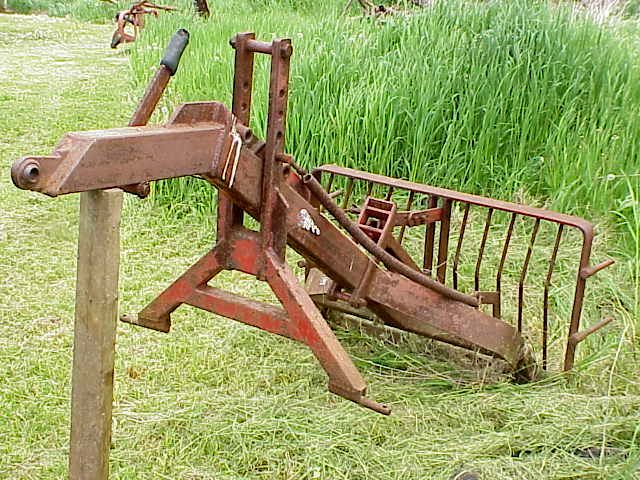

Warratah in Australia made one, Then later Hooper thats a trip type but has a scissor boom. Ive made a few copies of them for my customers. One can be made for about 150 if you have a good source of scrap metal. You can do a google on rear loaders or linkage loaders as they are called in Europe. Westendorf makes one called Autodump, then theires Negrisolo, Then Forano is an old scissor type. And the old Dearborn rear loaders I have all but the boost cylinders to one of those. I also know a man that had one he made like a hay scissor that he put a bucket on and used it on a 3930 Ford to dig a hole to put a 2 ton log truck into so he could load with another 3 point scissor.
The version of scoop I made for my tractor at work was more like a combo of the Cad loader and the Negrisolo rig.
im posting a pic of the Hooper scissor lift scoop
