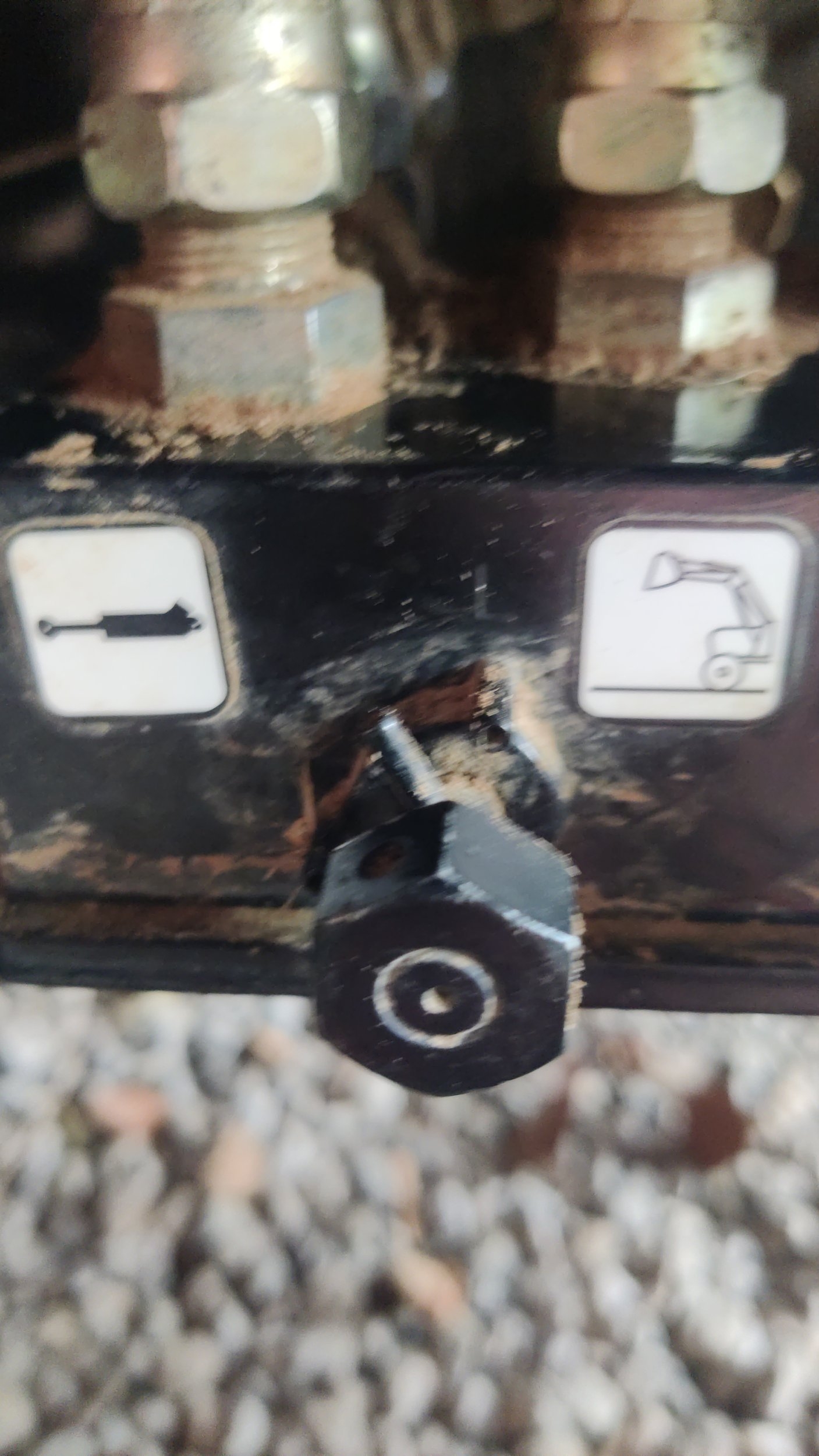

I'm going to assume that you have that knob underneath where the lines connect turned all the way Clockwise ...which is pointed up just as this old thread says:
Not that that knob matters to the 3pt. It works the same either way,

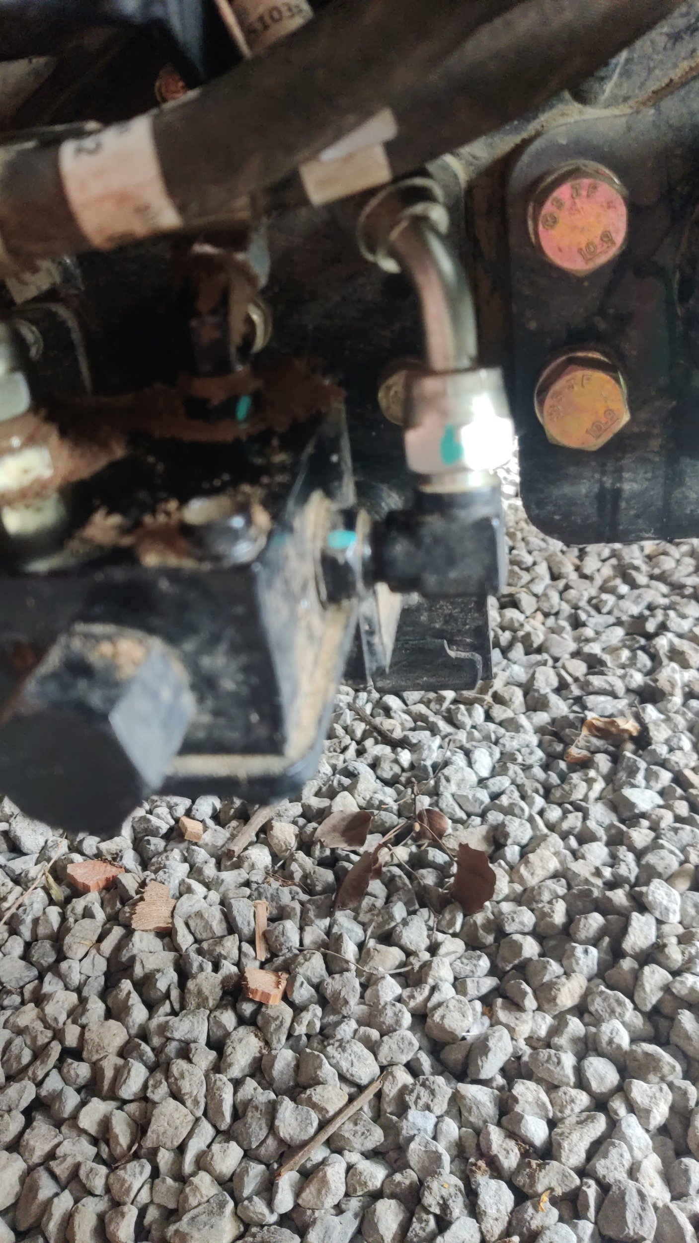

Thanks for the response...
When I first looked at the knob before I touched anything (after seeing the issue) it was 2/3 to the right (FEL). I have tried turning it all the way to the right and left and eventually put it back where it was I did the same with the knob under the seat. Probably just introducing more variables.

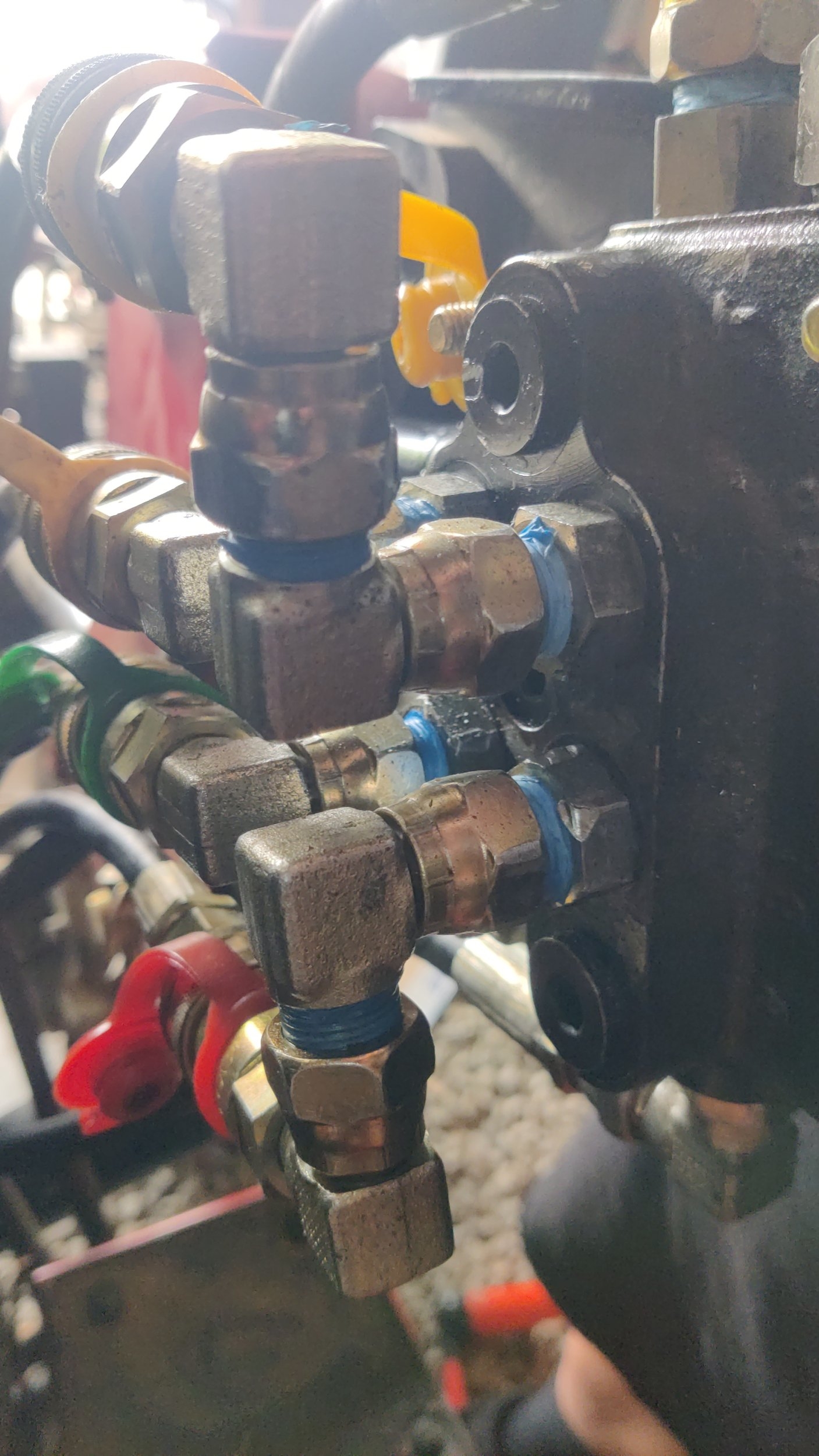

In the pics, on the control stick I see a P at the bottom, B1 and B2 and then what looks like C and T at the top.

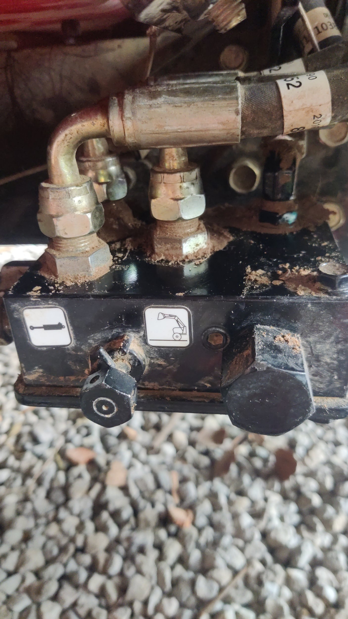

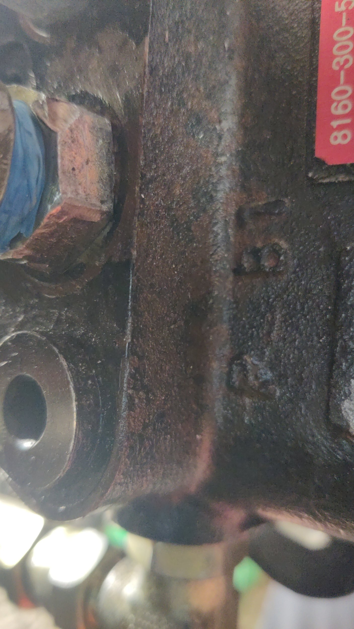

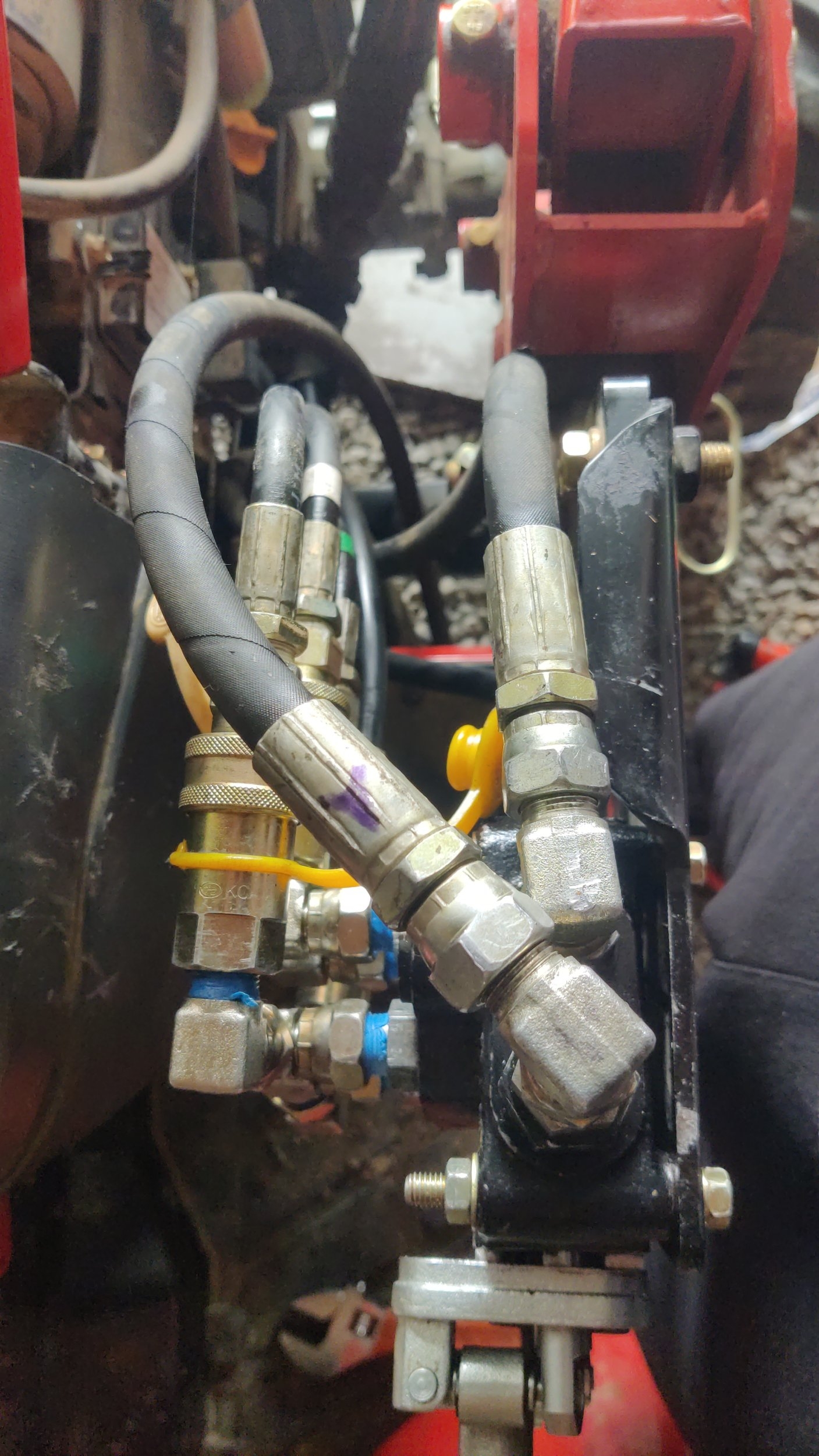

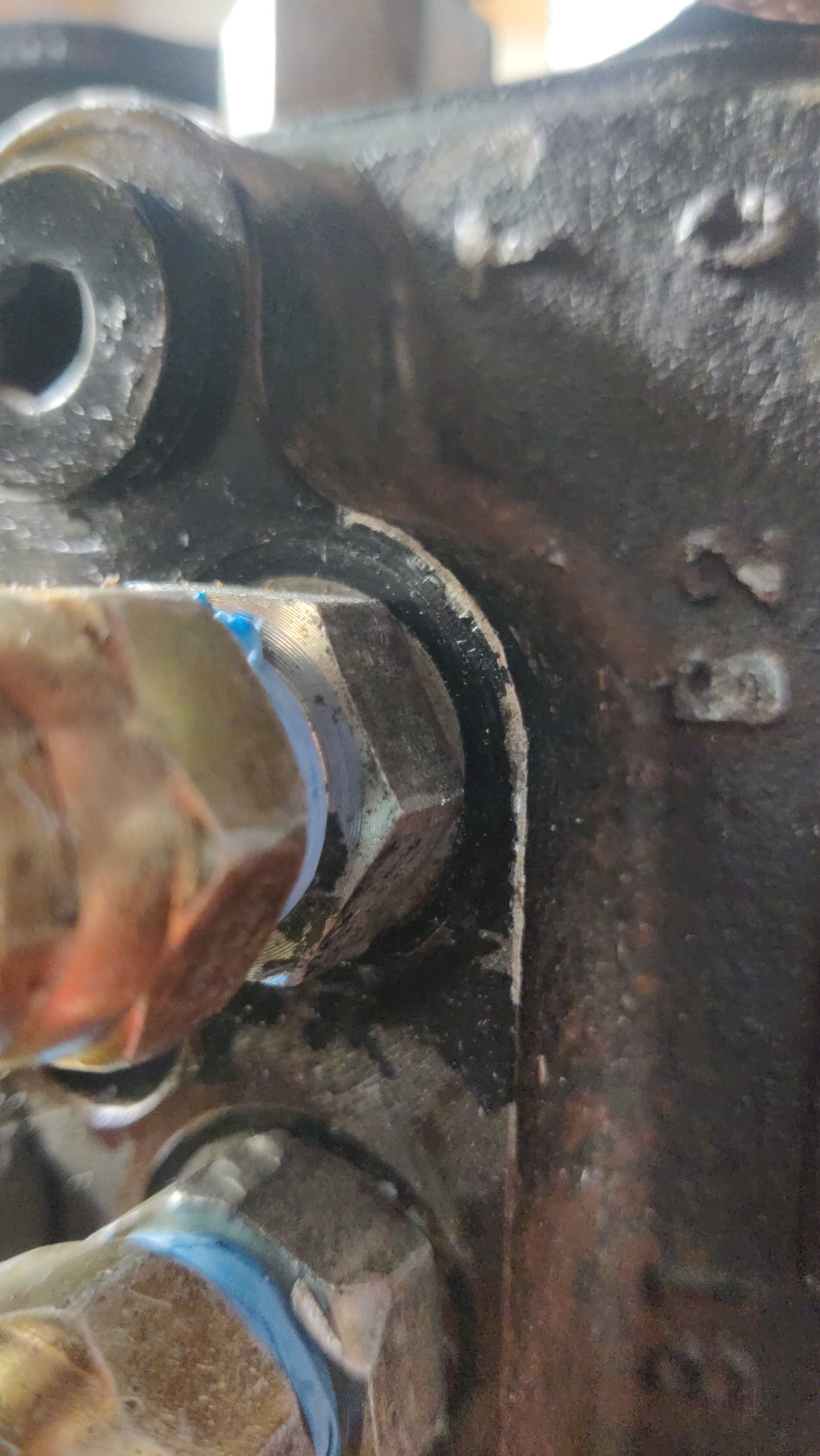

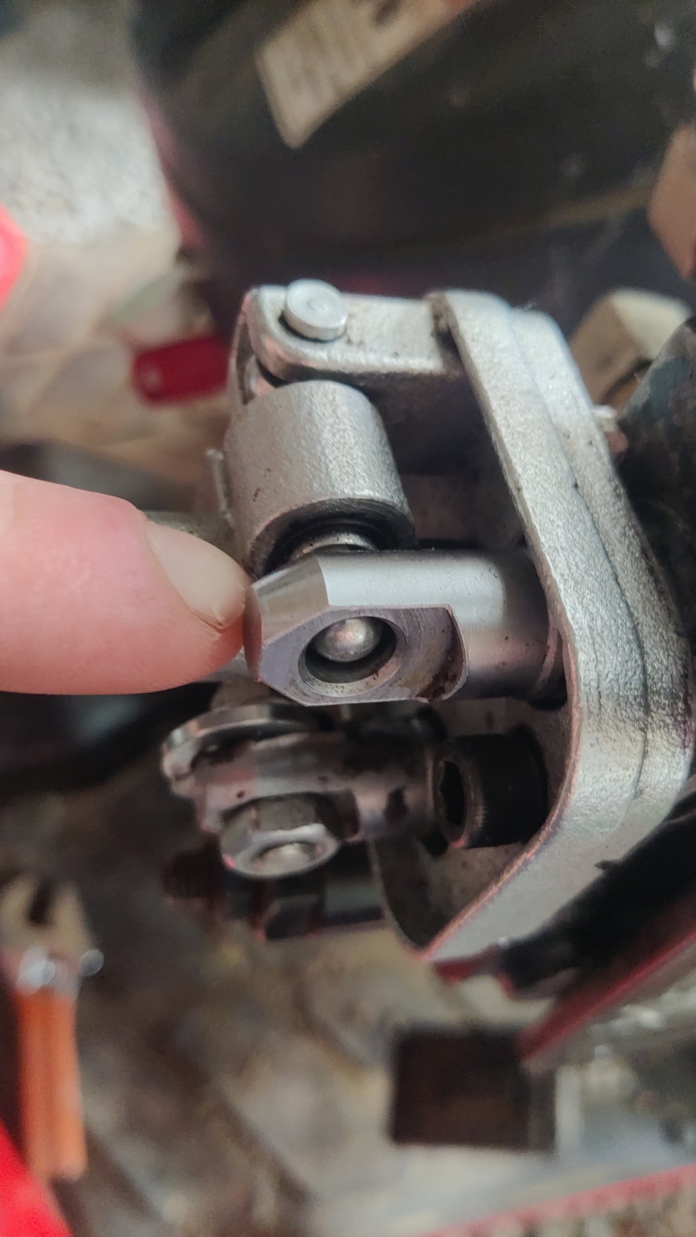

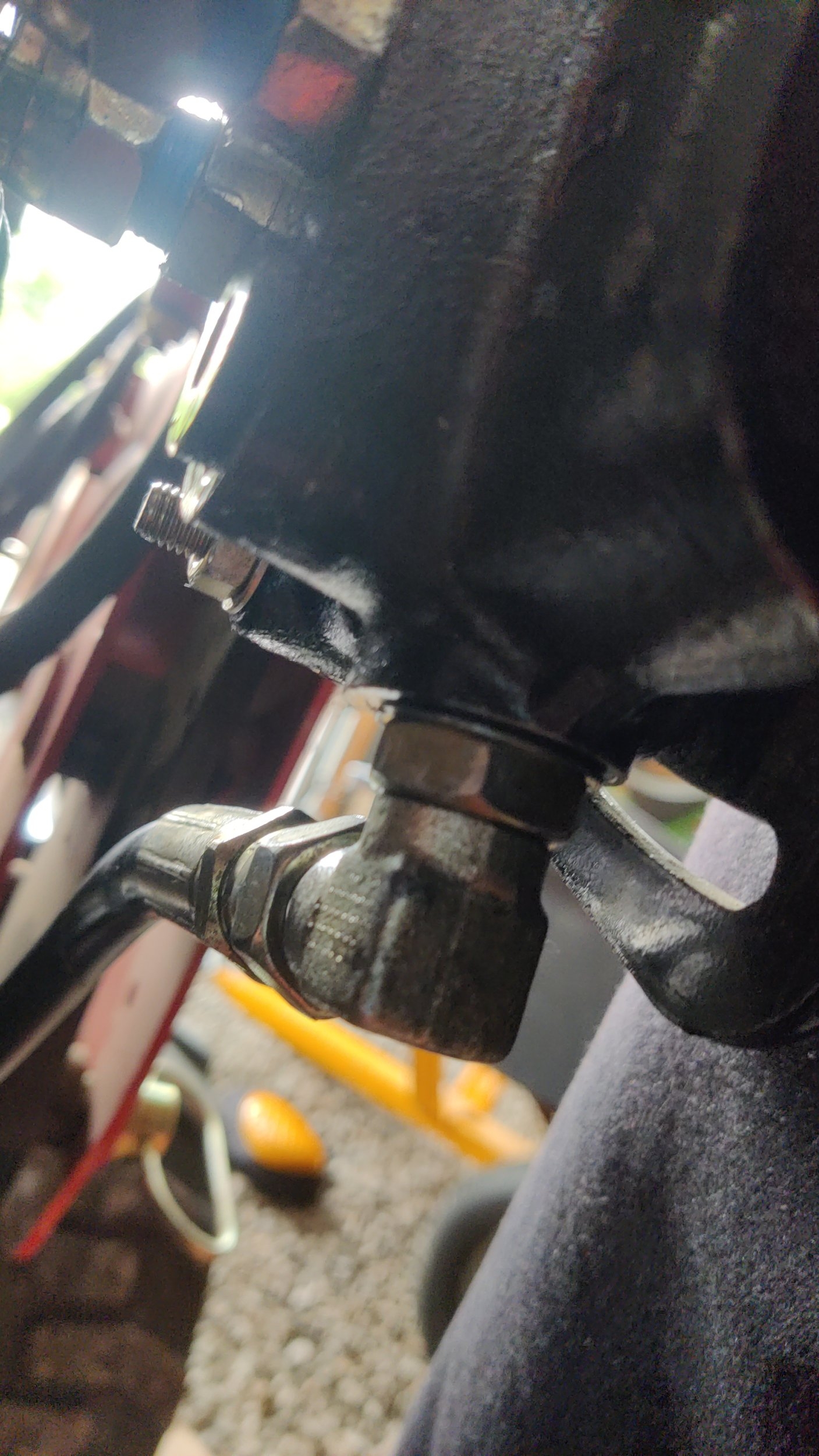

I'm not sure what you mean about the quick connect. I did take off a couple of the quick connects from the elbows when I had the FEL control stick box on my workbench but don't remember seeing anything fall out. Then again my bench is a bit of a mess. I popped the 4 middle hoses off the quick connects, removed the top 2 and 1 bottom hose and took it my bench to replace the little silver box the stick screws into then put it all back on. didn't start it while it was apart.
I talked to the local RK tractor guy and he gave a few suggestions and then basically told me he didn't know. Little frustrating.
if I do the bucket method (you guys had me do) and get the arms up, let go of the hitch lever I can stand on the arms and they hold. I'm a 280lb guy. If I stand on them and pull the lever to raise they fall under my weight.
maybe the pics will help? I did notice one of the pistons for the FEL loader stick sticks a bit but the bucket operates fine raise, curl, ect. No issues with trans or steering, seem to be fine and strong.
Hopefully I make sense with all this stuff

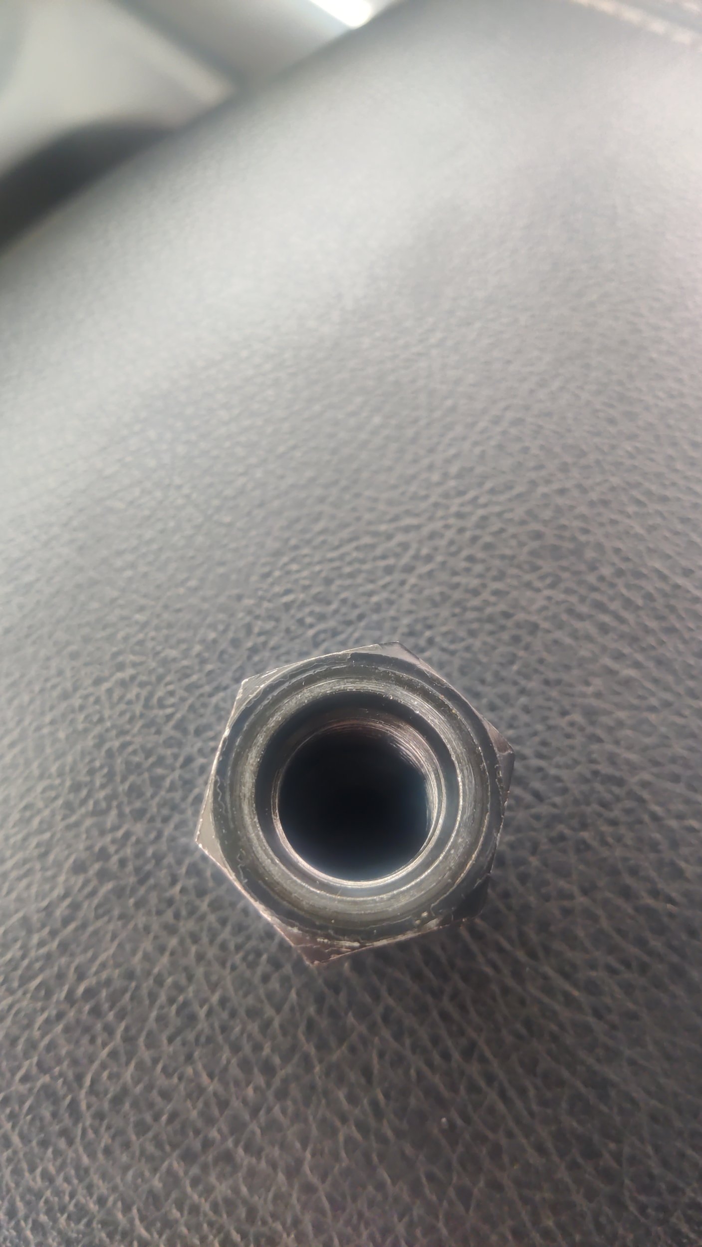

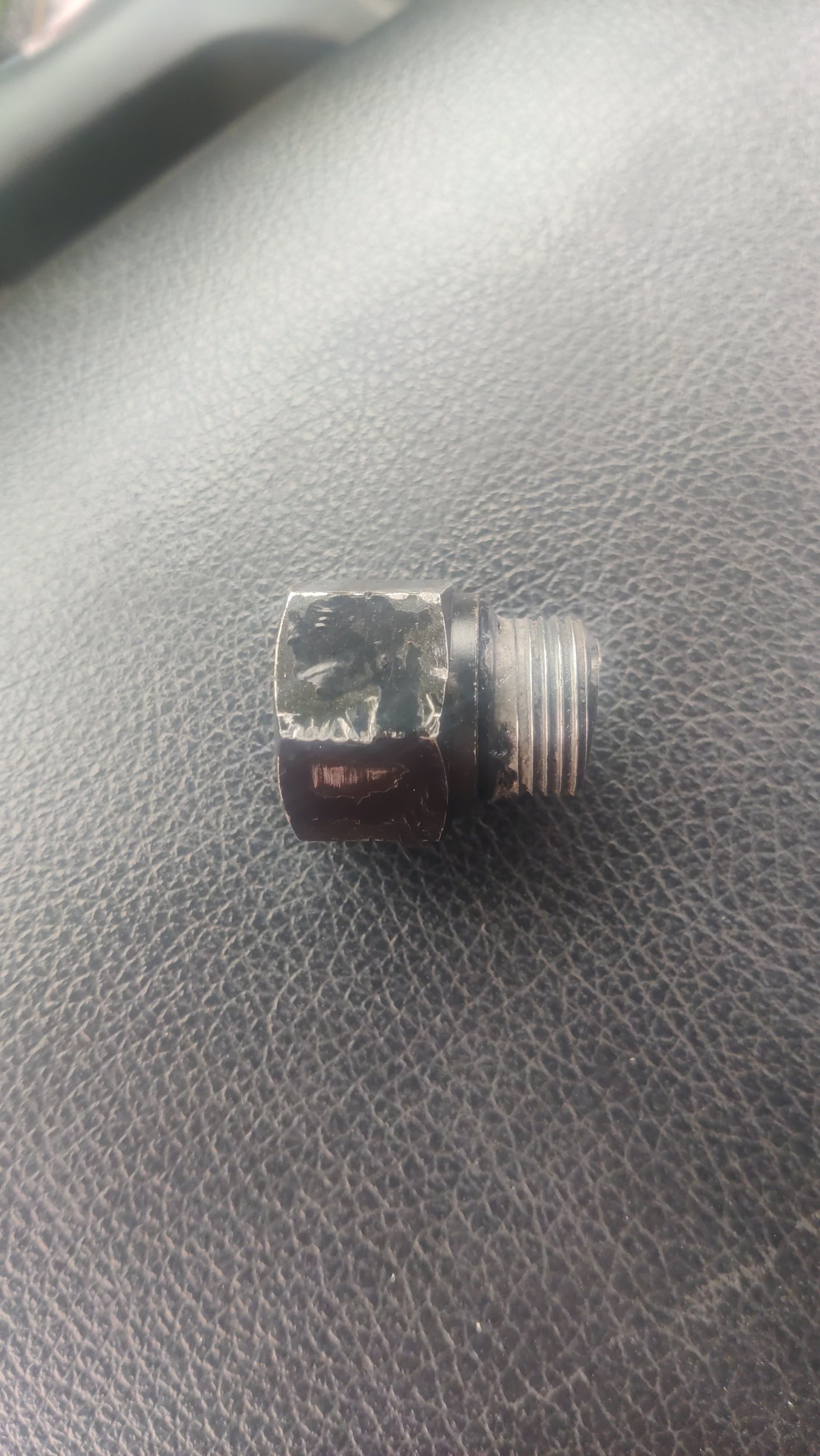

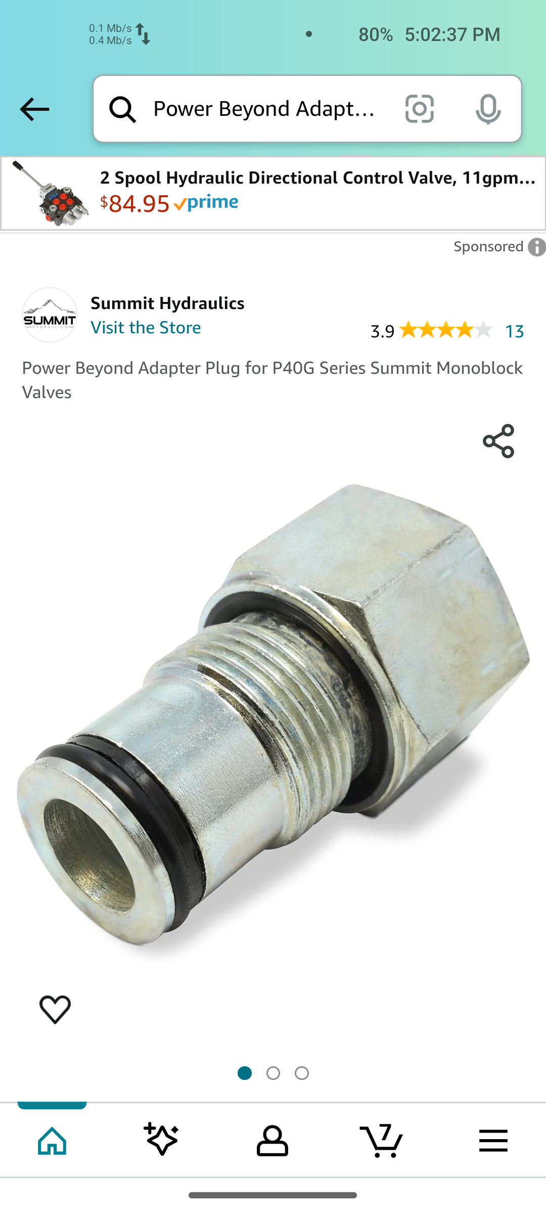

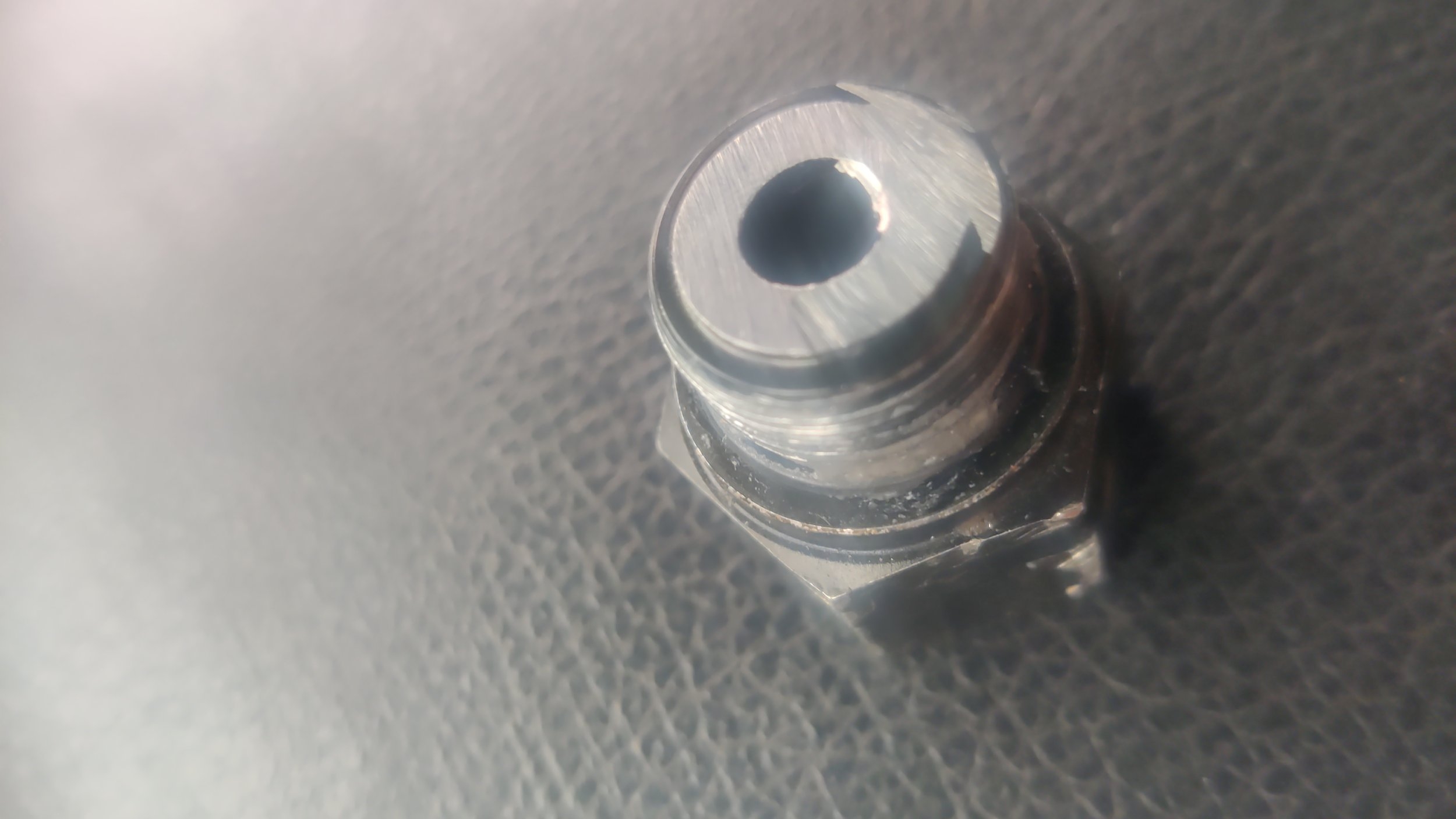

I just realized something and I have to apologize I bought a replacement controller on amazon but the power beyond fitting didn't fit I was in a rush and cut the tip off to "make" it fit it was an o ring that no longer exists. would that be the issue?

   / Rear PTO hitch very slow, weak post maintenance #19
There is your issue. This would cause the same symptom of reversing the Tank and Power beyond hoses.
The Power beyond sleeve is specific to the valve brand. They don't interchange with other valves. You need to get the right sleeve for your new valve.
   / Rear PTO hitch very slow, weak post maintenance #20
I just realized something and I have to apologize I bought a replacement controller on amazon but the power beyond fitting didn't fit I was in a rush and cut the tip off to "make" it fit it was an o ring that no longer exists. would that be the issue?View attachment 873990
Yep. That's the problem!
I'm glad I mentioned that PB sleeve and hope that is what joggled your memory. When that sleeve is intact - and not hacksawed off !! - , the sleeve fits into the Power Beyond port of the control valve assembly and diverts a high pressure flow back to operate the 3pt hitch lift.
By cutting the end off, you diverted all of the pressure directly into the return hose.
It was exactly as though the PB and Return hoses had been reversed.
The question is what do we want to do about it?
DId you buy a complete controller to replace the old one? If so, can you get a power beyond sleeve for it? The sleevers are very specific to each control valve set as you found out.
