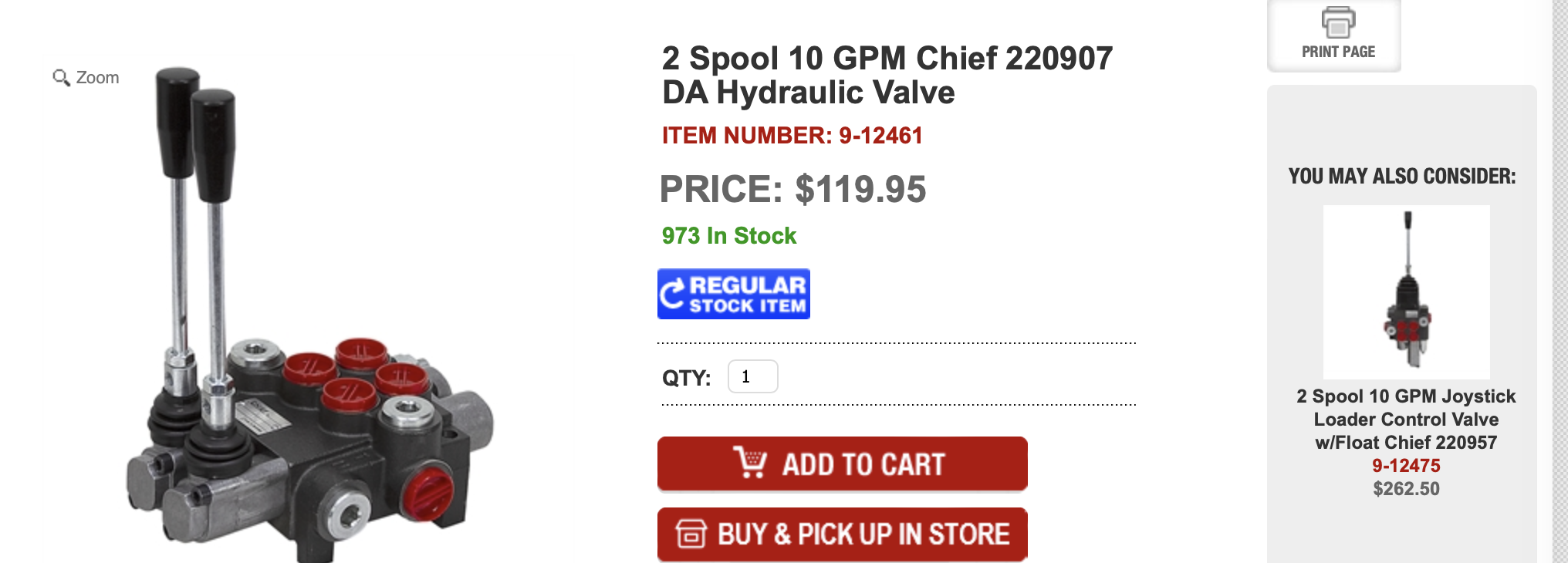

It's up to you if you want a direct replacement for $550 to $1200.... A lot of people don't know that they can buy a higher quality two lever type with the same hydraulic specs for $300.
For me, paying a higer price for single lever "convenience" in a lower quality valve wouldn't make sense. your choice.

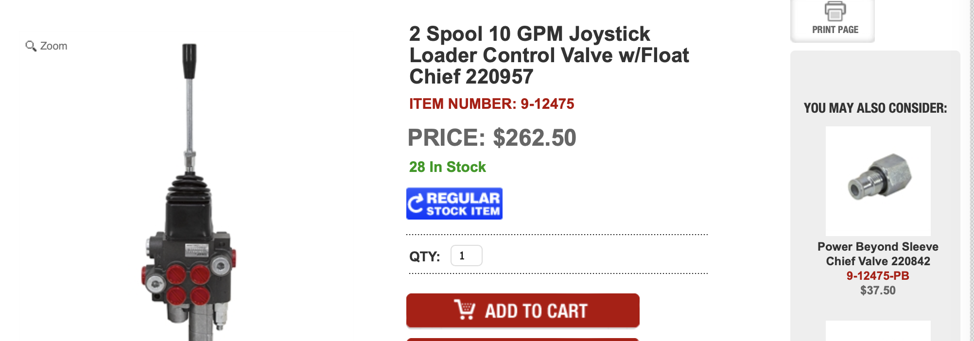

Here are some more options that I think will work:
Screenshot 2024-06-06 at 1.49.52 PM.pngScreenshot 2024-06-06 at 1.48.37 PM.png

Does anyone know where I can get the power beyond adapter? its a samwoo model valve control I'm afraid to start spending 30-100 dollars for things that won't work I have emergency cash but this does not meet our definition to use that to get a new control, but i make reclaimed wood tables and might have an order soon so I may make enough to get a new loader control. I think the one I bought is too big
