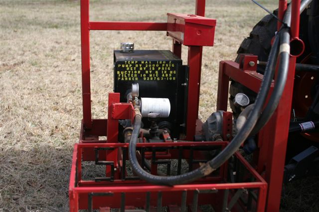

Have you made any progress in your thoughts regarding building a pto hydro system for skidsteer style attachments?
I was talking to a rep at Erskine today about that very thing, since I want to use their hydraulic front mount snow blower rather than the long shaft pto model. I suggested that they develop a turnkey product to provide skidsteer hydo capability to tractors.
I was thinking about setting up a system on a 3 point carry-all to include the 25 gallon resevoir, pump, hoses, etc.
The idea of opening up the utility of skid steer attachments for the tractor is enticing.
I've been thinking along the same lines as you RFB. Please post pix if you start building such a pump setup for a snow-blower, etc.

Here is one I did a few years back to power a rotary cutter on the FEL
   / rear pto hyd.pump #14
OOPS. Here it is, I think.

Farmerford,
Sir,
That is right in line with how I envision the project. Can you elaborate on the setup including any potential problem areas?
Added: I found your older post with photos and am perusing that. Will followup after I brain stew what I read.
thanks very much for the direction.

If you build something like FARMERFORD's, you might also consider
incorporating some ballast into it. Maybe cast the base out of concrete?

Kind of funny; all day I was thinking of your ballast question and I thought: I can make a cast concrete ballast with a horizontal draw bar with integral pins, and a top link attachment point) as ballast for the rear of the tractor and to function as the pump system platform. My next thought is to also cast embedded bolts into it and then cover the top of the concrete with marine grade plywood as the work platform.
