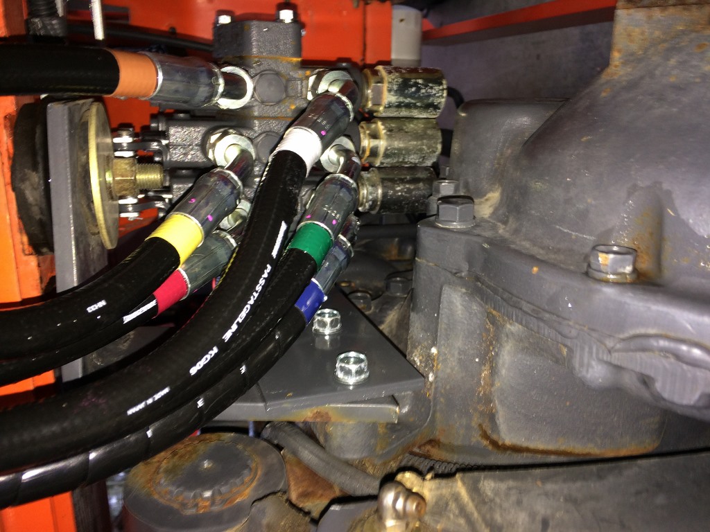

Back of the valves. Harder to see than Buckeye's because of the hoses. But you can see what I mean about attempting to tighten those 22mm collar nuts! :mur:

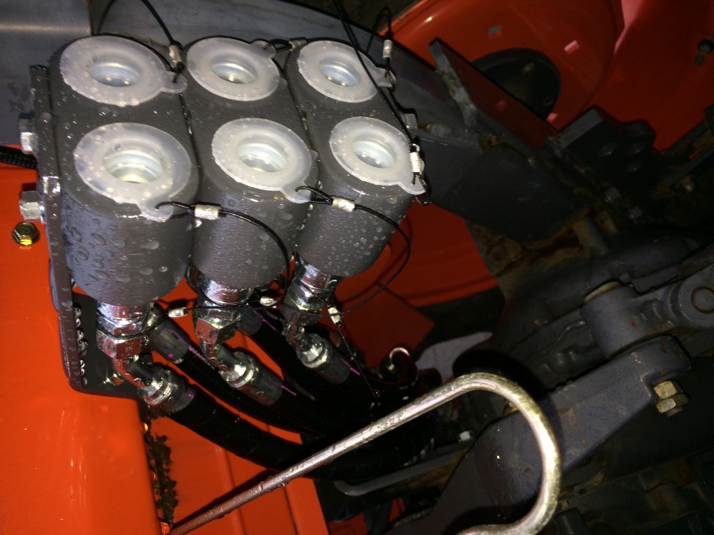

Bulkhead/connectors/bracket. All the holes for everything were pre-drilled and all lined up with some persuation. NOTE: if you let the little dust cover retainer cord get caught around one of the bolts holding all the remotes together, and then tighten said bolt, it will bite through your little cord like it wasn't even there.

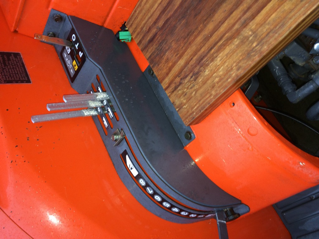

Levers and cover reinstalled. Still have to add the knobs.

Uninstalled the 4 outboard hoses, tightened the inside 2 as much as I could get on them, then reinstalled and repeat for the middle and outboard valves. This is where having the right rear wheel off would have been handy. I'm guessing my forearm will be bruised up nicely from being smashed in between the tire and ROPS.
Started her up and - NO LEAKS! I was pleasantly surprised given my inexperience with anything hydraulic. I briefly cycled each valve all the way through it's range, including float/detent. The two rough ones smoothed up nicely. It is obvious that they are all pressuring everything up each way because the hydraulic pump very quickly and audibly goes into relief.
