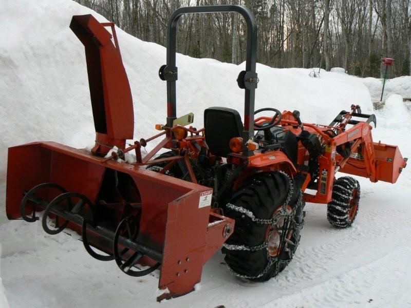

Sorry for the delay John but I wanted to try the snowblower a few more times before giving you any feedback.
So far I have been really happy with the purchase.
1. The rear B2789 (51 inches) is a good fit for my B2320, The HST works great with the indefinite speedcontrol to adjust for the snow quantity. I usually use Low range and don't have to slow down unless it is really wet and heavy.
2. The manual chute works good for what I have to do (about 300 ft of driveway). An electrical or Hydraulics chute rotation control would be a nice add-on (maybe later on).
3. There has been a lot of discussion about shearing pins on this forum. So far so good, the manufacturer pins have held on. Mind you I did not go through branches or anything like that and I have an asphalt driveway. I also always engage and disengage the PTO (clutch in) at low RPM to prevent big loads. I clean the excess snow with a broom when I am done to prevent snow from freezing and jamming it the next time I use it.
4. The throwing capacity depends on your chute angle and type of snow. At 540 RPM which is around 2800 RPM on my tractor tachometer (basically almost my max since it stops at 3000) I can throw dry snow a good 30-40 ft.
5. Nothing else to report so far. No breakdown or anything.
