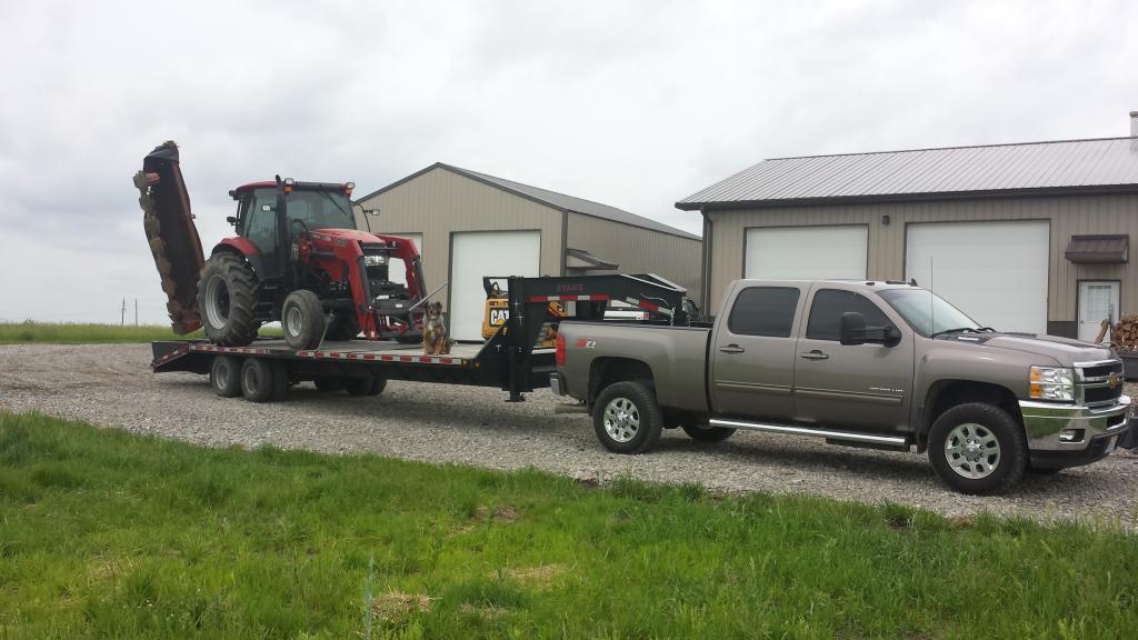

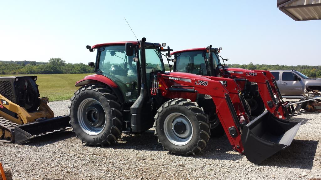

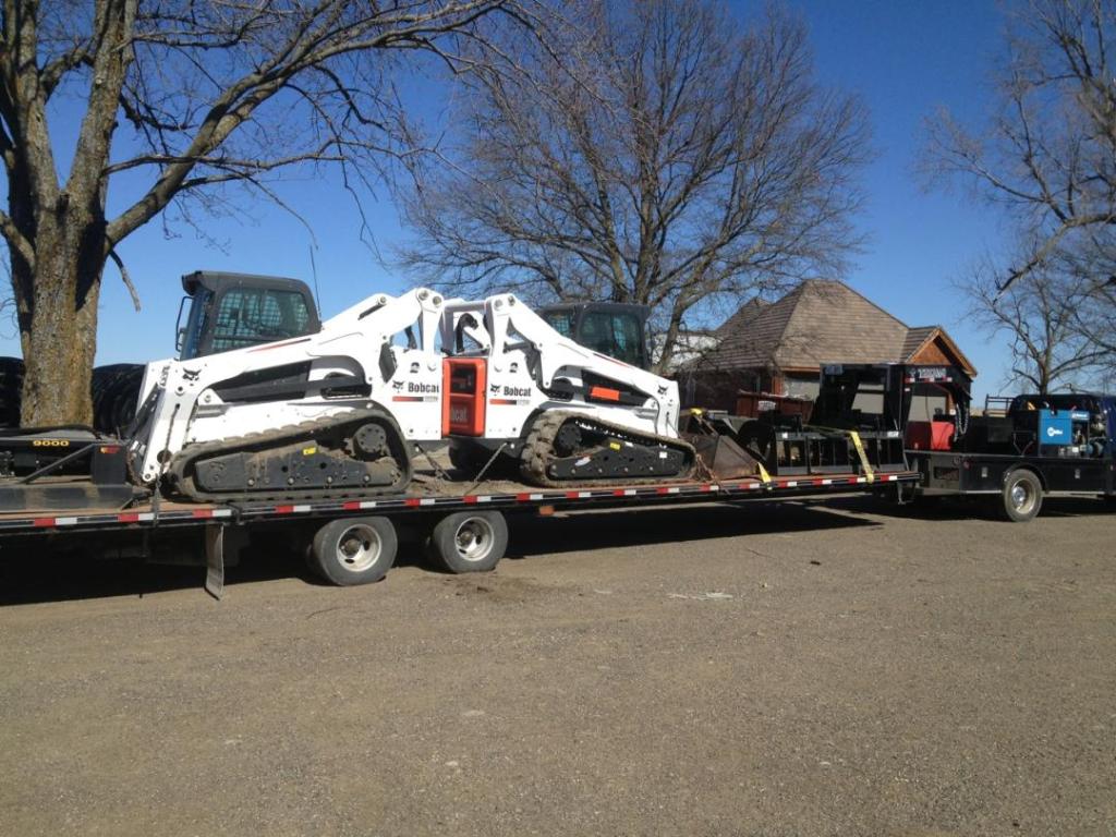

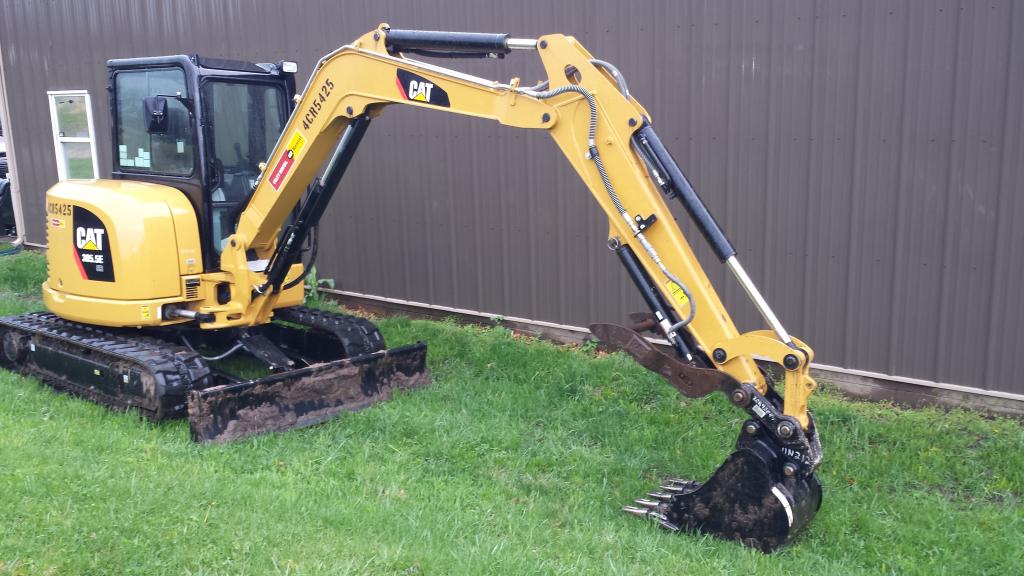

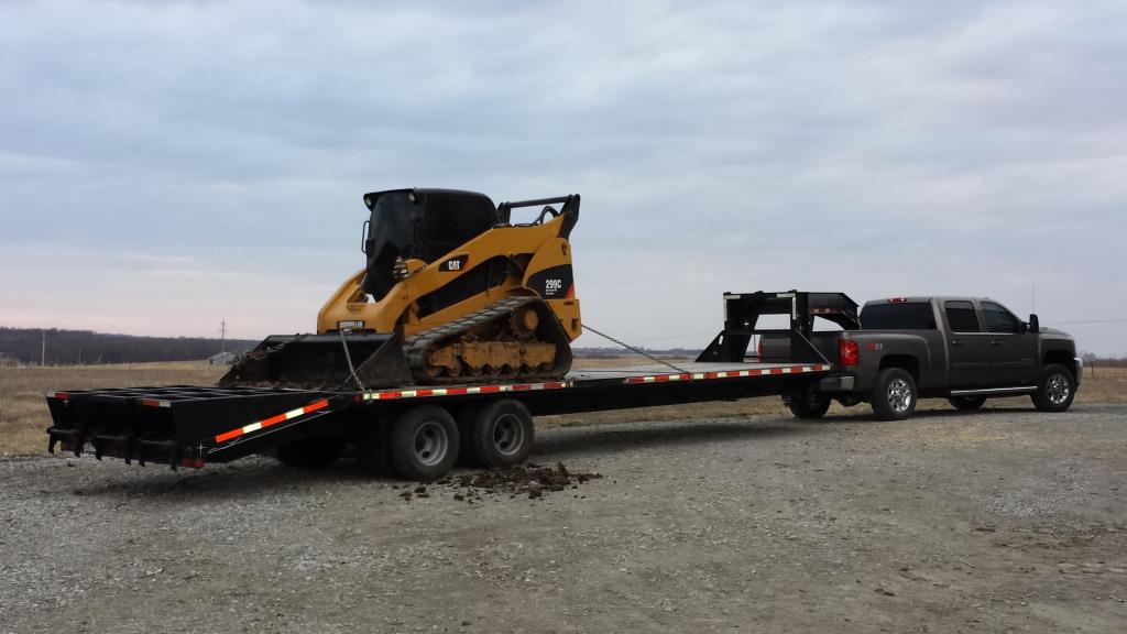

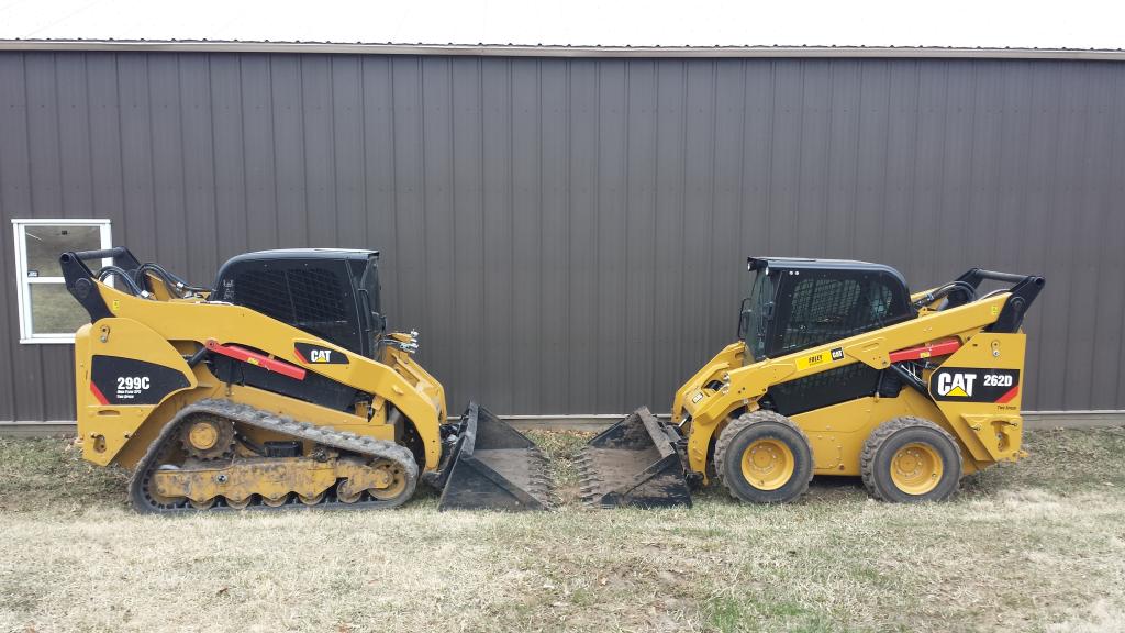

I'm kind of a rookie hauling little toy lawn tractors and toy backhoes around so I feel like I majorly screwed up installing a tee with my airbags :cool2: I'm just devastated.
View attachment 385793View attachment 385794View attachment 385795View attachment 385796View attachment 385797View attachment 385798View attachment 385799View attachment 385800
Hey Cre - :stirthepot:

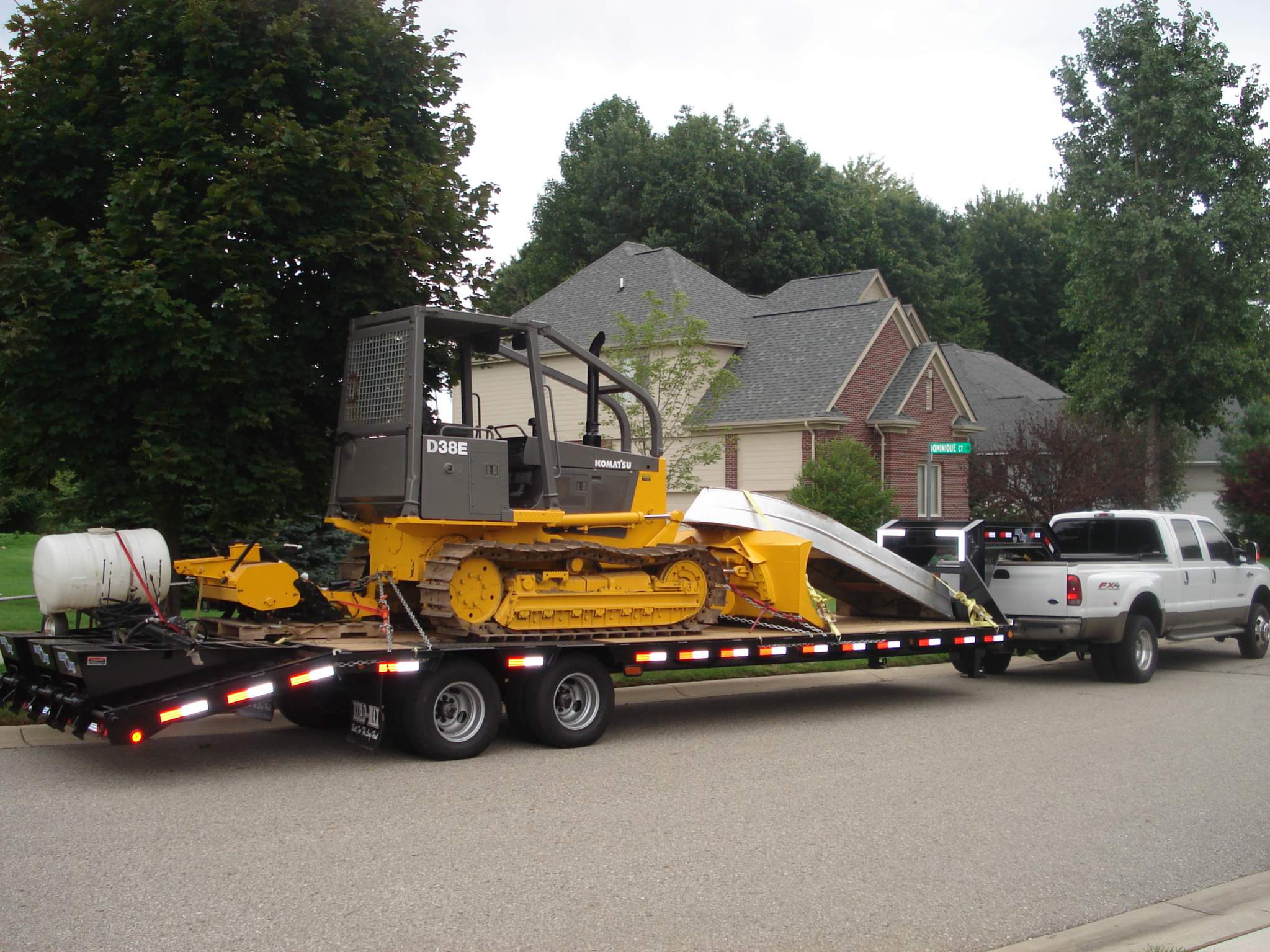

See if you plumbed em separately, you could haul a real load, like such;
:laughing: Just kidding....I think you hit it on the head with post #110. Both are OK for different applications. I have hauled a slide -in camper in the past and like the independent capability....and you never know when you might have an off-balance load in the bed.....I've seen it with a load of gravel for one example.
Very nice team of toys you have there as well....
Entertaining thread, to say the least...I just spent a good 30 minutes reading the debate mushroom.....:D
Just a little levity guyz....
I'm jealous! Nice Komatsu and awesome low pro trailer!
