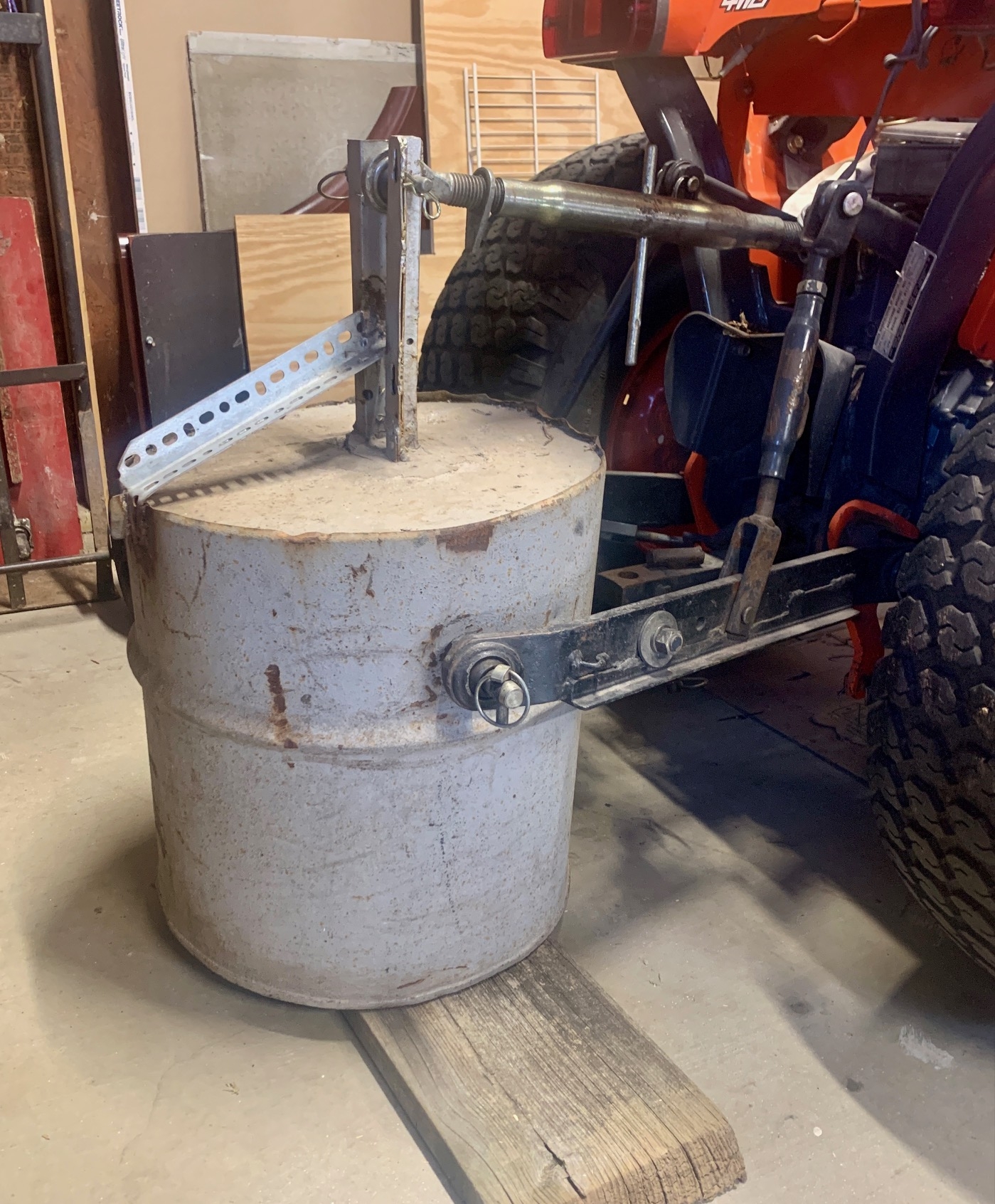

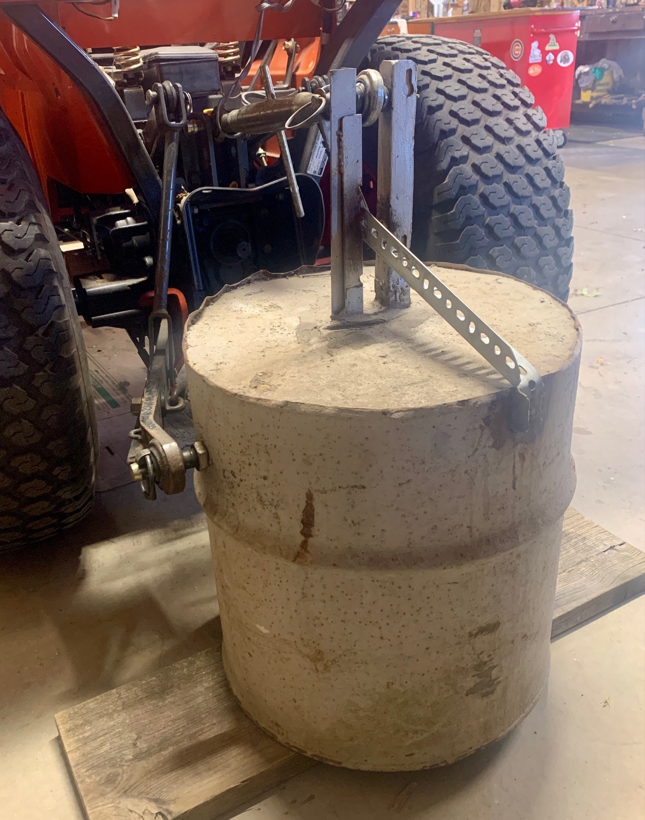

/ Rear weighting device #42
30 gallon barrel with the top 1/3 cut off, then filed with 6 bags of concrete.
/ Rear weighting device #43
The only problem I would have with that setup is the lower links are too high, at least for my usage anyway.
I have a couple of the "square" type ones and one of the connections is higher than the other. I went to dig out a ditch and I couldn't raise it high enough to clear. I used to just leave my 5' cutter on and it would barely clear.
If you don't need to have the clearance then that's probably the easy way to go.

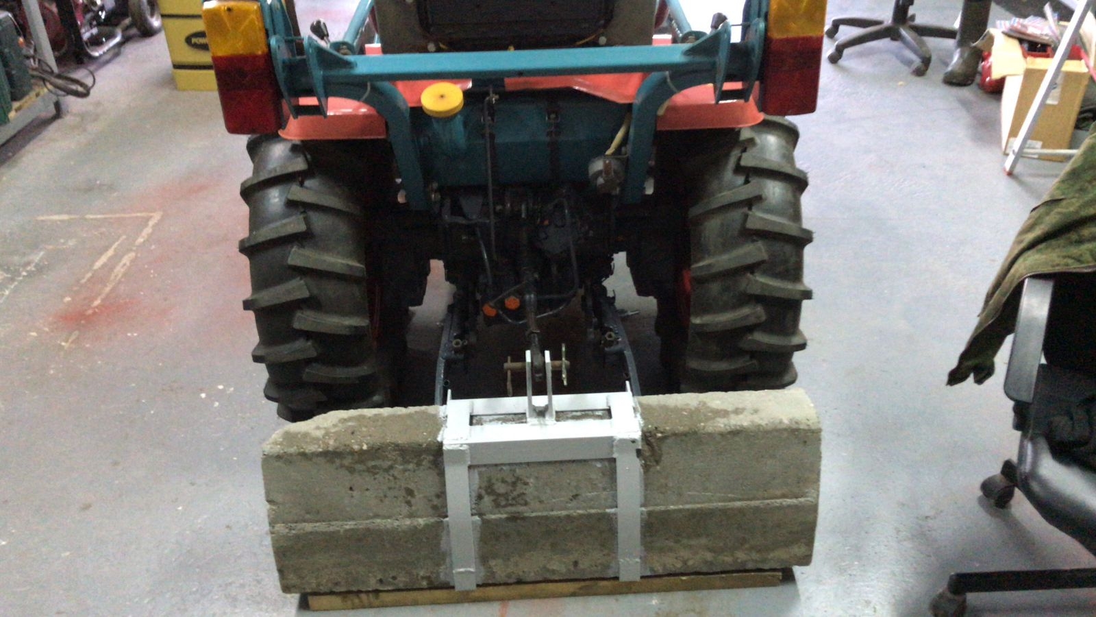

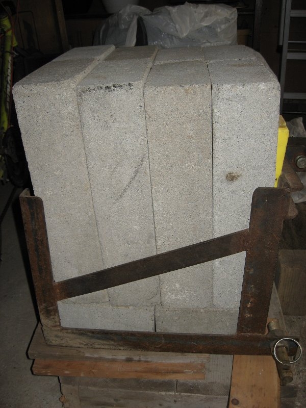

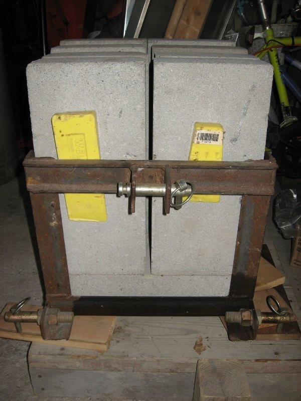

/ Rear weighting device #44
As with everything, size does matter and each tractor/setup is different.
When I got my little B7300, it had loaded rears, but I noticed the rear end was still light at times with a loaded bucket. I chatted with my neighbor, a diesel mechanic who frequently works on farm equipment, and asked him to weld up a ballast box for me, which has helped immensely. Basically it will hold 10 solid blocks, for about a 320# combined ballast on the 3PH. Since then, I have noticed a need for a bit more weight, and solved that by ratchet strapping 4 more blocks to this setup. I may have him permanently weld on some added bracing to handle this. [Splitting wedges are low cost shims that keep blocks tight/steady during work]
I do have to admit, the loaded tires were an added benefit and are great. I have mowed with my cousins small JD with his MMM without loaded tires, and it feels much less stable when mowing inclines than with my B7300. Also, I have my rears adjusted wide (per manual) for added stability, at all times.
And, as has often been warned, and often needs repeating, never travel with a loaded bucket raised to height. Always keep the load as low a possible. Save raising the bucket until stopped or nearly stopped at location to dump or empty.

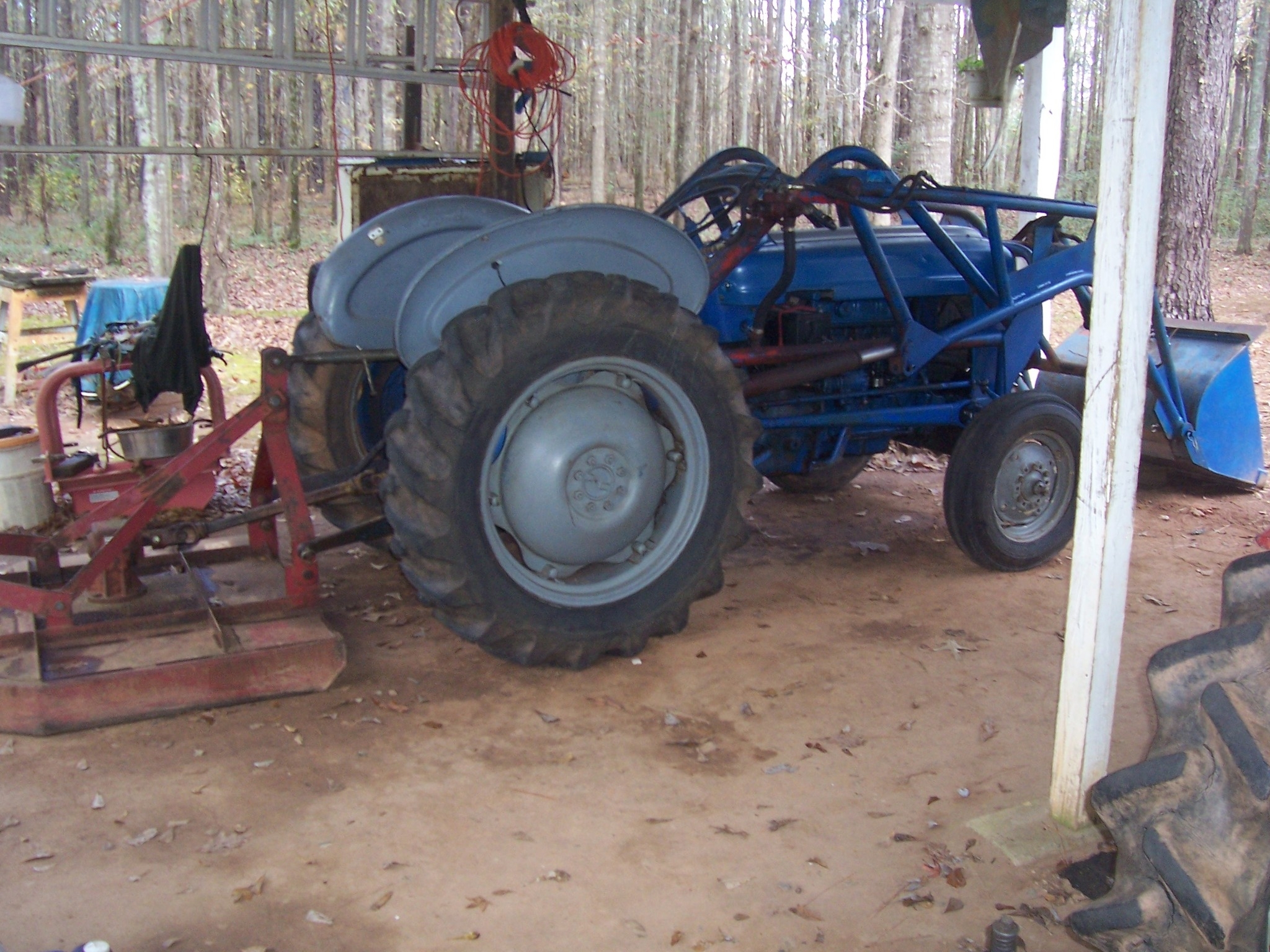

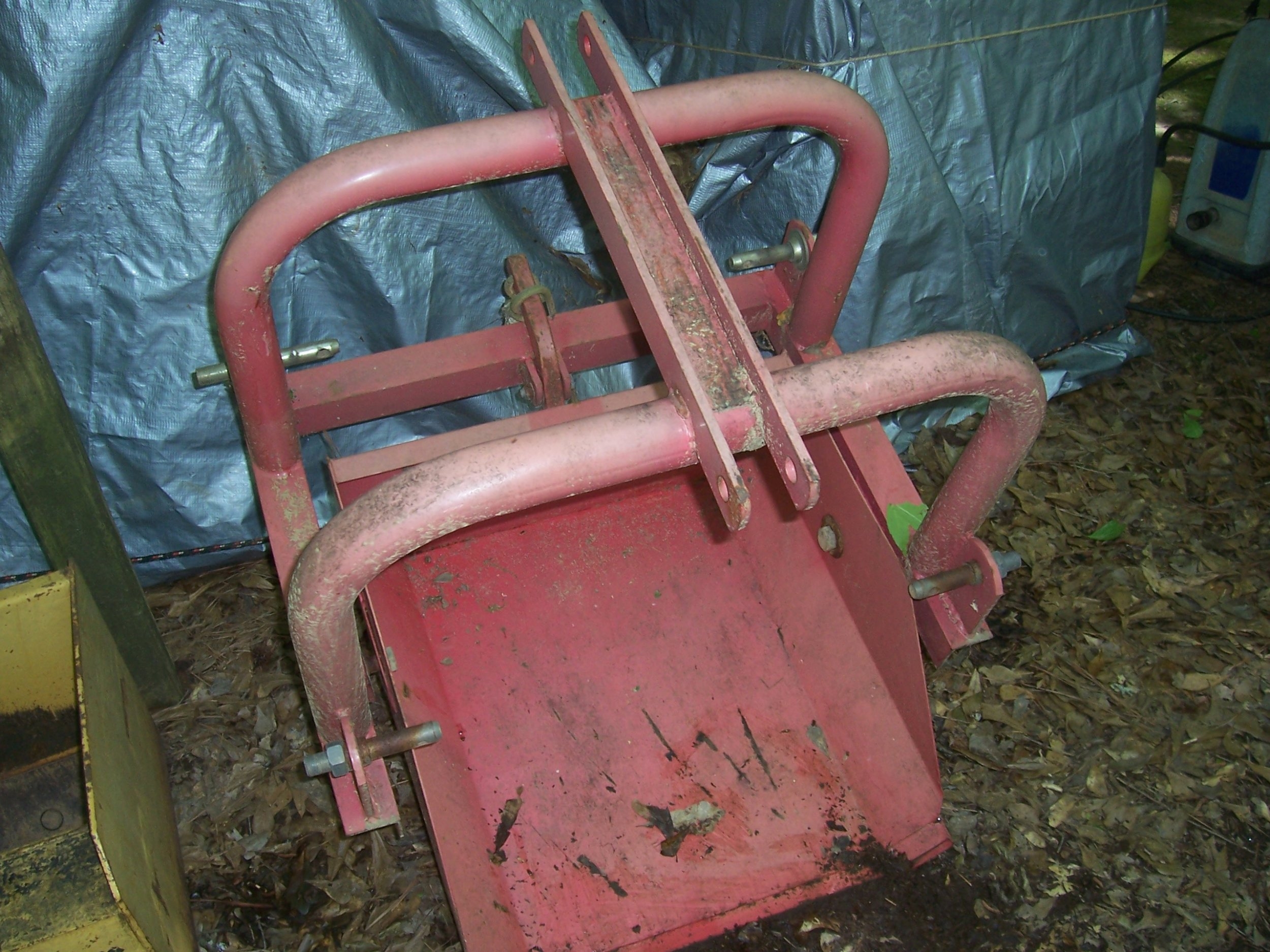

/ Rear weighting device #51
63 Ford no power steering. Lost most of the use or my R. arm. So far I have been able to work around that problem. I use a old International BH. and it's super heavy. major difference back there lifted. So far I've been able to use it without PS.. My area it doesn't show up Factory used. A complete tractor or want as much for the PS. as a whole used tractor. I do have a rear scoop. I like the idea of loading it with weight. I'm thinking a old Big block motor should fit nicely. 455 Gm. 460 F. etc... should fit right on it!! box it in also just for the looks also. I do have Antifreeze in the rear tires.
/ Rear weighting device #52
Most rear weights posted here are centered… between the lift arms. Which, to me, is kinda like a tricycle arrangement.
Would there be a difference if the additional weight was divided in half and placed directly behind the rear wheels (mounted on each end of a box blade, for example).
The center weight styles are convenient from a manufacturing point of view and are more compact for tight quarters.
Like most things in life, I’m probably overthinking this…
/ Rear weighting device #53
As long as there is equal weight on both sides, it doesn't matter. As far as the tractor is concerned, the weight is on the ends of the lower 3-point arms, no matter whether it's actually centered or spread out behind them.
