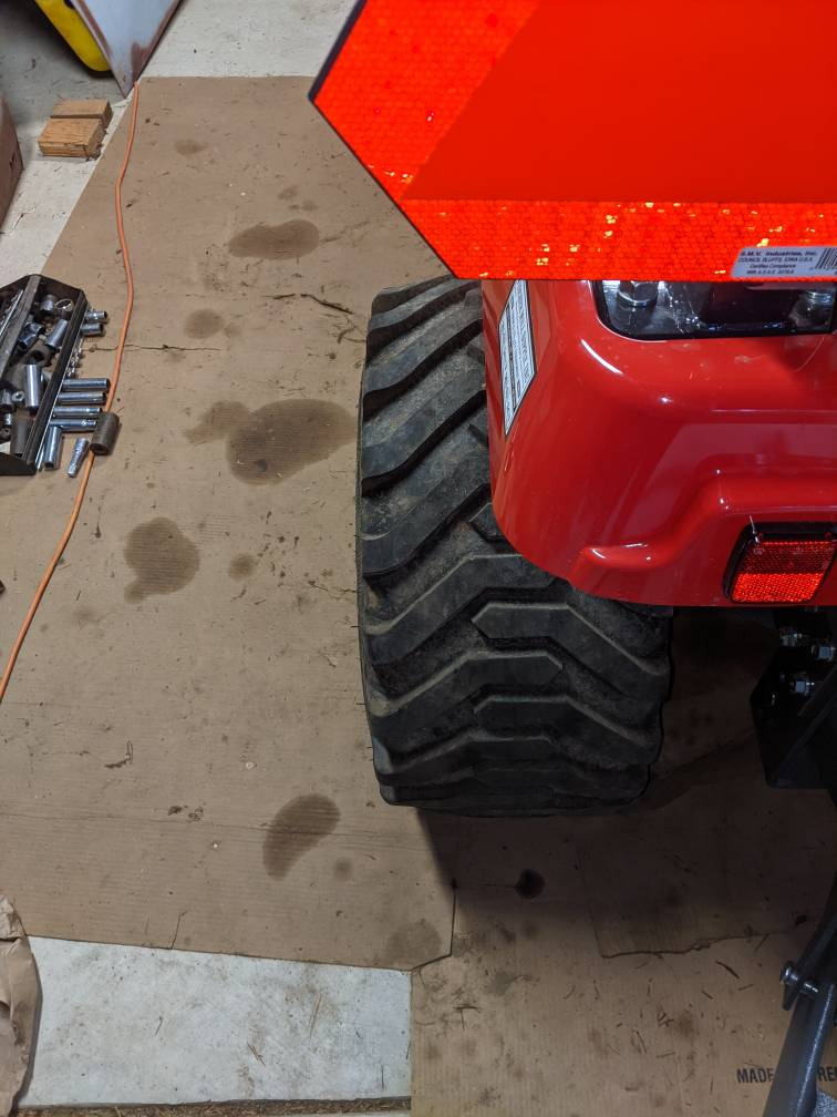

Got them installed.

I'm in Canada and we get a lot of snow. Look at the picture and you'll get the idea. I now use chains on all four wheels and I have 4 inch spacers. Works well for me.
   / Rear wheel spacers #20
Dave M., I ended up drilling out the wheel flange bolt holes and used bolts and nuts to hold the spacers on. The spacers loosened up and tore the threads out, so that was the best solution. Worked for years now.
