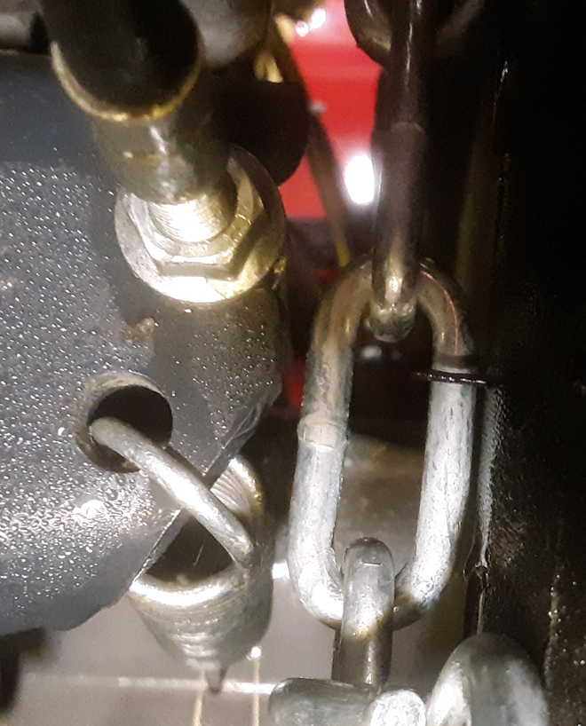

Below is a picture of the chain clearance on the left (driver's side) rear wheel of my GC without spacers. You definitely need spacers if you want to run chains. If you are only worried about chain clearance you can go less than 3" and have plenty of room for chains if you put them on tight. I put the 2" spacers on mine for stability, I would have gone with 3" but I use the MMM.

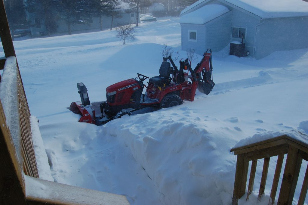

I'm in Canada and we get a lot of snow. Look at the picture and you'll get the idea. I now use chains on all four wheels and I have 4 inch spacers. Works well for me.
