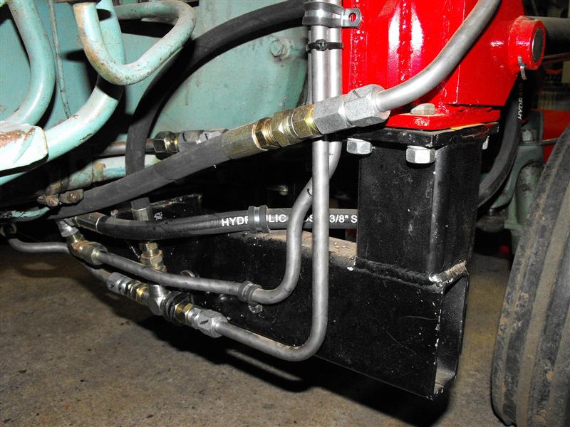

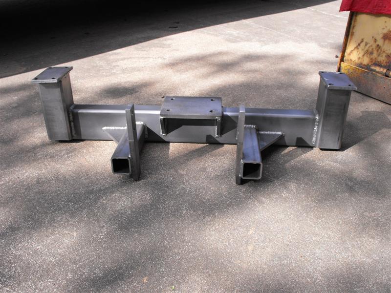

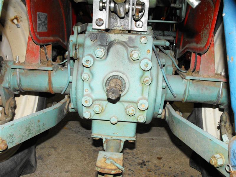

Since I'm going to have to move the loader hydraulic lines I want to hold off for a little bit so I can use the tractor a bit more. I will start the new thread as soon as I get some work done. Here are some pics of what I have to rework to make room for the welding and steel and the current sub-frame under it. Maybe by then I will have decided on either wheel weights or filling the tires.
