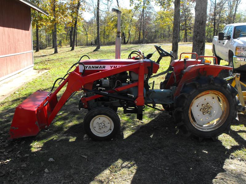

I think I have mislead everyone on what I was wanting to know.
The loader was built with the tractor in mind and not what I could do with it or how much I could load it. It was built small, light and a small bucket. The bucket is 19" deep, 16" tall and 42" wide. As best as I can tell, it is not hurting the front end or the tractor and that is what I wanted. Yea, it will take more trips to do the same as a normal size loader but that is not a problem for me.
I have found out that the loader is a handy tool to clear out the undergrowth in my woods. But the trees are a little close together and getting around through them is sometimes tight at best. With just the loader and no attachment on the back it works great except when I go to level a high spot and load the bucket then I sometimes loose traction backing up. Doesn't seem to have the problem going forward. So for that reason I would like to add weight to the tires. I just didn't know if one method was better than the other and why it would be so.
I really do like all the responses and they have given me something to think about when adding implements and how they can affect stability. Here's a picture so you can see the loader is pretty small as they go.
