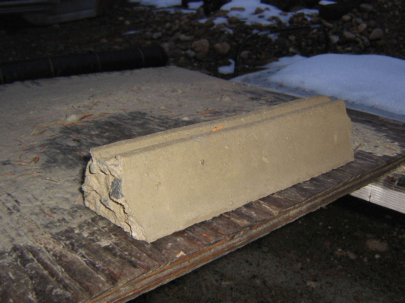

Most people just position the rebar so it's in the middle area of the pad. For most applications, this is fine. For the best results, the rebar should be at the 1/3 point from the bottom. Think of concrete as a beam going across a span, and it wants to sag in the middle. Putting the rebar at the lower third point of that beam will give it the most support at holding it stiff and flat. Rebar holds the concrete together. It doesn't add an PSI to it.
All concrete cracks, but if you have enough rebar in it, and you use the correct amount of water, there is no reason that you have to see those cracks!!!
This can not be overstated. Putting the rebar or wire in the middle of the slab has MINIMAL effect on slab strength. The only reason steel is incorporated into concrete is to add tensile strength. Concrete has tremendous compressive strength. It's primary characteristic is compressive strength. Therefore it's classification. A 3000 psi mix will withstand 3000 psi of compressive force. Tensile strength of concrete is negligible. It's easy to pull a test sample of concrete apart.
Steel on the other hand has great compressive and tensile strength with tensile being the lower of the two. It's classified by it's yield (tested with tension) strength. A36 steel can withstand 36,000 pounds of tensile force before it yields.
As Eddie says, think of the slab as a beam, or a pencil with a load in the middle causing sag or trying to break the pencil. The stress profile of the beam at the center would show the top of the beam under compressive load while the bottom surface is under tensile load. The stress profile between the tow points is linear with the center of the beam under no stress! The center is balanced between the compressed top surface and the stretched (tensile) bottom surface. The steel wouldn't add significant tensile strength to the slab until after the bottom surface has cracked and failed under tensile load shifting then stress profile up through the slab. The bottom 1/3 is a sweet spot. Too low in the slab and adhesion between the concrete and steel becomes an issue.
There's a reason why bridges and structural steel beams are "I" beams. That profile provides the most strength with the lowest weight per foot. The wide top flange handles the compressive forces, the wide bottom flange handles the tensile forces, and the ultra skinny web that connects the two is compatible neutral with regards to tension and compression. Box sections are stronger, but not to the order of magnitude that requires additional design to support the significant weight increase of a box over and "I" and "H"
PLEASE stop putting steel in the middle of a slab. 2 chairs are for 6 slabs. 2.5 chairs are for 8 slabs. Use wire for 4 sidewalks.
As for cracks, you can't stop them. Saw cuts will let you determine where they form instead of nature deciding.
   / Rebar supports in a slab #38
Almost every pad is poured with too much water. The excess water will evaporate and leave a void behind where it used to take up space. You lose volume to our concrete when that excess water goes away.
Most concrete crews will add as much water as they can get away with because it makes it so much easier to spread the concrete. A good contractor will stop this, but most also want to get the job done as quick as possible, so they allow it to some degree. On commercial jobs, they test the concrete by putting some of it in a small pail and then flipping it upside down to make a sand castle. If the concrete comes out of the pail and remains in shape, you have the right amount of water. Most pails to do this are about a quart. Google "Slump Test" if you want to learn more.
To gain the most strength out of your concrete, you use the smallest amount of water. Adding Portland Cement to the mix will also increase your PSI. Making your pad thicker will increase PSI. After that, it's very hard to make noticeable gains for a reasonable amount of money.
Wire mesh works better then rebar at holding the concrete together. Unfortunately it is impossible to keep the wire mesh in the middle of the pour. Liars, I mean concrete contractors, will tell you that they lift it up while they are spreading the concrete and you are supposed to believe that it stays in the middle of the concrete while they walk on top of it. This also happens to rebar without chairs. Anybody pouring concrete without chairs is a hack and should be fired on the spot, unless it's such a small area that you can actually add the rebar or wire mesh to the concrete and never on any of it.
Most rebar is done on a 24 inch grid. Tied together and the chairs are installed close enough together that the rebar is flat. If you tie your rebar really well, and overlap each stick, you can go farther out with your chairs. I won't say what that distance is because I've never paid any attention to it. I just put the chairs under the rebar after it's all tied and decide on where they go one after the other.
I prefer rebar on a 18 inch grid. It's not a lot more rebar, and you can still walk through it easily while spreading the concrete, but I think adds enough to the pad to make it worthwhile. All concrete cracks, but if you have enough rebar in it, and you use the correct amount of water, there is no reason that you have to see those cracks!!!
