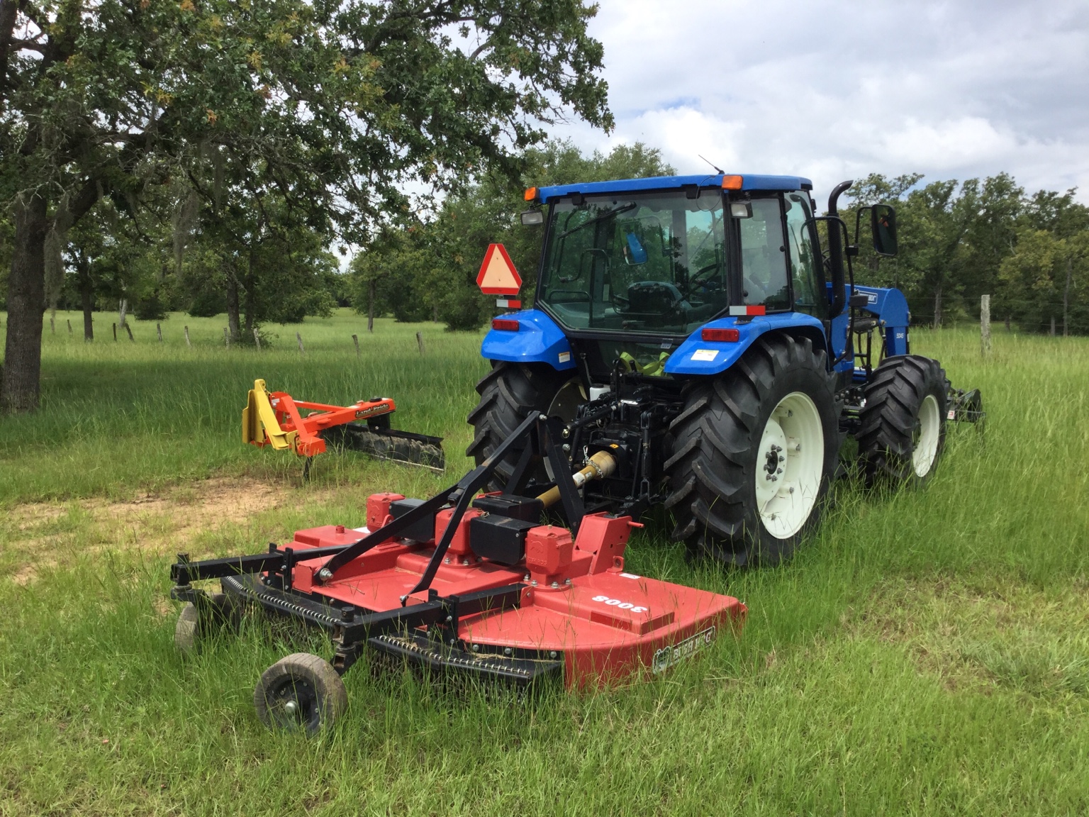

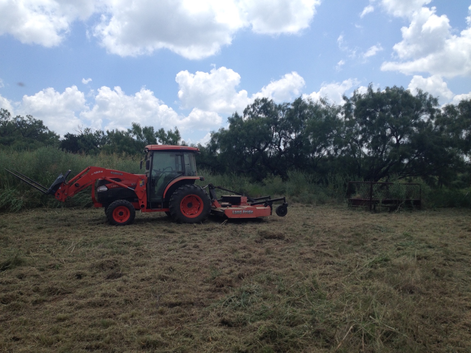

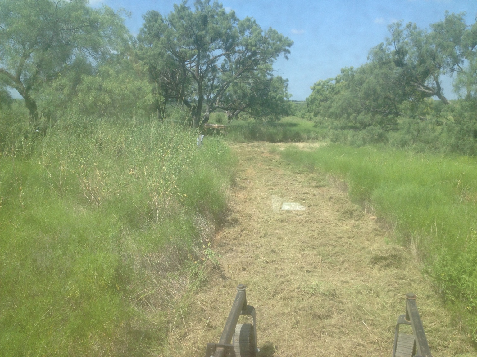

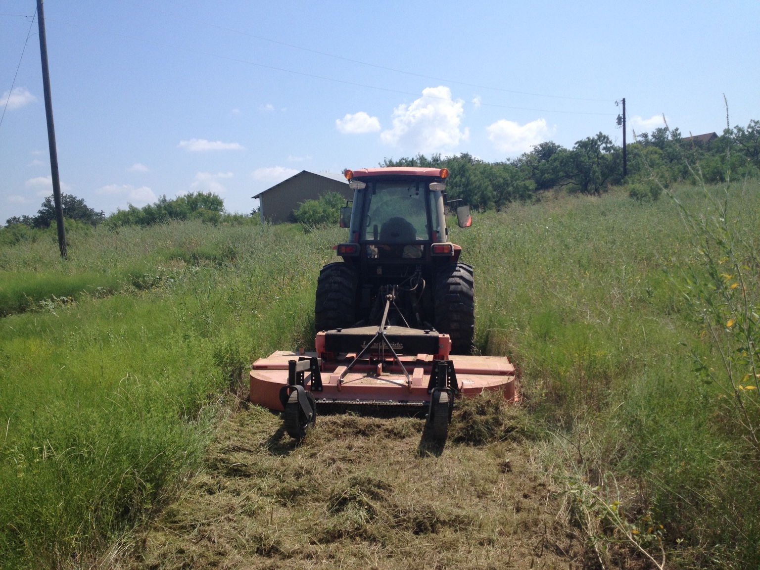

I've got the LandPride. I like it, seems to cut well. Can't say I've had the same issues that post u reference has had.
ImageUploadedByTractorByNet1465157722.141536.jpg ImageUploadedByTractorByNet1465157753.588248.jpgImageUploadedByTractorByNet1465157775.115590.jpgImageUploadedByTractorByNet1465157797.660357.jpg
