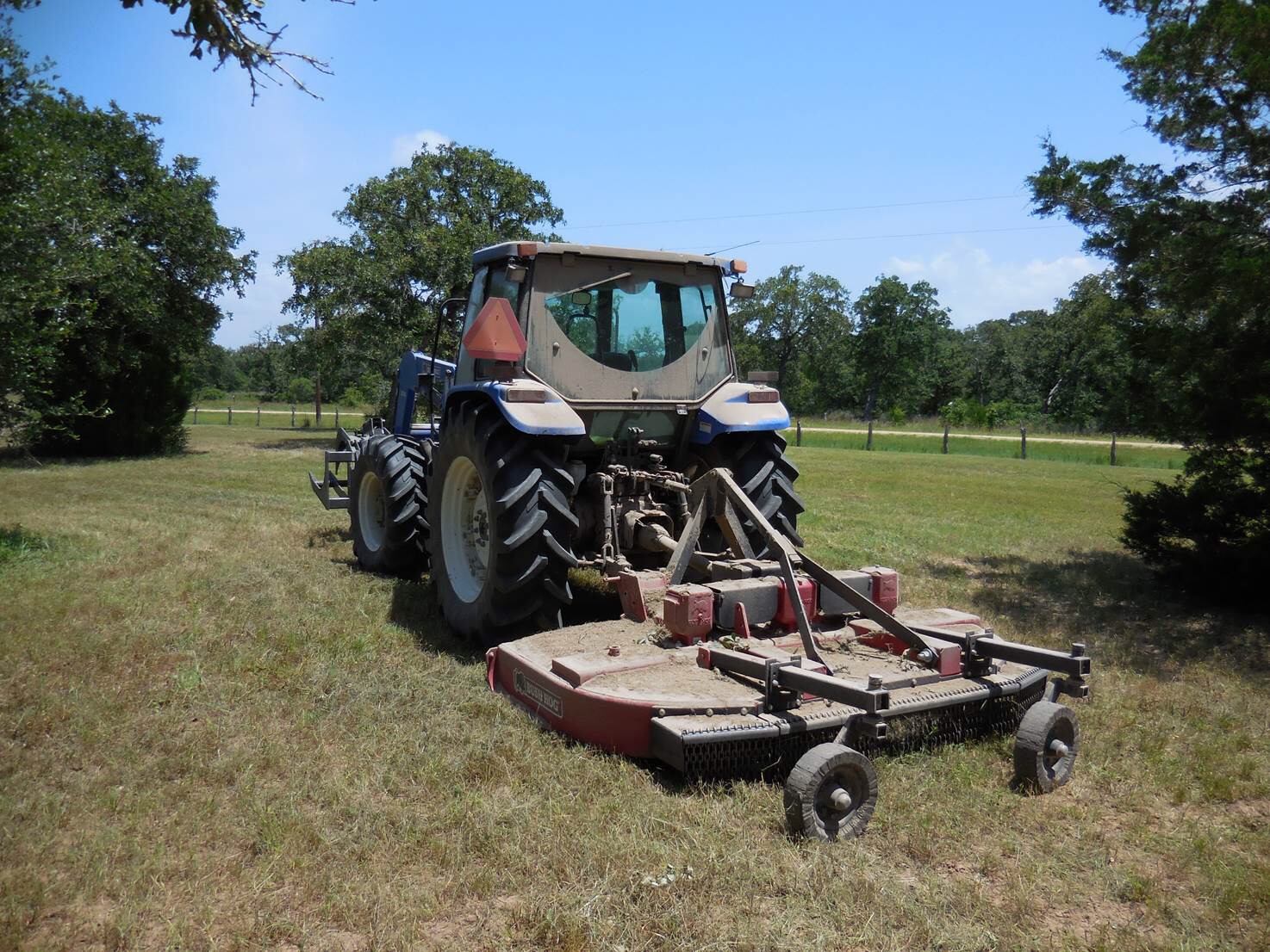

There are also 7' twin spindle bush cutters (see the SQ84 for one).
Not sure if they are heavy enough, but I would get one of those before I for a single spindle 7' mower.
Aaron Z
   / Reccomends me an 8' twin spindle cutter #18
That is a good looking unit.
Thanks James. It cuts well and provides me counterweight for big grapple lifts.
It's rarely that clean.
