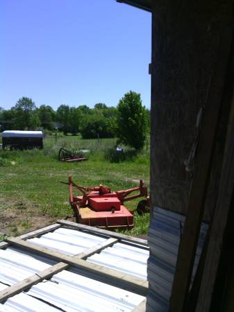

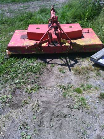

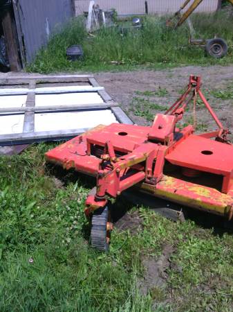

Sort of related to LD's search, has anyone ever seen a 6' twin spindle cutter?
Yes, it was an ancient (probably homemade) rusty contraption. Generally, the only multi-spindle 6' mowers are finish mowers.
Edit, found one: 6 foot 3 point bush hog heavy duty
00l0l_gZWP4kjhy4Q_600x450.jpg 01616_464CtYTHASD_600x450.jpg 00D0D_2o8MDqPmoPt_600x450.jpg
