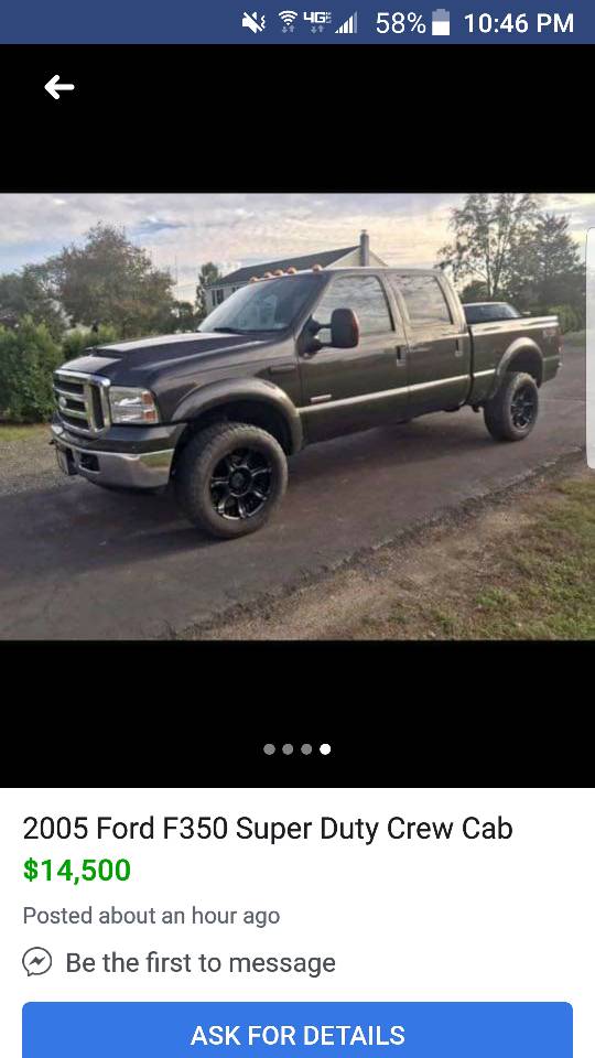

I'm seeing ads like this and the truck has 135k, and it seems like diesels have no problems going 250k, i can probably sell my 2500 hemi (which is getting rust underneath body good just everything underneath is rusting, like they parked in wet grass its whole life) i can probably sell now with plow for close to that much before body starts rusting bad Screenshot_20181126-224602.jpeg

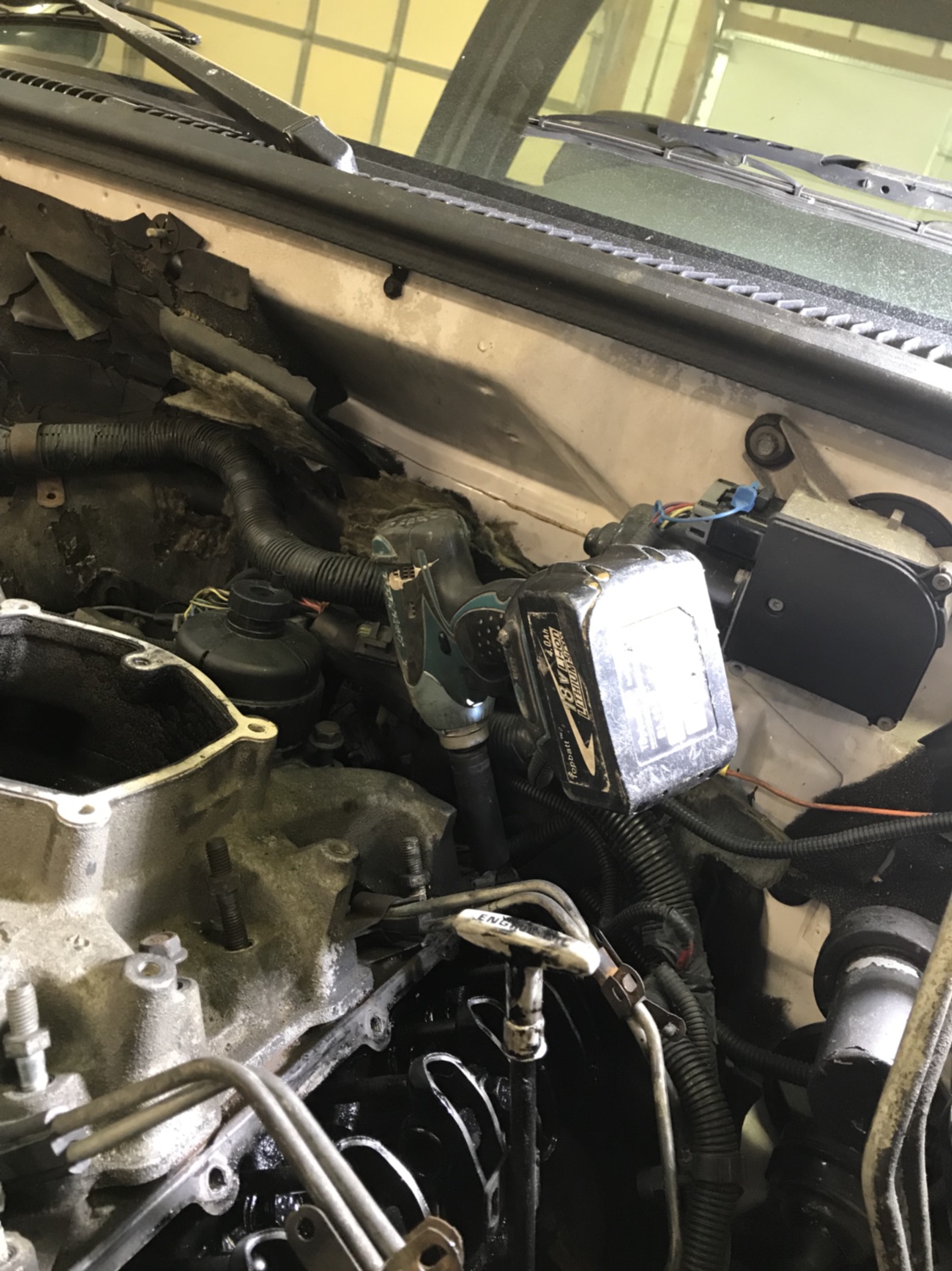

Which ford was it that needed to have the cab removed and what the problem that needed to be repaired
2008-2010 with the 6.4L diesel
   / Recconendations for older diesel #26
Probably all of them. I sent my buddy this picture because he had a v10 ford and you couldn’t do anything with the back 2 cylinders. The 5.4 is no better. Really stupid design IMO. There’s plenty of room to move the motor forward. The fan shroud is a foot deep.

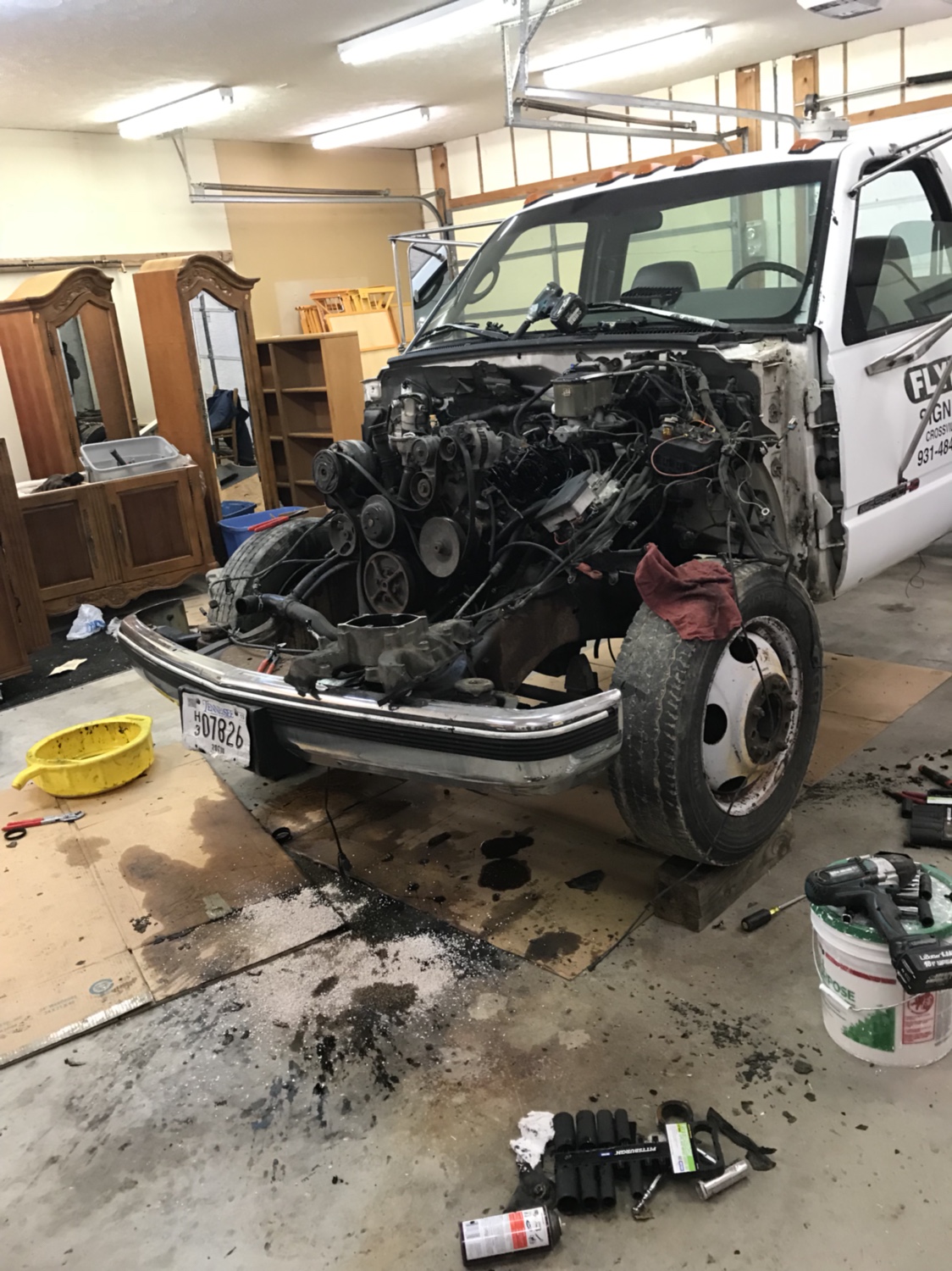

Some jobs are better left to the professionals, but I prefer to do my own wrenching. I don’t know how you’d afford to drive an old truck otherwise. And they prefer pulling the cab over what other option? I pulled the fenders and front end which you’re probably going to have to do to pull the cab anyway to for this engine swap. I can’t imagine wanting to pull the cab too. Even if you are setup for it it takes more time and room. IMG_0670.JPG
