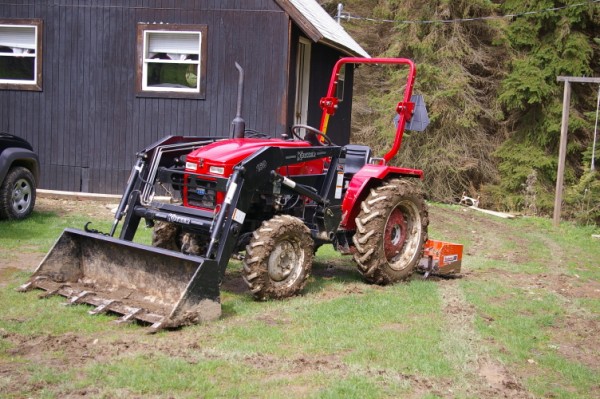

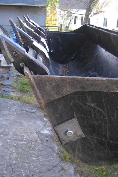

I never welded on the reinforcing squares either. I just attach them, like washers, to the outside of the bucket each time I put the toothbar on. I've not had any issues with the bucket bending.
That toothbar has been great for moving tree stumps, roots, brush, and weeds. I call it my poor man's grapple. Sorry, my pics only show the toothbar on the bucket, but no good brush moving action shots. By the way, that toothbar can dig a mean hole in some serious hardpan, dry concrete-like clay. /forums/images/graemlins/cool.gif

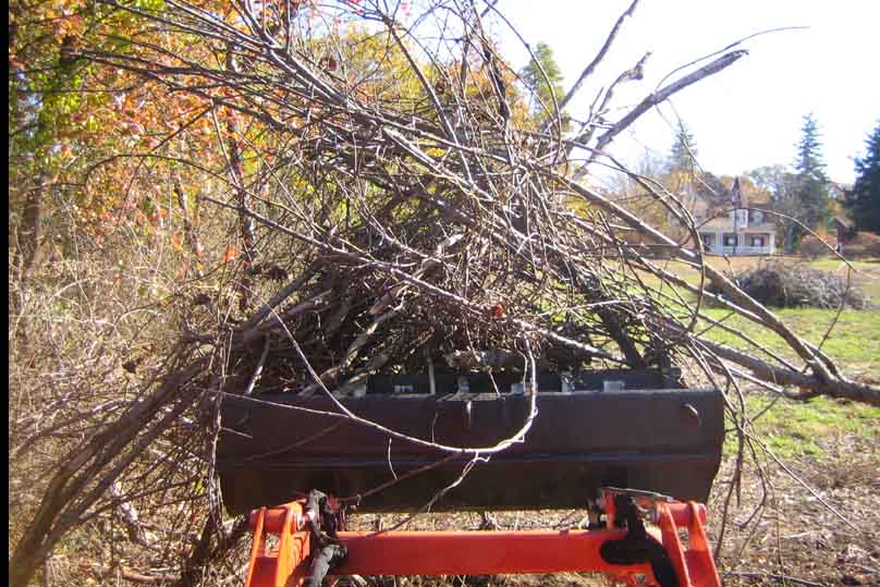

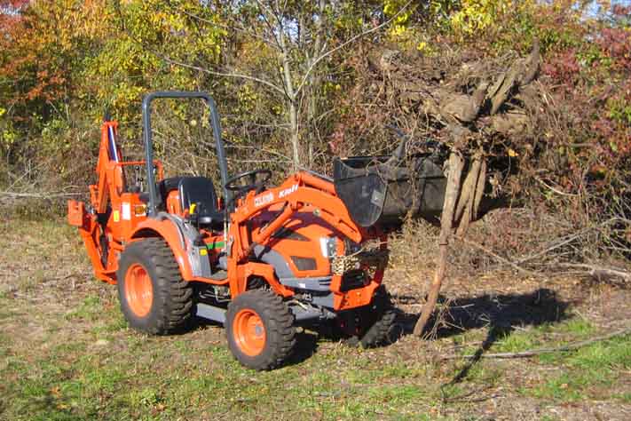

Exactly. /forums/images/graemlins/grin.gif I am still thinking of putting on a grapple but the difference between the naked bucket and the bucket with toothbar is like night and day for removing brush and popping up roots. I especially like the fact that I don't need to use chains nearly as often when moving stuff I've dug out with the BH (photo) or just ripped out of the ground with the FEL. I haven't needed to do any serious digging with it yet but I am sure it excels there as well.

Since the primary purpose of my toothbar will be digging, uprooting and breaking loose, I am going to weld those side plates on. They help distribute the stresses imposed to the bucket sidewalls over a larger area. And since the bolt is a 1/2"Ø and the bucket wall is 3/16" or 1/4" thick, the wall could mushroom out, elongate, maybe even crack before the bolt breaks. Heck, then all the force would be absorbed by the bucket's leading edge and maybe...???
Don't know if that would happen, but I could see it happening...you know... Murphy's Law. I'd rather have a 50 cent bolt to shear than my bucket walls. I'm sure that's whay they include them. Just my opinion, though, used to know a little about stress analysis and stength of materials...blah blah blah, now I don't know diddly squat anymore. Just glad to be here to learn some more.
