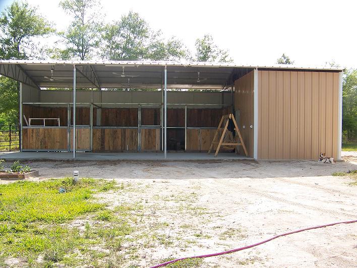

I built a 48'x30" back in the spring. I had the folks I bought the material from put up the posts, trusses, and roof. I also had someone finish the concrete for me. The rest I did myself with some help from family. Total cost was about $25,000. If I would have not built the stall and tack room, it would have been much cheaper. The walls and roof are insulated. All the structure is galvenized box tubing. 12' foot eaves, trusses on 12' centers. I do not have to worry about snow though. It has snowed I think five times in my life in south La. It was not finished in the photo. Just had a few smatt things to finish up though. barn.JPG
