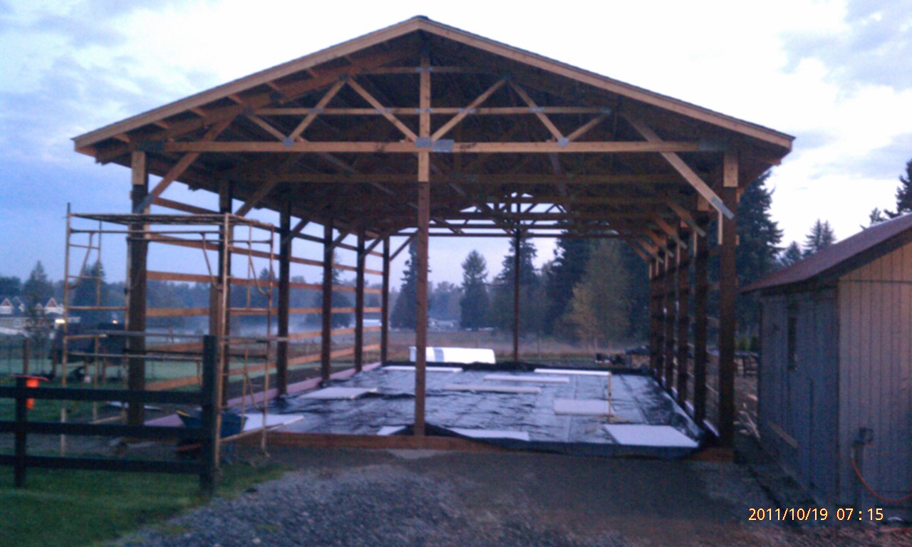

In our area, the companies triple the materials cost. I am most of the way through building my own 30x60x14 as a result. Lots and lots of money to be saved and pole barns are not rocket science. I'll be at about 15,000$ for the build, tractor has been very helpful.
I even got spunky and decided to add radiant floor heat to the slab.
A good engineer will design poles 12 feet apart so that you can use way less trusses and less carpentry.

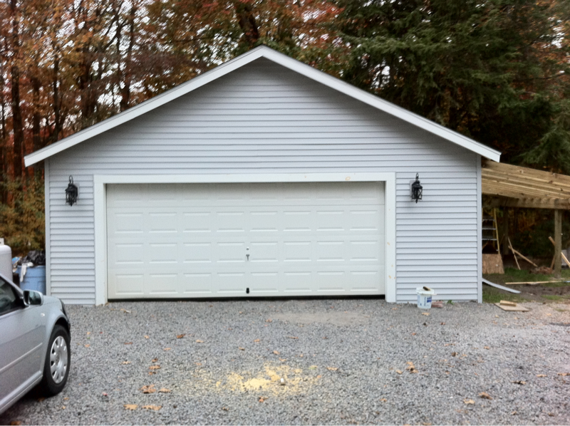

Last year I put up a 24x24 pole barn.This year I added a 12x24 addition for the tractor.Everything added up to around 8,000 $ that is with 60 amp service siding and pavers for the floor.

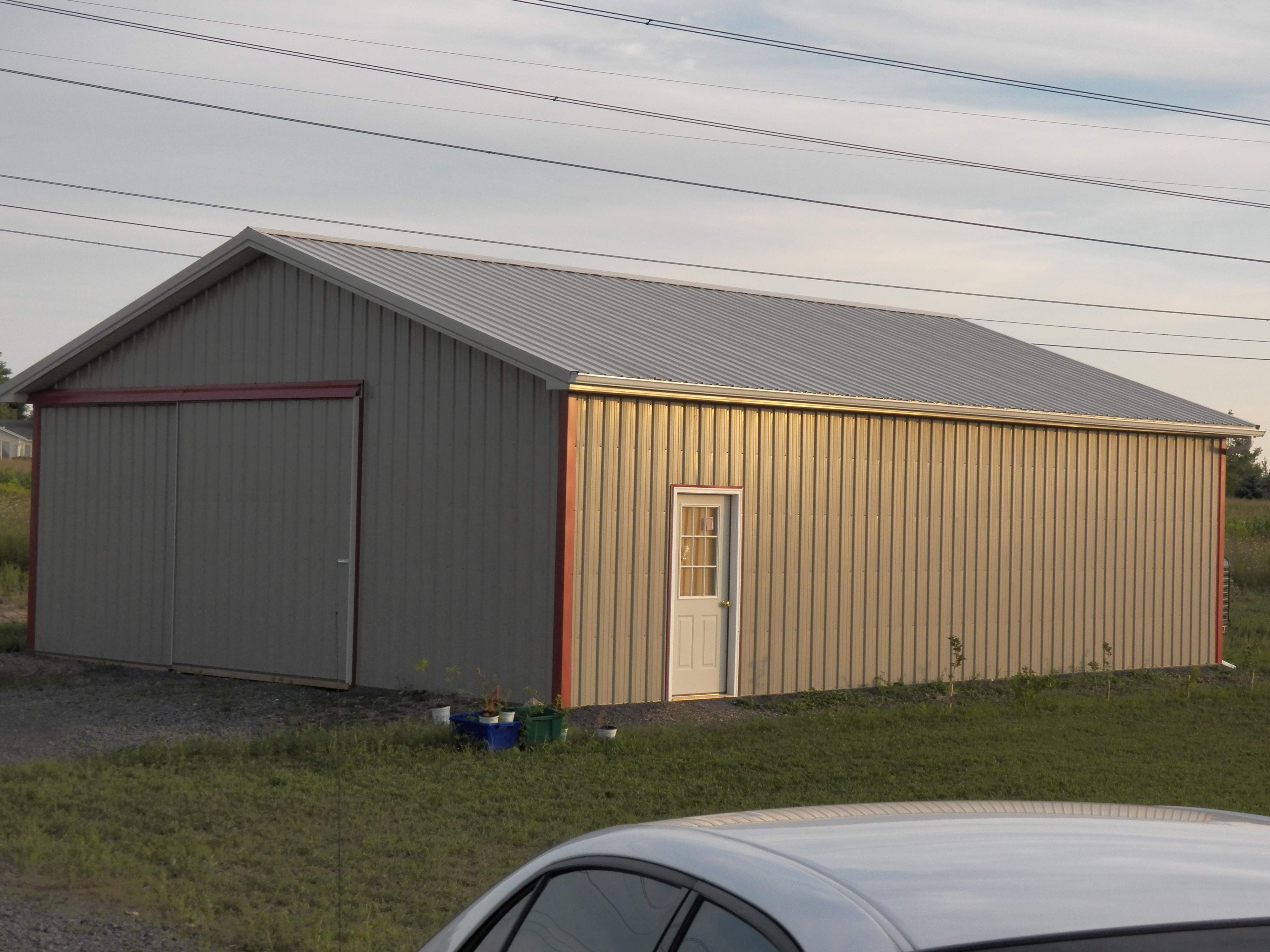

I build a 24 x 24 in the photo building cost $4,500 delivered, 1,000 for the floor, 350 in electric, 400 amp service ( 200 garage, 200 to new house, some day) insulated totally finished in side with oil furnace, about 9K. Built with 1 other freind and beer!!:licking:
This is an awesome price!!!! Man, all the possibilities with the extra money not being spent on the barn!!!!!!! How much did it cost just for the insulation? And how did you do it?

For $13.3k Cleary buildings put up our 24x36 horse barn. The "shell" only. This included 2 12' sliding doors on either end, 2' continuous skylights on both 36' walls, upgraded roof/soffit vents and framing/cutouts for three Dutch doors. A pretty basic/boring barn actually.
I bought/installed the Dutch doors, built the horse stalls and ran the electric myself to save some $$$$$.
We got quotes for the same project from Morton and numerous local contractors and Cleary smoked them all AND we couldn't be happier with the material quality, service and construction process.

Here's my barn built by Santelli Lumber. We were in no hurry since the barn went up the same time the house was being built. The materials sat on the site for a couple weeks before they built it. This went up in 1 day. They drilled the post holes at 7am and had to wait until 10 for the inspector. When I drove in at 3pm they were just hanging the door and packing to leave. 4 guys and a Bobcat.
I leveled the site and added 6" of #3 & #4 stone with 2" of finer stuff on top. After it was finished I added another couple inches of crusher run inside and tamped it down. It's ok but I'd go concrete if I could afford it. I checked out 8 other builders in the area before I decided. Morton was by far the best...and most $$$. Since mine is mostly for storage I couldn't justify the frills, I'm not gonna live in it.
