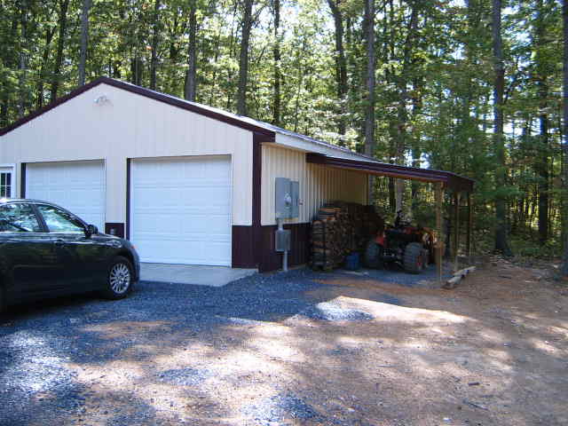

I build a 24 x 24 in the photo building cost $4,500 delivered, 1,000 for the floor, 350 in electric, 400 amp service ( 200 garage, 200 to new house, some day) insulated totally finished in side with oil furnace, about 9K. Built with 1 other freind and beer!!:licking:

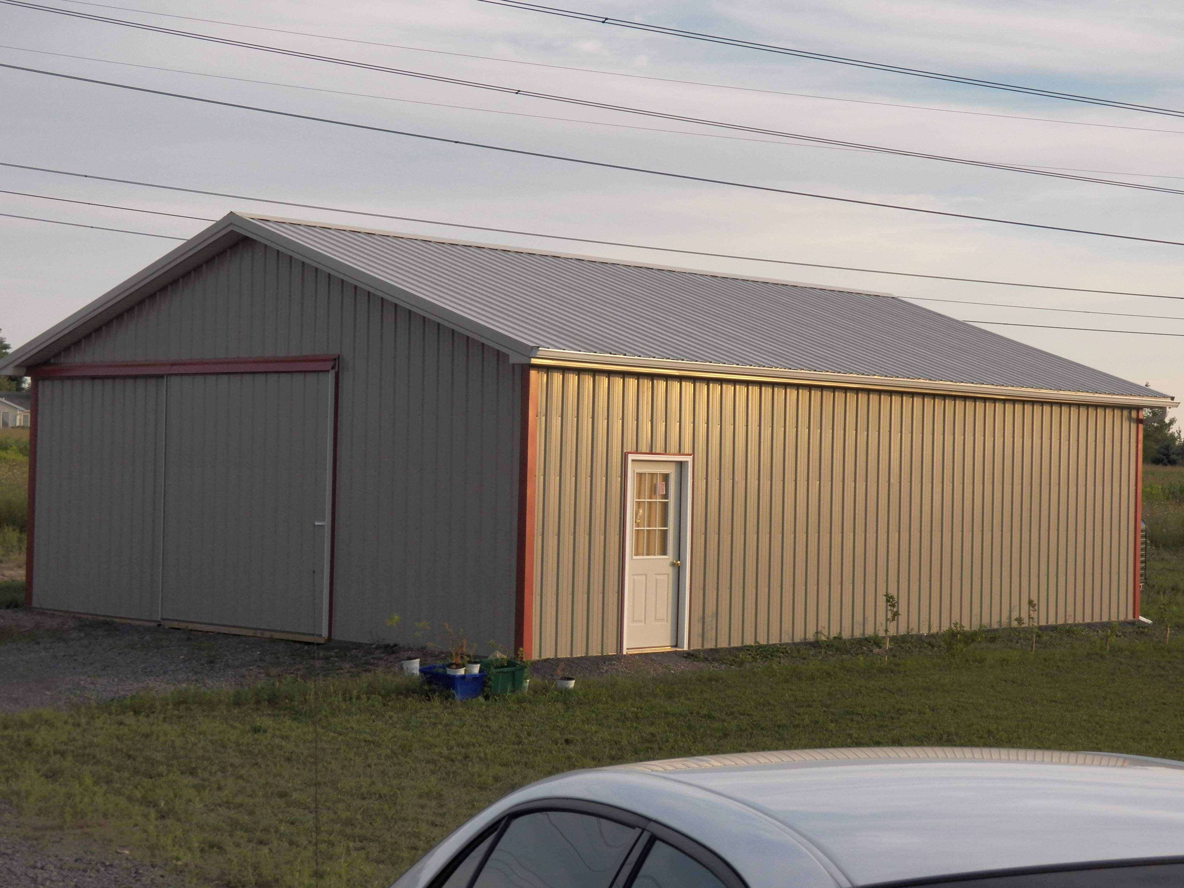

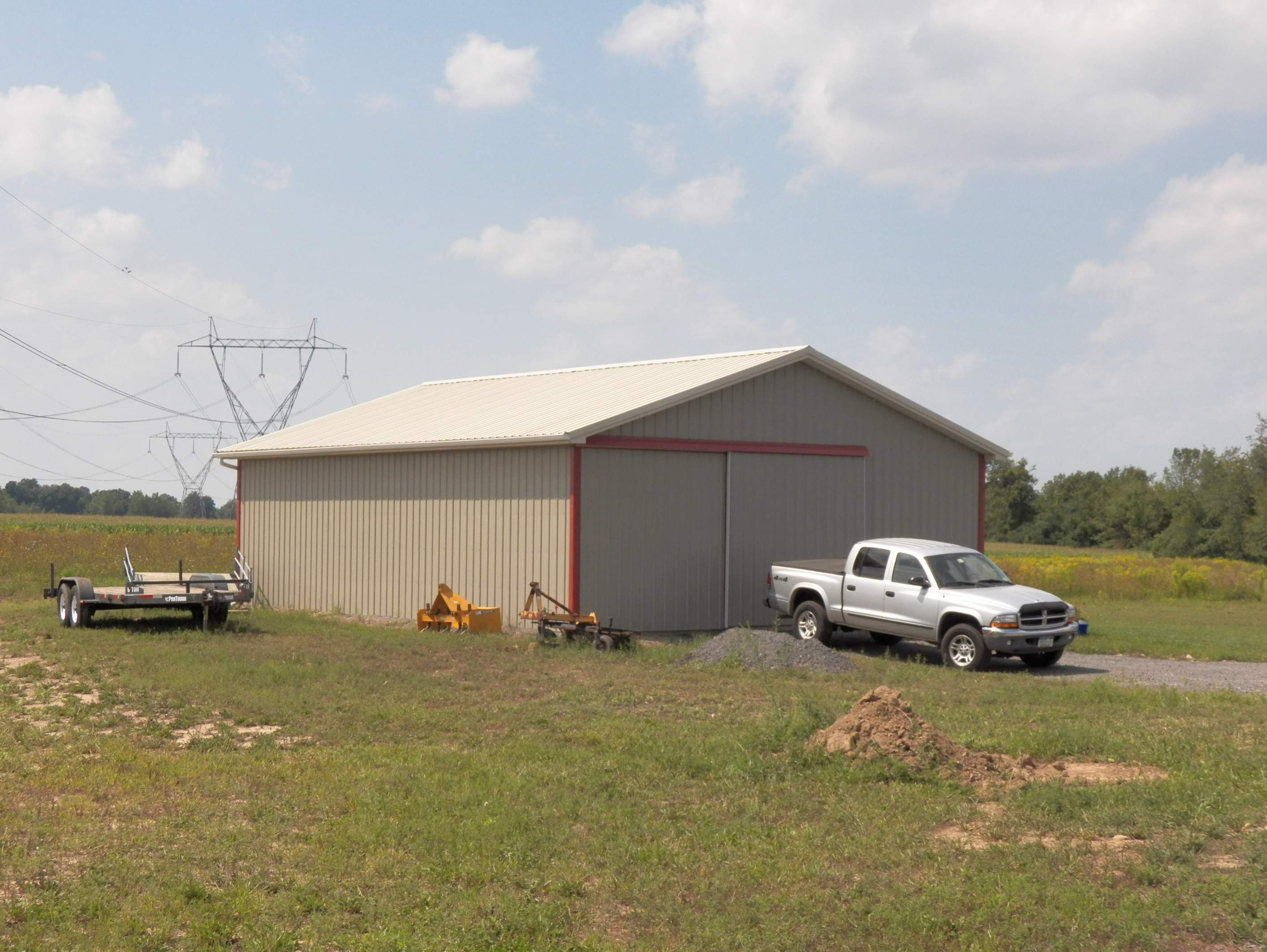

Here's my barn built by Santelli Lumber. We were in no hurry since the barn went up the same time the house was being built. The materials sat on the site for a couple weeks before they built it. This went up in 1 day. They drilled the post holes at 7am and had to wait until 10 for the inspector. When I drove in at 3pm they were just hanging the door and packing to leave. 4 guys and a Bobcat.
I leveled the site and added 6" of #3 & #4 stone with 2" of finer stuff on top. After it was finished I added another couple inches of crusher run inside and tamped it down. It's ok but I'd go concrete if I could afford it. I checked out 8 other builders in the area before I decided. Morton was by far the best...and most $$$. Since mine is mostly for storage I couldn't justify the frills, I'm not gonna live in it.
