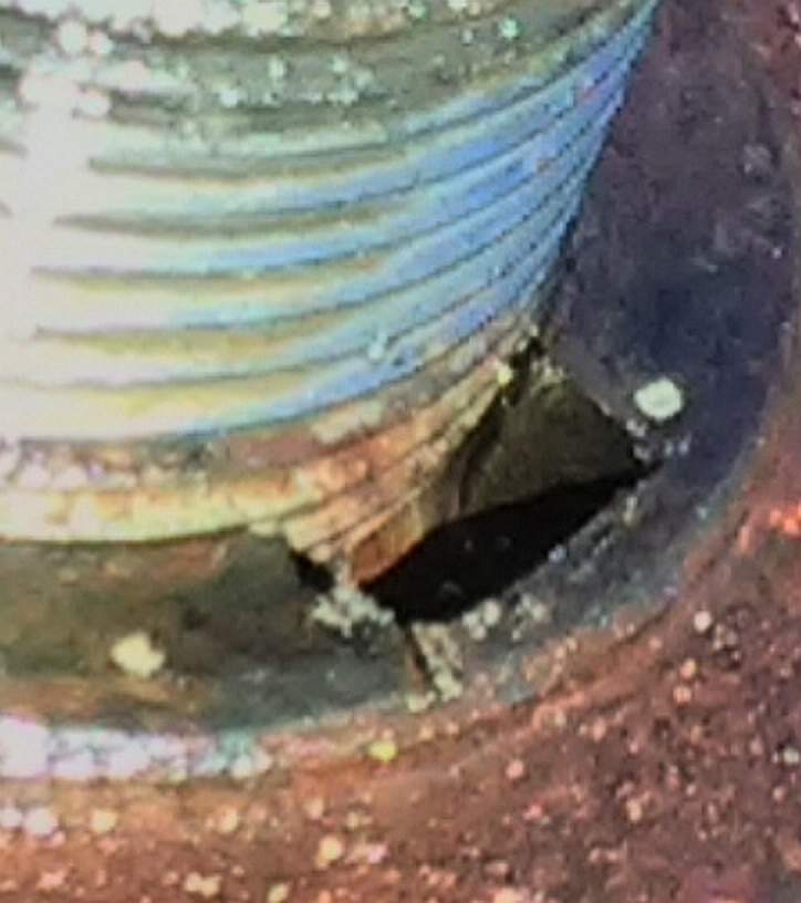

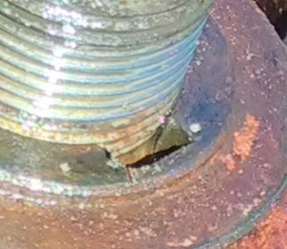

Well, it may not be that easy. I looked at them again today and it looks like they may be be threaded on, if that makes sense. I can see threads on the spindle shafts below the surface of the pulleys/sheaves, but I can't tell for sure if the pulleys/sheaves have threads or not. Thing is, it also looks like there's a key or pin of some kind. I'll try to get a better picture if I can get focused clear enough.

Dunno, whaddya think? Sure looks threaded to me:
I don't see a key either so far. I'll try and blow the oil out of there tomorrow and see if I can find out any more.

No, threads end about 1/4" below the boss. Do what I told you to do. You are over complicating it.

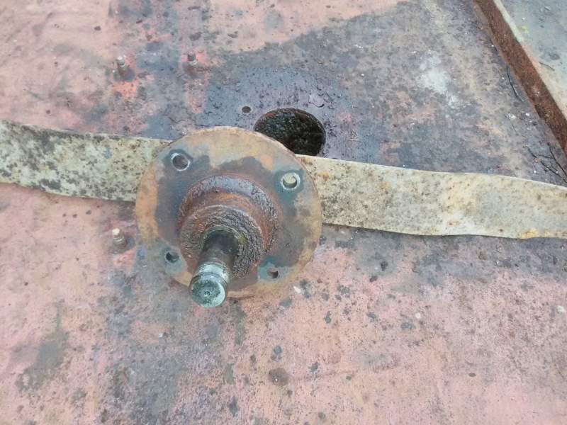

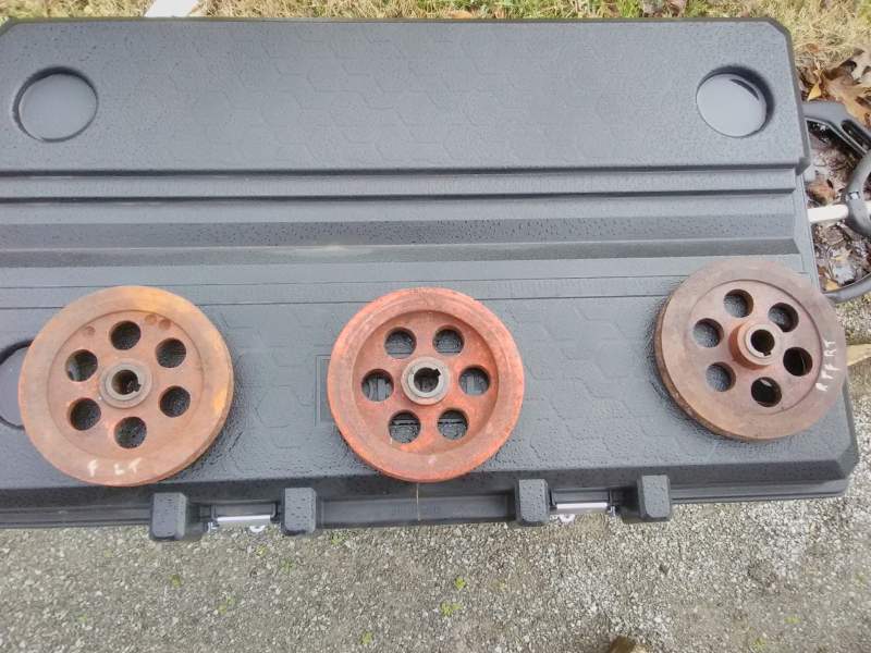

Pulleys are off. Got the 10 ton puller. Had a bit of trouble getting it adjusted to where it would pull as it's almost too big/tall. Destroyed one Grease Zirk before I found out I could use a deep well socket to take up the excess space and straddle the Zirks in the process. Tightened the puller up into place on the first one getting ready to go to the next (heat) step. One more pump to make sure it was secure and the pulley broke loose and came right off. Next two came off easy as well.
Drilled out the broken Zirk and replaced it.
Now I need to finish cleaning the deck surface off and find the weather to paint it. Need a spray gun for that ... don't want to rattle can it if I'm going to try to sell it.
View attachment 645092 View attachment 645093
See, my advice is usually good.....lol
That puller is **** on frozen brake rotors and drums too and the occasional harmonic balancer as well. One if my favorite labor saving tools. Probably should have told you about the socket trick though........... Only issue is, they are a bit cumbersome to work with. I 'borrow' my wife for an extra set of hands....:D
