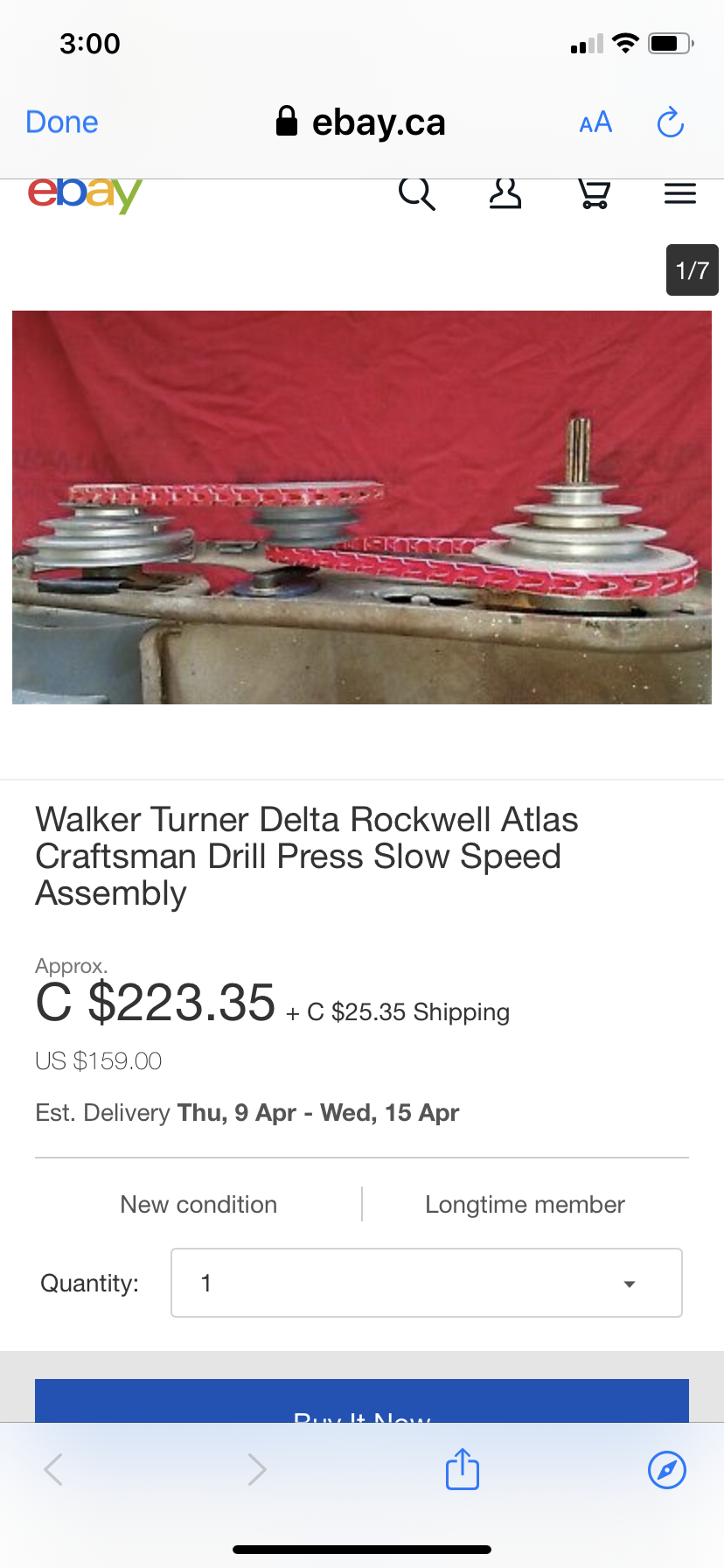

This is what Canadians would have to pay
Plus 12% for taxes.

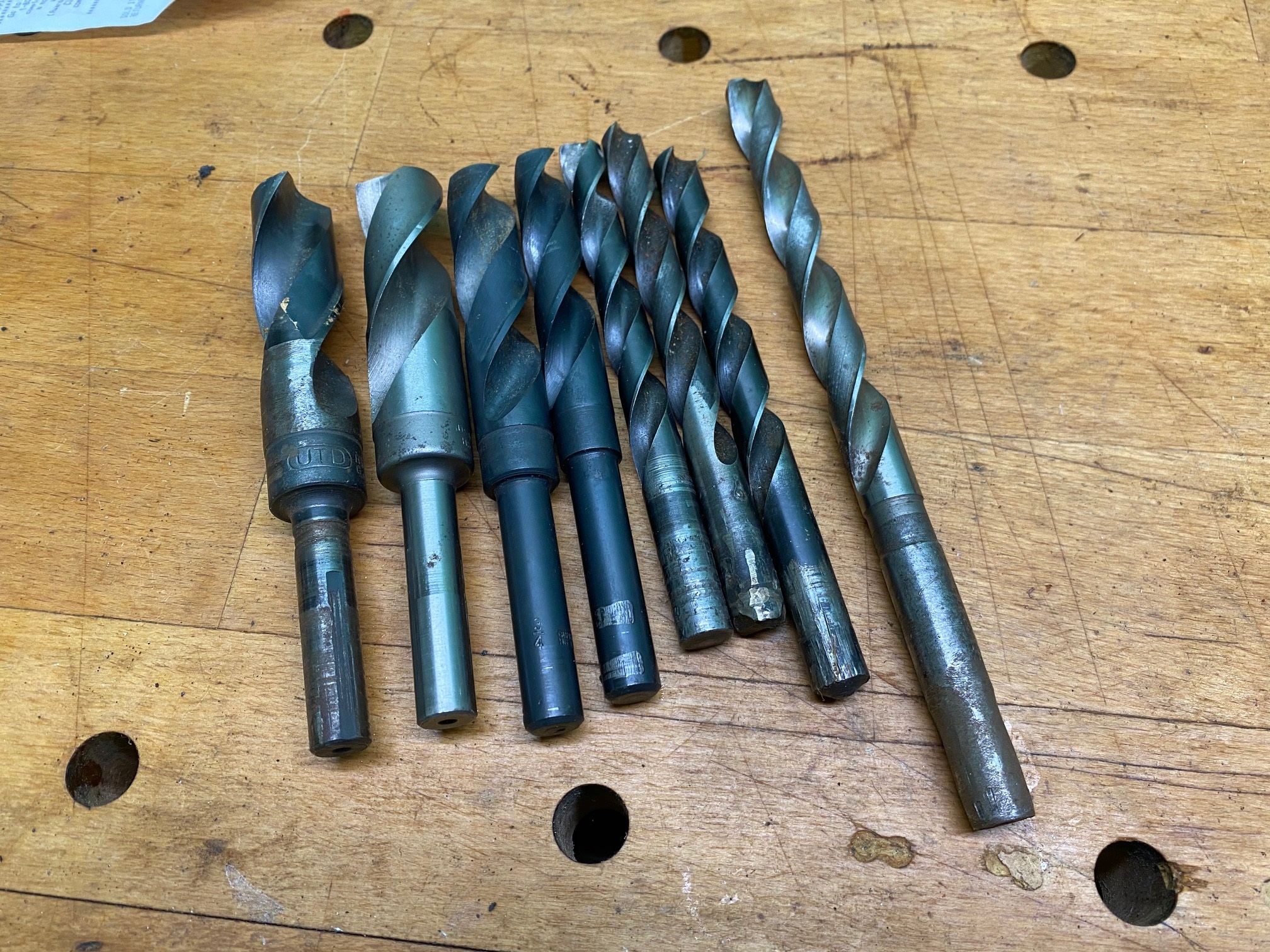

I have just bought big drill bits as I needed them. Here is my collection over 30 years. I use an old Atlas floor drill press. I replaced the Atlas with a larger pulley and a 1125 rpm motor to slow my drill press down. It is not an industrial floor press. Anything larger and I use a hole saw. How about just buying what you need rather than buy a large set?
Oh I worked for a gun smith in my young days and he always sharpened his drill bits free hand on the side of a bench grinder wheel. So that is what I try to do. He was much better at it than I am but I get the job done.

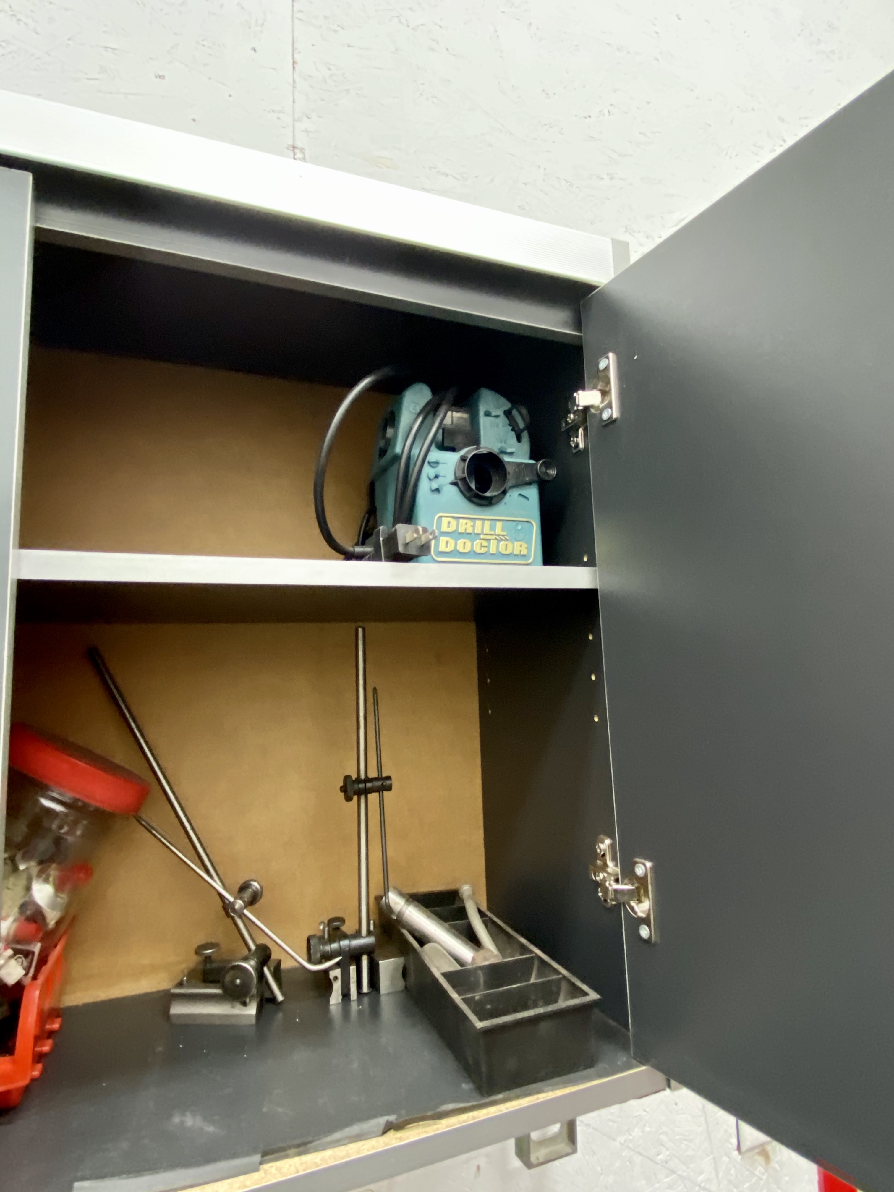

I learned how to sharpen drill bits in high school and I used to think I was pretty good at it. I suck at it today and in retrospect I most likely did back then too!!
I use my Drill Doctor once every year or so for accumulated dull bits over 3/16 inch. Anything smaller I throw out.
It always takes me ten minutes to refresh myself how the Drill Doc works then I just sharpen the bin of dull bits incrementally small to large.

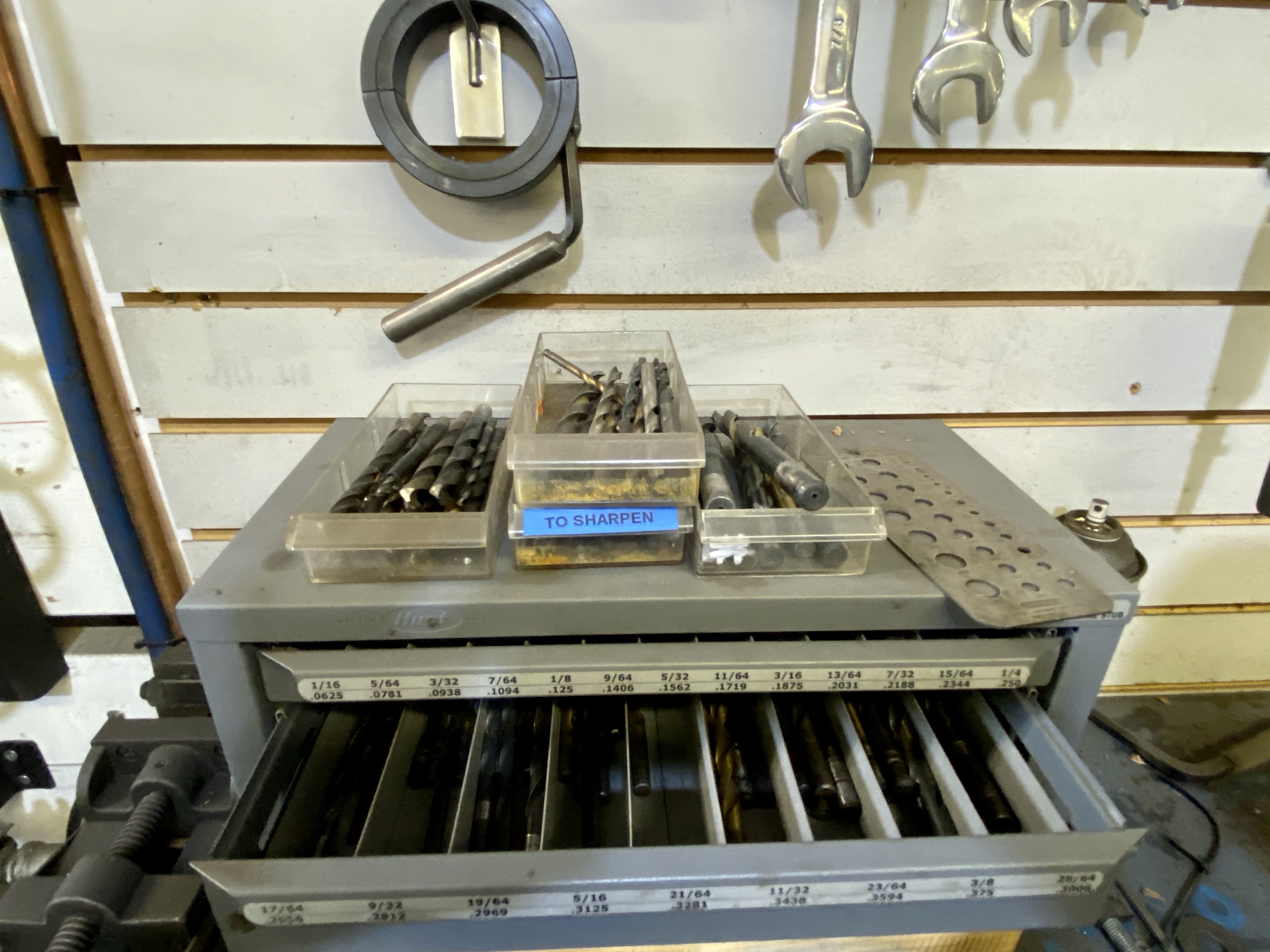

Hmmm. I seem to have overlooked the fact I have 4 bins of drill bits in need of sharpening.
The lonely Drill Doc
