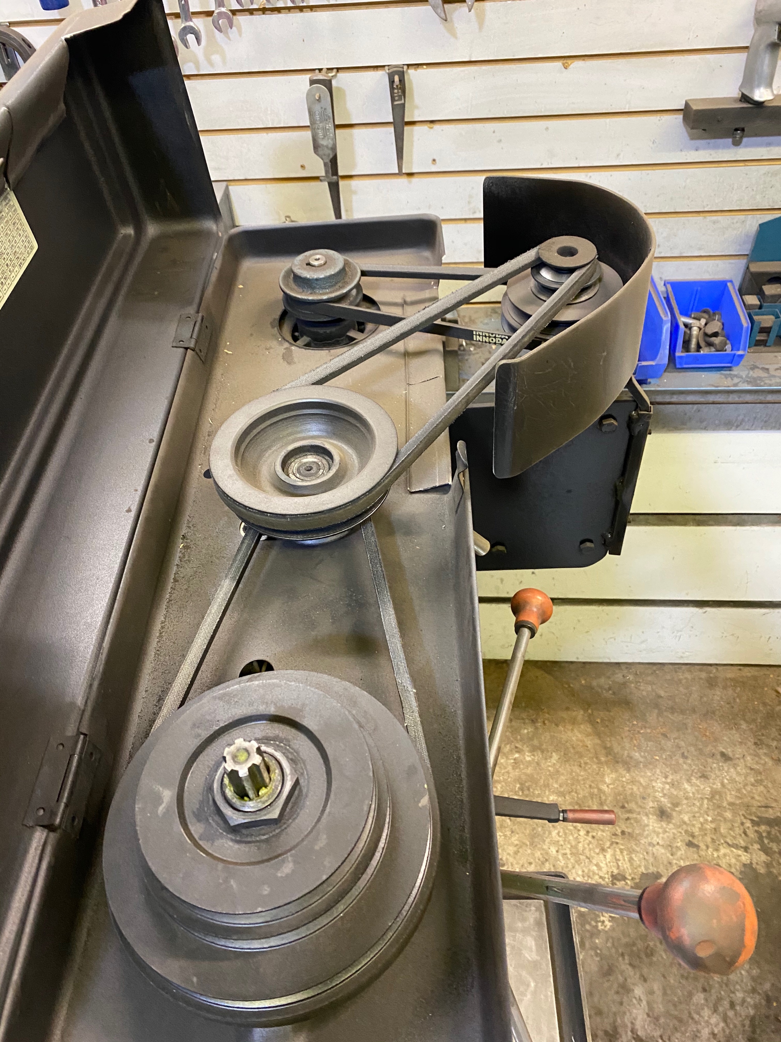

If necessary your DP RPMs could be reduced by adding a jackshaft assembly.
Love your jackshaft, BB.
I have the same setup (Weldon adapter, MT3, Champion annular cutters, etc.) with the same drill press. My DP came from HarborFright years ago, and it was the biggest belt driven unit out there. Still too fast at 180RPM IIRC. Way less money versus a sweet gear-head DP like SAWYER's.
Anyway, I have not slowed my DP down (yet), but I have a 2-speed washing machine motor that I scavenged just for that purpose. Did you consider a slower motor instead of a jackshaft?

Thanks Dave. I did consider a slower motor but only briefly. I did the jackshaft mostly because I used stuff on hand. I had pulleys belts and shaft but for some reason no pillow blocks the right size among my stash.

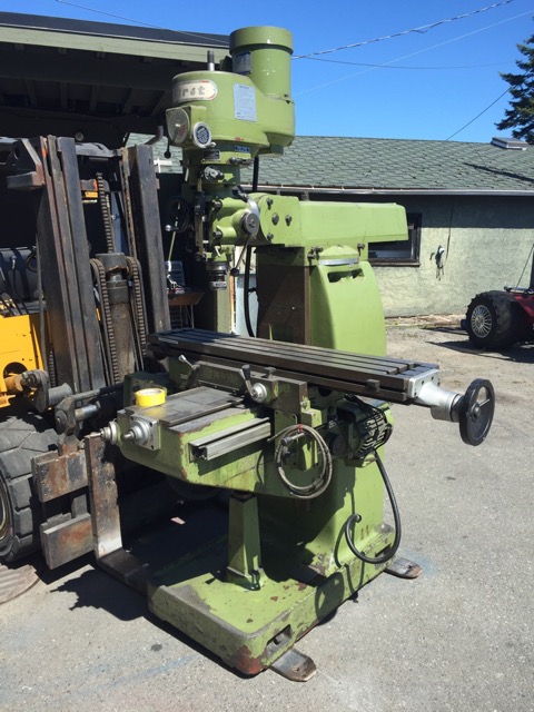

Since installing the jackshaft I ended up trading an electric bike for a Bridgeport clone.
Now any NON Mag drill annular cutter use is accomplished with this. Benefits are large table for clamping. Infinity variable speed and power feed.
