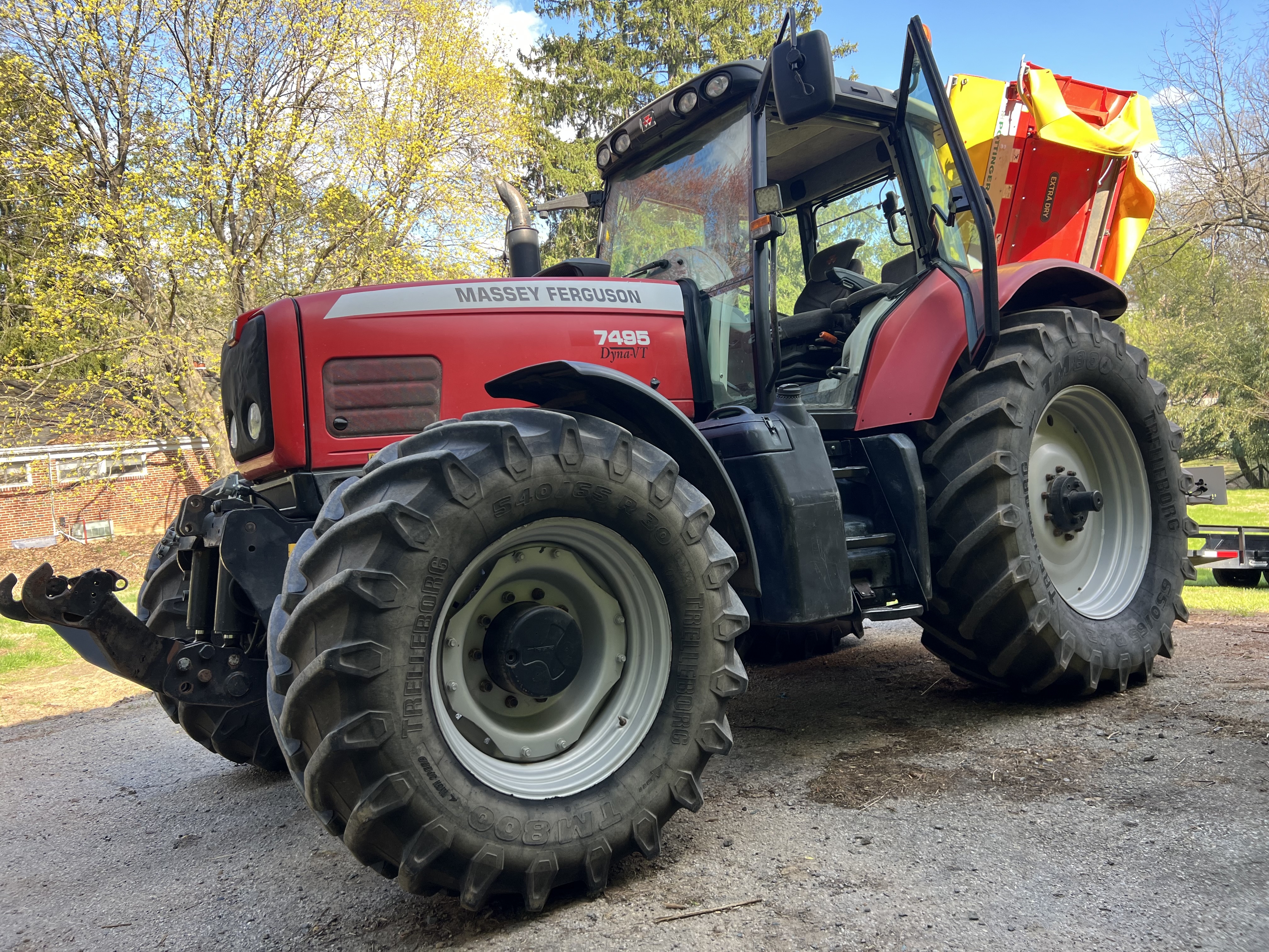

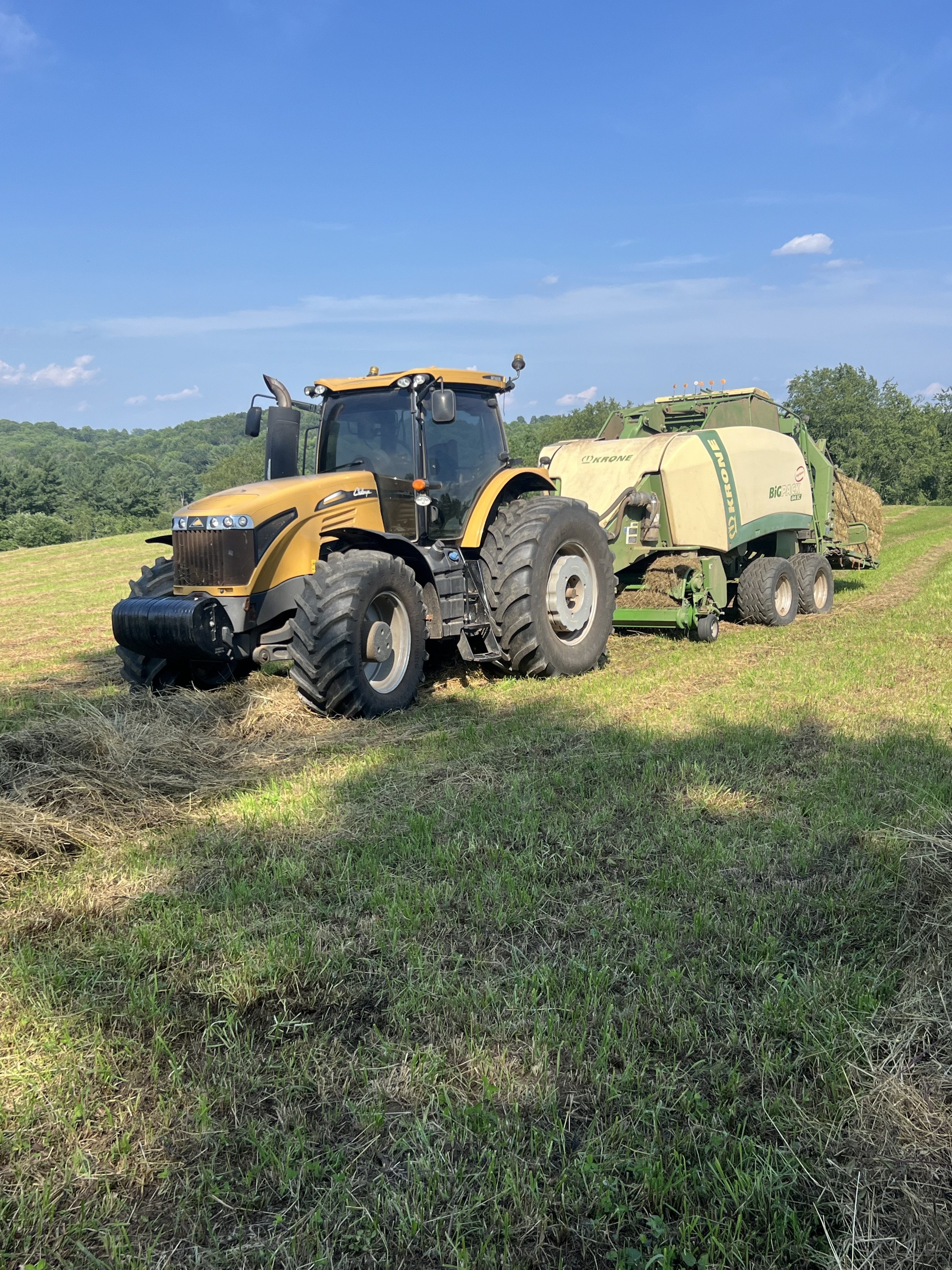

Firestone and Michelin are better R-1 Ag tires than Good-for-a-Years, IMO.
Heck I like Trelleborg and CEAT, too.
I have 2 tractors with (4) Trellborgs on each of them and really like em. Never a problem.
   / Recommendation for large, smooth sided R1 tires #13
Hay Dude; your Trellborgs have the bars/lugs closer together than Goodyear and many other brands.
That equates to more pulling power/rubber on the ground. My Goodyears have perhaps 6-7" between bars on the same side, that equates to better traction in muddy conditions; less traction/less rubber on the ground on firm to hard surfaces. At low speed on hard surfaces my Goodyears will shake your teeth out.
