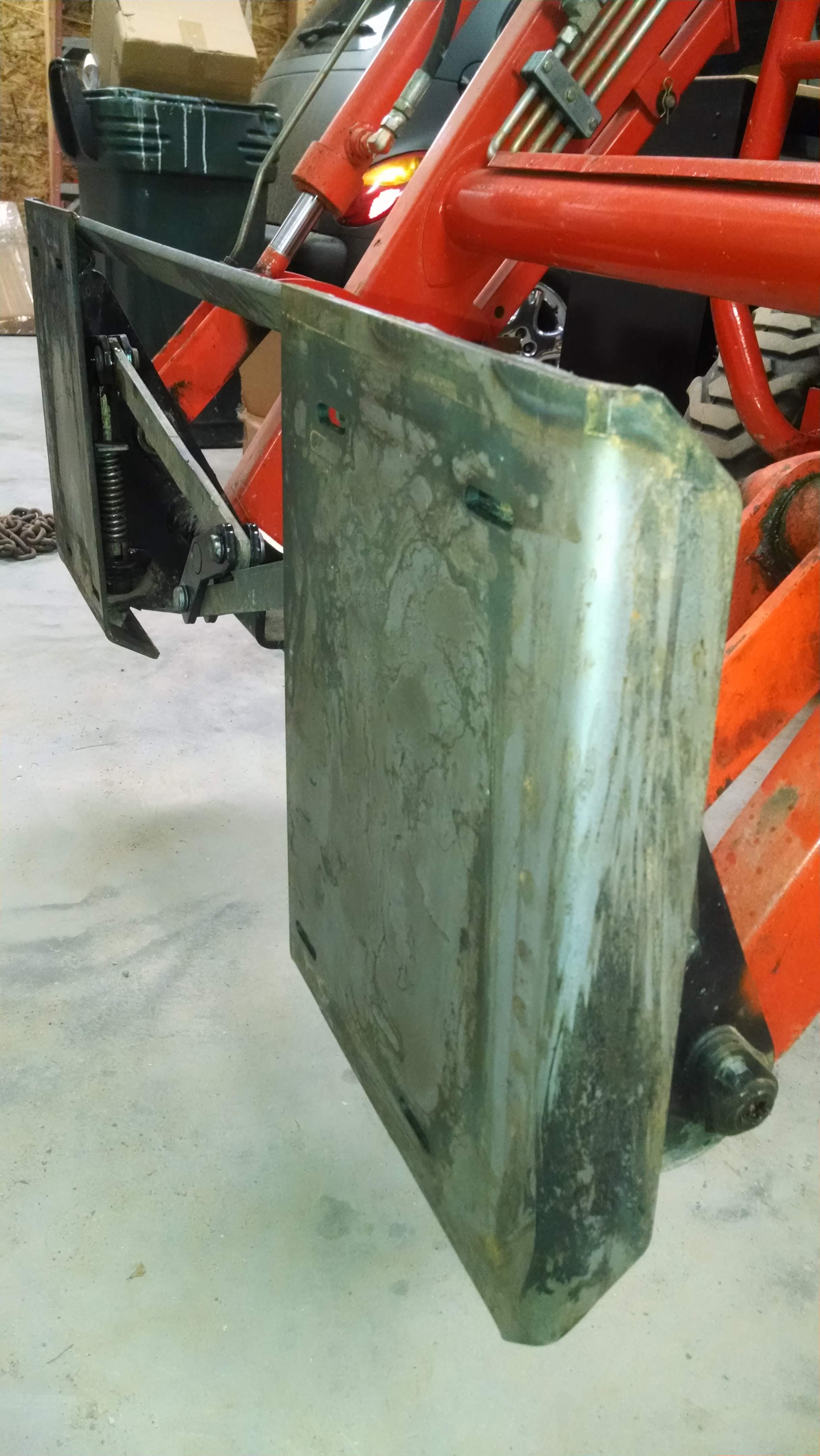

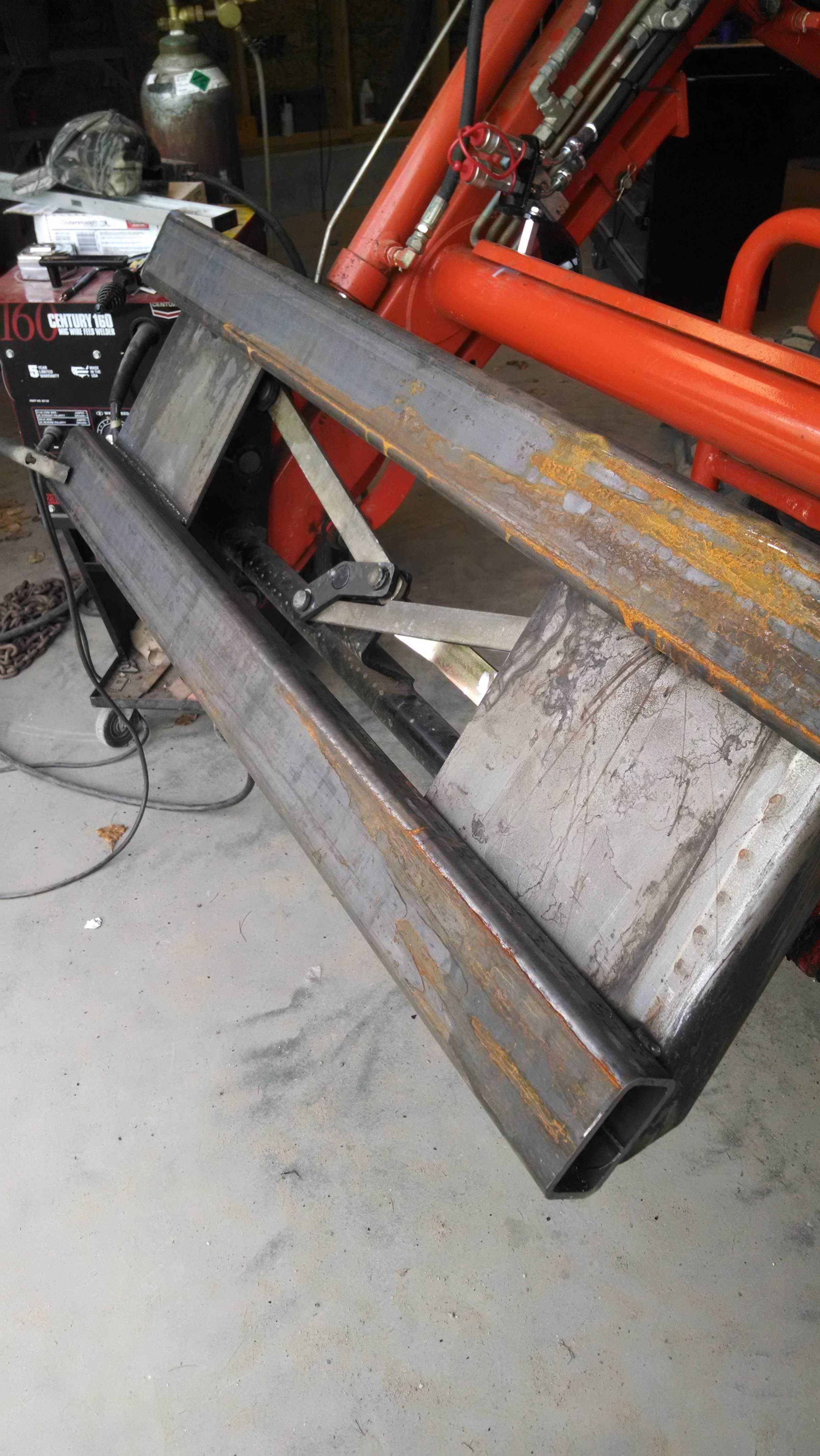

IMG_20141028_170222722.jpgIMG_20141011_134245351.jpgIMG_20141004_131258215.jpgWell I got my plow done just in time for 5-8 inches coming today. I ended up going the easy route because of time. I really wanted to replicate Rayclar's setup but that will have to be next year. If anyone sees any obvious problems with my setup please holler. Thanks for all the tips given. Yes I may end up shortening the plow. Will see how it does the first few times out.

Looks good, Maineiak....what type of valve is that on the plow?
Is that what they call a crossover valve, will the plow trip with that?
Sorry skyhook, I am just seeing this now. That is a crossover valve and does release pressure when I hit something real stiff. I have it set at it's default setting which I believe is 2000 PSI and will go to 3000. I got it on Ebay just search for "Prince Hydraulic Pressure Dual Crossover Relief Valve DRV-2HH 3000psi 3/4" NPT "

My WAG base machine 4000,+cab 300+ loader 600+plow 300+ counterweight in barrel 600 =5800
That's just about it but my barrel has 800 lbs and the tires are filled. I did weld a bar through the barrel in case I want to add some barbell weights to either side. But I believe what I have is perfect with this plow. I have been plowing through 5+ feet of snow 100' out in horse fields without issues. I have to do the normal lift up and over about half way out but I would still have to do that with the bucket as well. The plow is just much wider and quicker. I am still waiting for some wet snow though to get a true picture of what it will do. But in now way have I been abusing the tractor at all.
