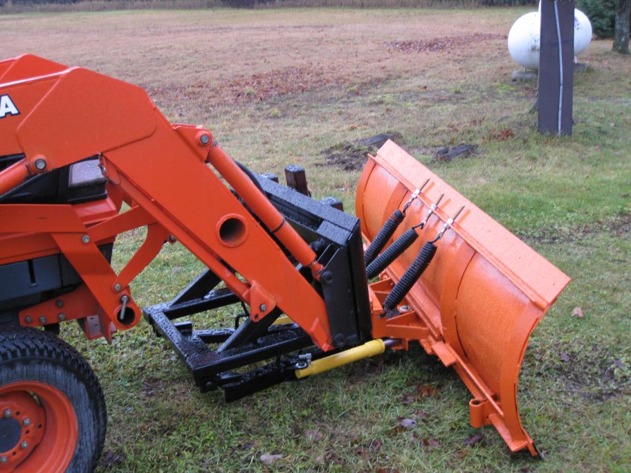

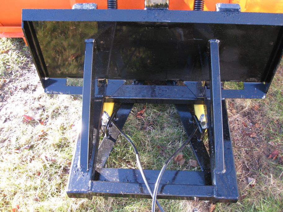

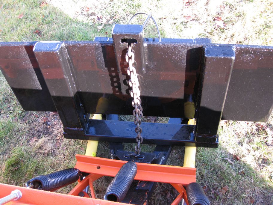

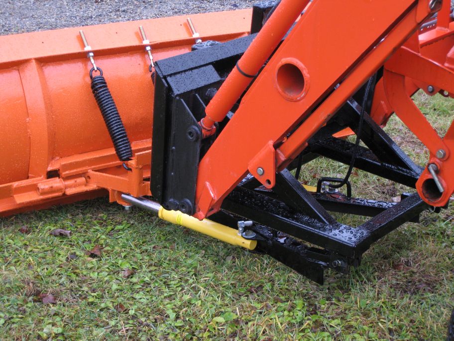

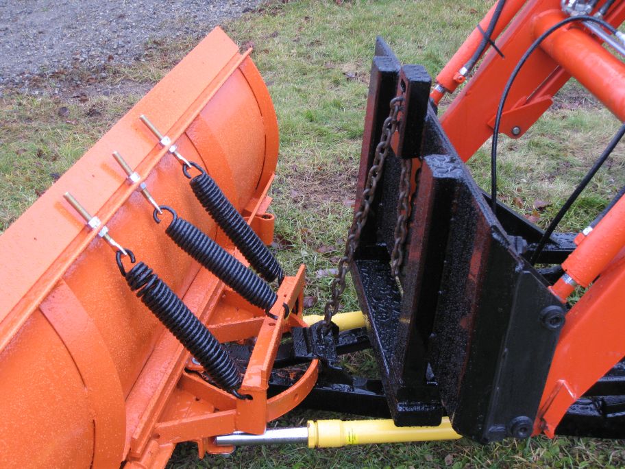

This is how i did mine. I use the chain for floating. Using the loader on float is no good, (too much weight). I use the rear remotes for the angle. The plow is 7.5 ft.
Very nice!! I like how you got the plow closer to the FEL. I would love to see a picture of the unit unattached. If you think of it next time you remove it that would be GREAT!

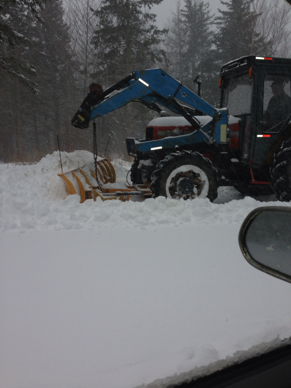

I push a 9ft fisher with 60hp and 4 ice chains, I have to agree with everyone that thinks its a bad idea.

9 foot is way too wide. Ok for light snow up to maybe 3" but as soon as you have a load up front it will push you sideways.
If you plan to use a plow angled 6 with maybe 7 would be max.
Even 8' on a 3/4 ton 4 x 4 GMC Diesel was often a problem, especially in wet snows, and that is considered the ideal plow.
I would not suggest more than 6' on your tractor.
With a truck we plow fast and curl the snow off to the sides.It flies. With a tractor speed is really not an option as suspensions are just not there. You'd be asking for trouble.
Now big and wide straight push with big side ears (no angling) like in clearing big parking lots would be a different matter.
Your nine footer would be handy but you would need to add lots of weight for traction.

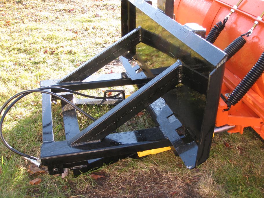

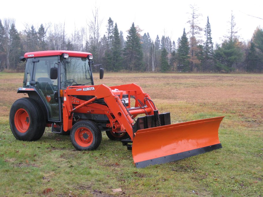

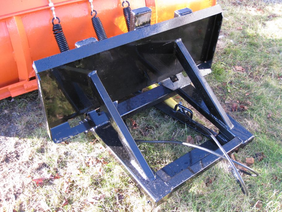

maineiak, here are some pics.
That's a nice tight set-up ,gets the plow closer to the tractor.I think the guys that float the FEL are plowing mostly paved drives/roads where you want a lot of down pressure.If doing dirt/gravel the Plow Float seems to work better.

Nice setup Rayclar. The way you have it you get to float with the chain but I see you can also make some down pressure if you want can't you? That's best of both worlds. I will probably mimic your setup for sure!! Thanks for sharing!
