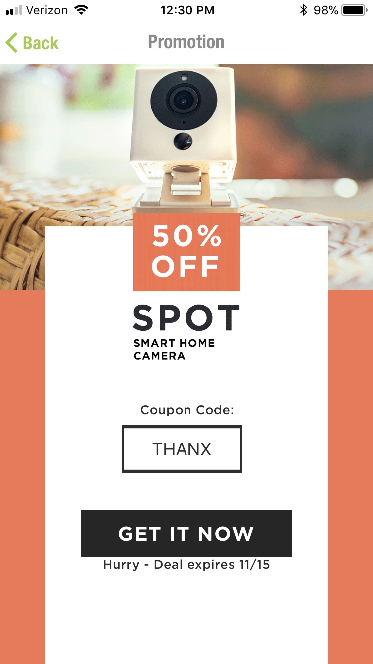

/ Recommendations wanted for a basic network camera #8
If all you need is a fixed camera this should do. I have the pan/tilt unit.
